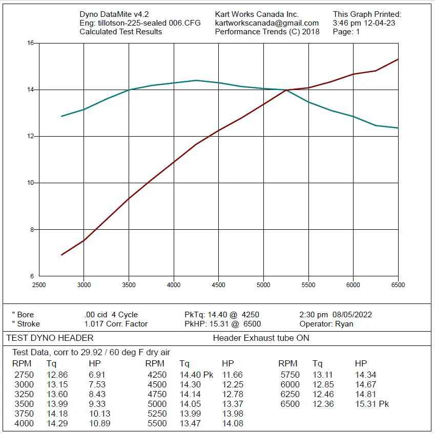

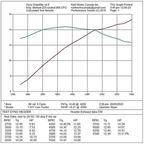

It has a rev limiter and you want to ride the limiter on the straight, just like a 206, you are more tuning for the low RPM to maximum the torque coming out a slow corner.
here is the power curve

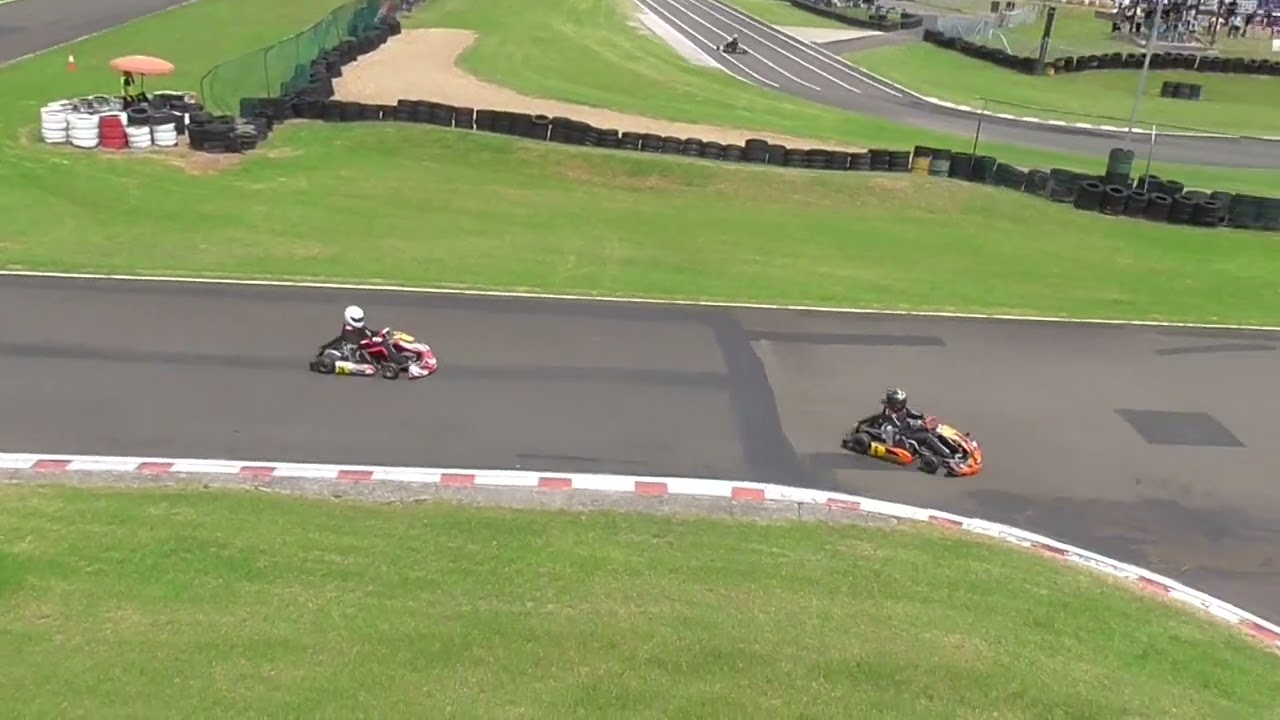

Just if you’re interested. This is a TAG restricted and Tillotson class run together from last weekend.
Mix of full T4 and 225 engines on ‘bring your own’ chassis.
This announcer needs another Red Bull I think. :laughing: What energy!
Based on where the karts are crossing and the gap between the TaGs and the 225, the Tillotson looks to be about a second slower than the restricted TaG at “heavy” weight.
