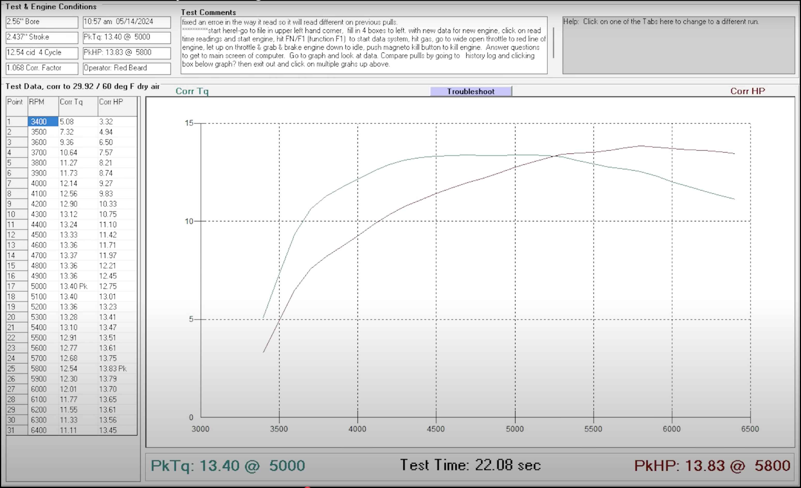

Here are three dyno runs from Red Beard’s Garage. His dyno is about 10% higher than ours, but it reads very close to other engines’ advertised numbers, which provides good context for comparing the different Honda-Clone engines. He’s dyno-tested many stock and modified engines.

Tillotson Engine Testing:
Gen 1 Short Pipe/6500rpm – 13.4ft-lb @ 5000rpms 13.82hp @5800rpms
Gen 1 Long Pipe/6500rpm – 13.47ft-lb @ 5000rpms 14.39hp @6400rpms
Gen 2 Long Pipe/7500rpm – 13.75ft-lb @ 5000rpms 14.21hp @6600rpms
What the Gen 2 gained in ft-lbs, it lost in hp. We believe the increase in compression helped torque but hurt HP. In our opinion, the head shouldn’t have changed because the cam and ignition timing should be redesigned to optimize the combination. Since the Gen 2 is a decked version of the Gen 1 head, it may allow blueprinters to find how much a Gen 1 can be decked to increase torque without losing the top end.
