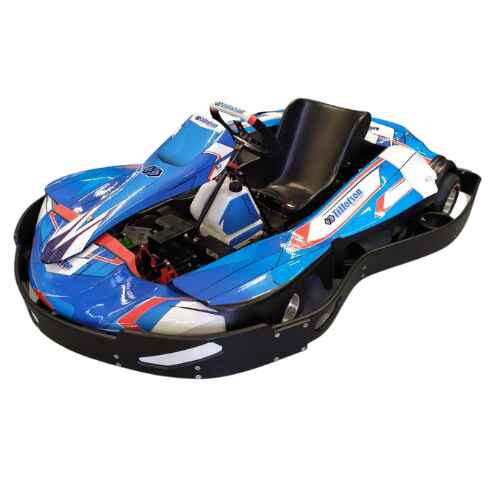

Technical Specifications
Weight – 119 kg (with engine)
Frame – Ø32 mm + Ø28 mm
Brake system – Hydraulic, Ø195 ventilated disc
Brake position – Rear
Axle – Ø40x3x900 mm
Bodyworks & Protection – Full covered with dual impact absorption system
Steering wheel – Ø300 mm
Tank capacity – 8,5 l
Wheels – Aluminium FR. 130 mm – RR. 210 mm
Seat – Adjustable system
Pedal – Adjustable system
Spindles – Ø17 mm reinforced
Engine Specifications
Type – Single cylinder 4-stroke, air cooling, OHV
Max. Horsepower – 9HP@ 5,500rpm
Max. Torque – 12 lb-ft (16.2 Nm) @ 3,500 rpm
Cylinder Head – Tillotson Racing
Fuel System – Tillotson FM19-1A – Float Bowl Carburettor
Clutch – Noram GB-7522 Wet Clutch
Weight – 15kg dry/ less clutch

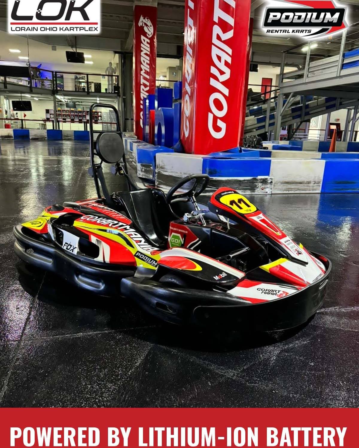

Yep thats what he will be starting in at LOK in gas !!! And there electric program with Podium Fox Karts. Since he is running GP league and Endurance League at K1 Speed Canton Ohio. He has a youtube channel called K1 Racer too of all his races there.
