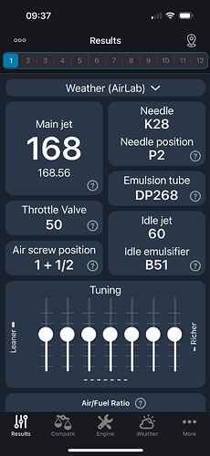

Now the Confusing Part! Jetting my engine so that I can control how much fuel and air makes its way to the engine.
I know there is an entire forum on jetting but if someone could confirm a few things here that would be great!
  1. The goal of jetting is to better my engine performance and protect the engine through optimization by the condition on of the day.
  2. I can do this through the TM KZ Setup APP (My preferred method. Anyone else have experience with this?). It takes my weather data and tells me what Main Jett, Needle Position, Emulsion tube, Idle Jett, and idle emulsifier to use. Done. Attached is an example. Does this sound about right? Again, this is just at the club level for me, but I want to make sure nothing happens to the engine and it’s in top shape
    - This is what the reccomendation is for 19C with 70% Humidity.

Regarding jetting, there is a lot of good info already floating around on the forums. What fuel and oil are you using? This is the first factor which dictates how aggressive you can go with jetting, followed by other tuning tools like ignition advance and squish/ccv. The jetting apps typically lean a bit to the rich side, which is just fine. These engines will run without issue even when quite rich. For the sake of longevity, you’re better off staying a bit rich, as opposed to going lean trying to chase an extra 0.5mph.
The header and exhaust pipe are the most dependable places to “read” the jetting, aiming for a milk chocolate coloration on those. Darker and wetter is too rich. Anything khaki colored or lighter is venturing into too lean. We also utilize an EGT sensor to achieve a target number that has been identified for best performance. Talk to your engine builder about this, as it will also depend on your fuel, as well as your track (long vs. short), and how the engine is set up.

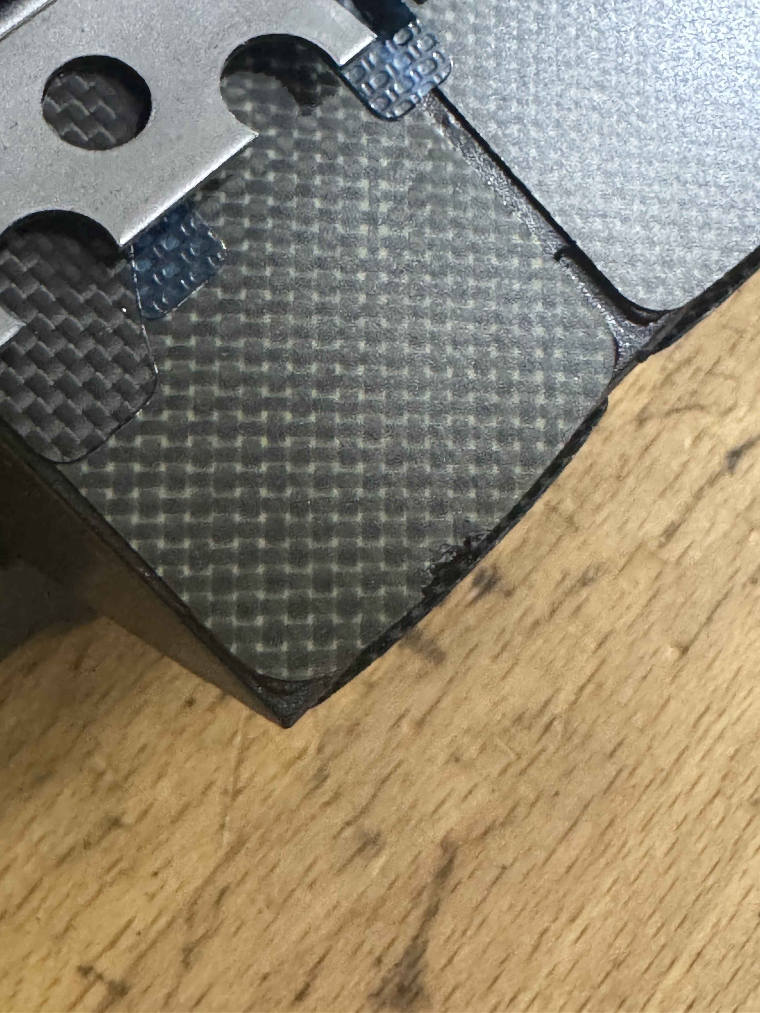

Glad I’m checking after every session. Maybe 3 hours on a new set of reeds. Kinda lame they are already chipped. I’ve been so gentle on down shifts.
Do I replace the whole reed set again? Plastic shims, carbon backers, and main reeds. Felt overkill replacing everything last time.
Do they have to be carbon fibre?
There’s only carbon fibre in KZ and OK classes as far as I know
Too soon?
Just replace the damaged reed. At a glance that looks like an aftermarket reed, which in some cases won’t hold up as well as the OEM reed. Also, minor detail but rearrange the set so the blue stiffener is outside of the carbon half moon. Typically the bottom side will have two half moons plus a blue one. Standard reed is 0.33mm, and I would avoid going thinner than that.
Weird that should be OEM parts and I just matched the stack up of parts from when I bought it. Good to know I’ll swap it back.
I only had the single carbon backer on the bottom. Weird to be asymmetric to me but I’ll make it match OEM.
My experience with TM, LKE and now Iame is exactly that. OEM reeds perform the best and last the longest. I’m not saying there is no better alternative, but I still have to find it
Maybe someone grabbed the wrong parts when shipping to me, but these should have been OEM TM reeds. Ordered a new set last night.

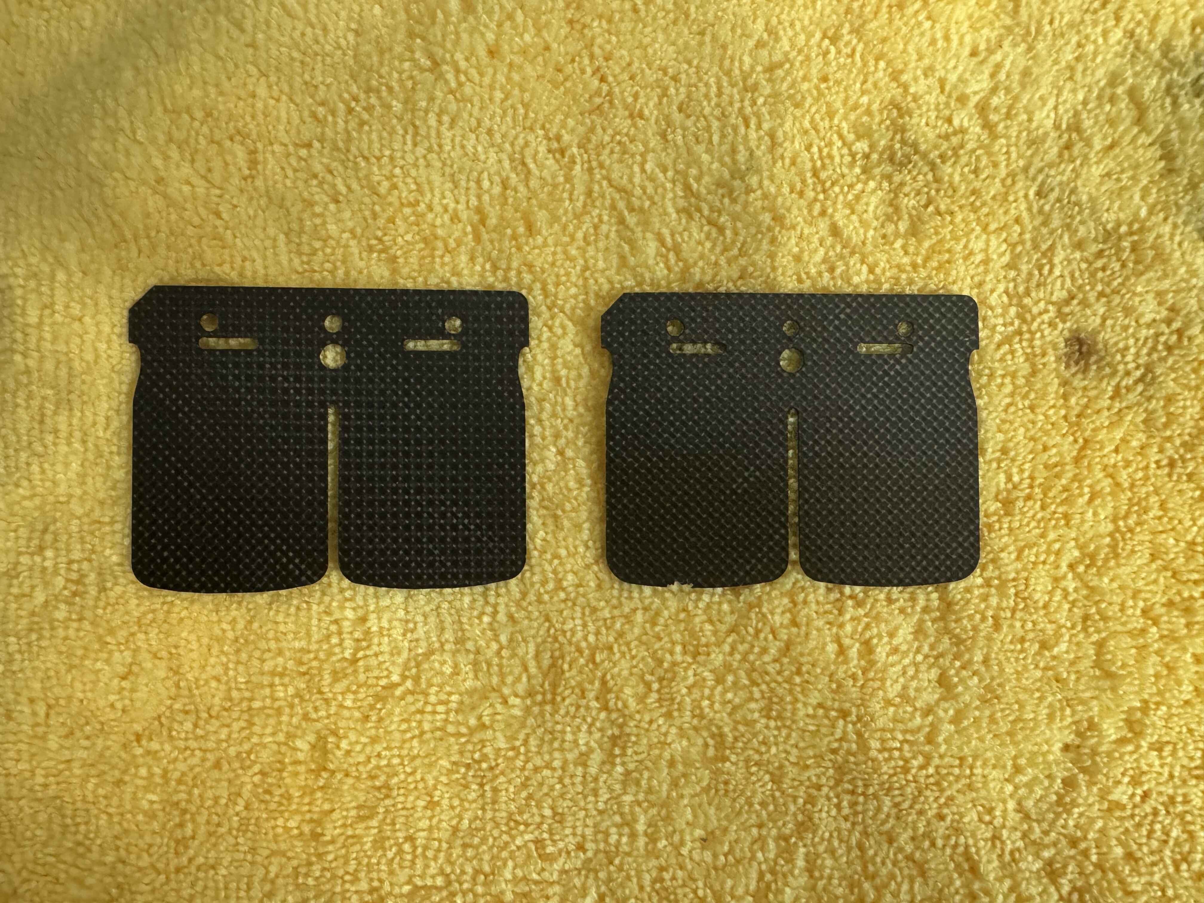

Can any KZ nerds identify these reeds then?
They look like mondo kart reeds.
