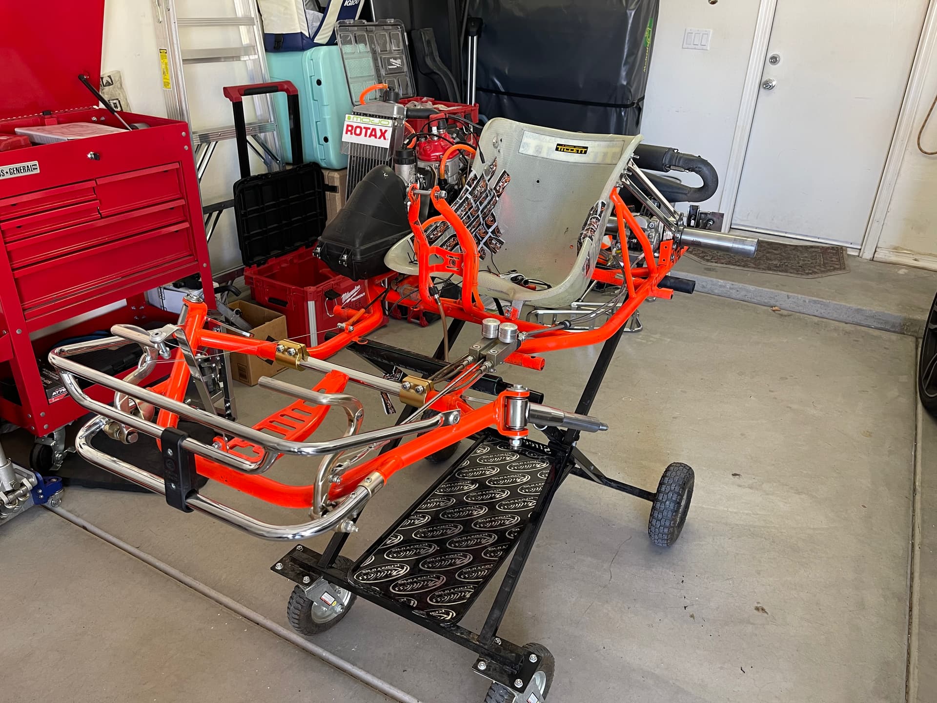

I’m gutting my kart down to the frame to give it a mid-season complete cleaning. Mother nature forced my hand after rain and hail race in Colorado. Anyone purchased a small ultrasonic cleaner they like? What are you using for cleaning solution. Just needs to be big enough to drop cassette in, hardware, etc. I have my small parts washer, but I’m trying to get away from using solvents to clean everything.
Excuse the mess I still haven’t setup my new shop after the move.
