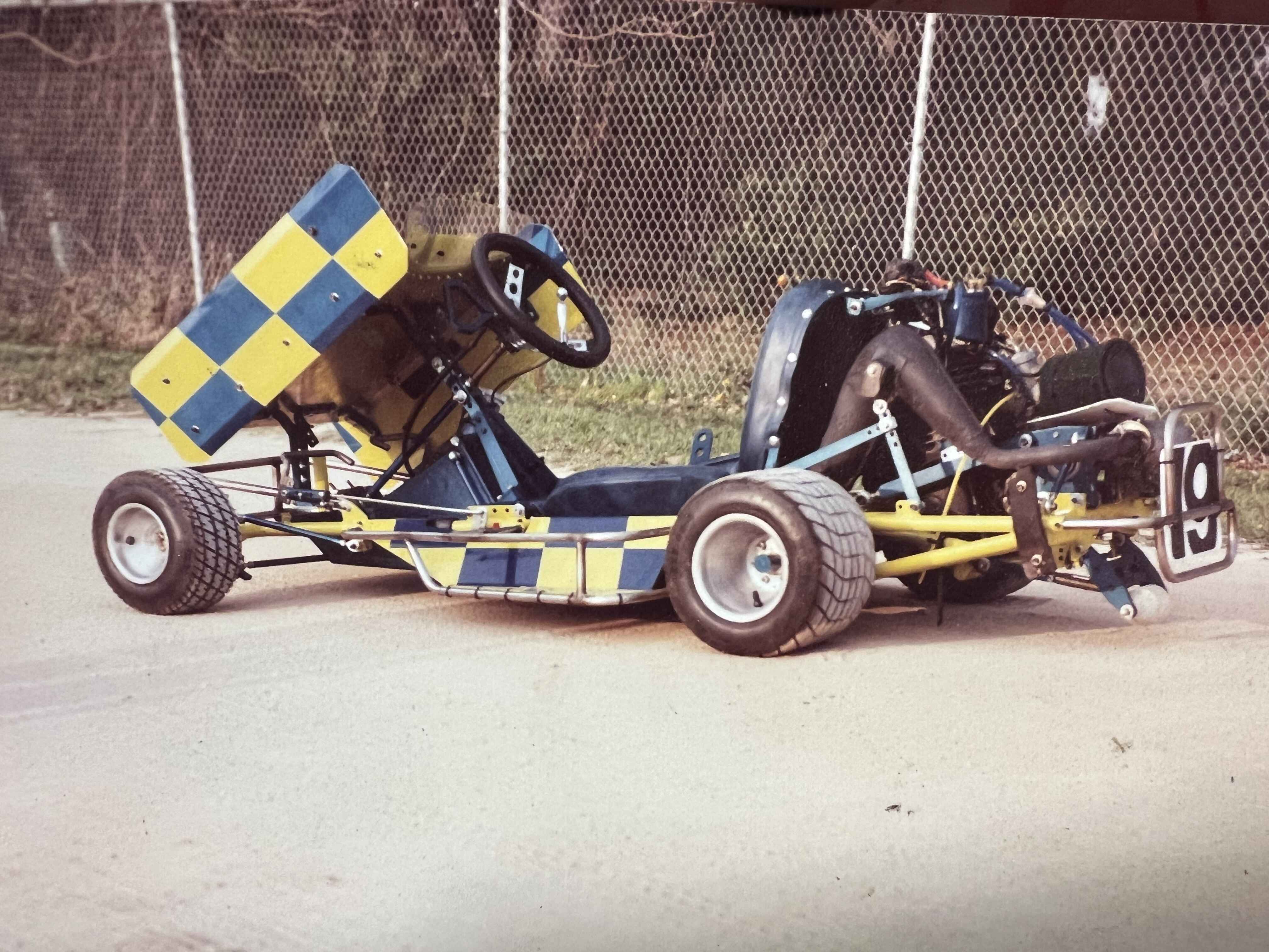

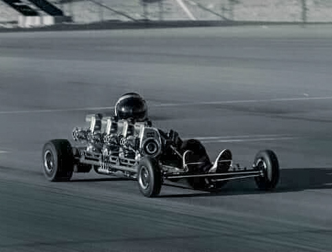

Some older creations
Ina straight line I think Capt Jack McClures rocket kart is about as fast as you can get.

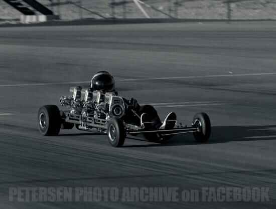

There is a fellow here who was building the meanest looking kart ever. Not vintage but nutty. Lemme find it.
That’s crazy. 4 engines in-line. Turning must be unusual.

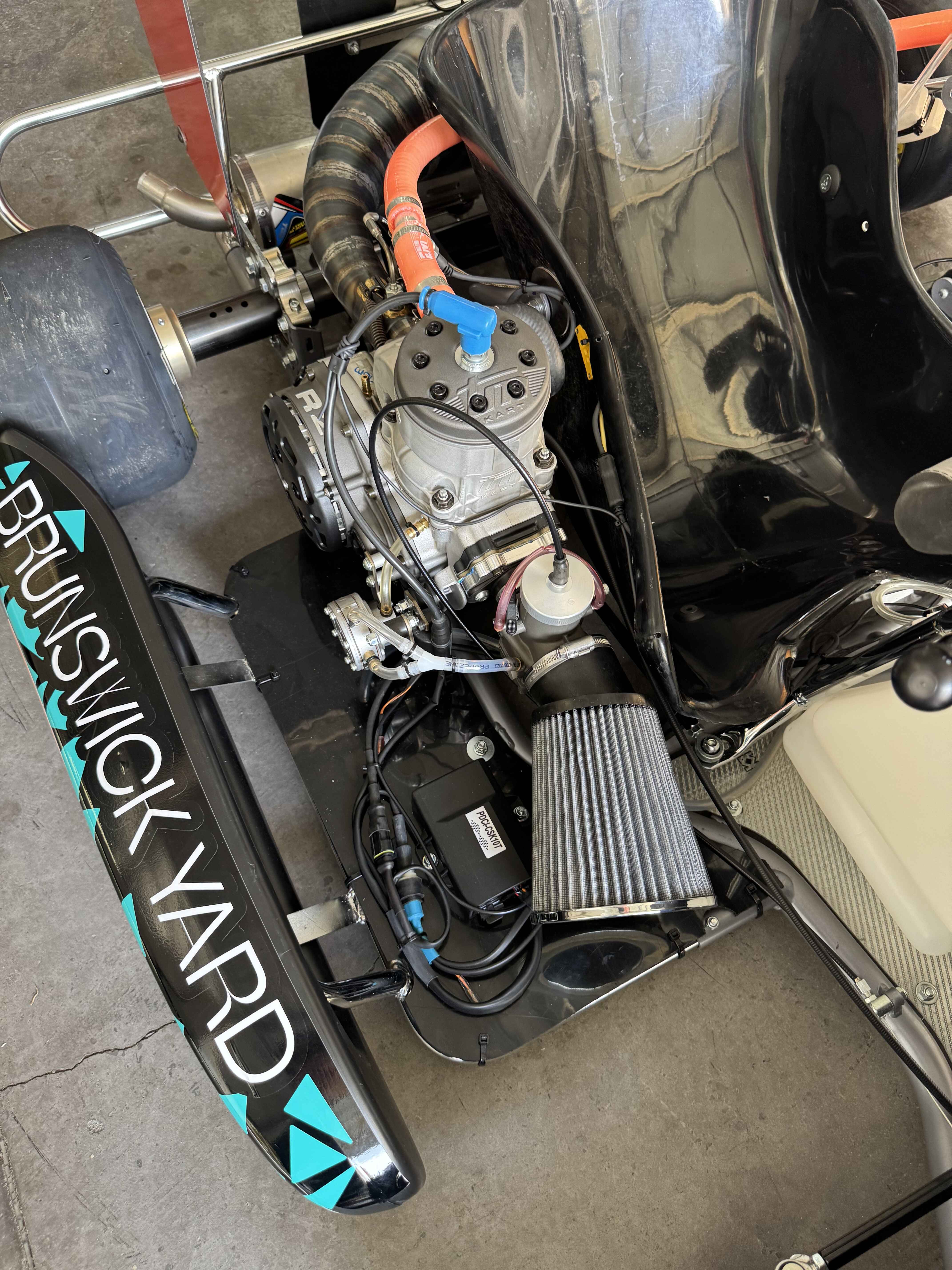

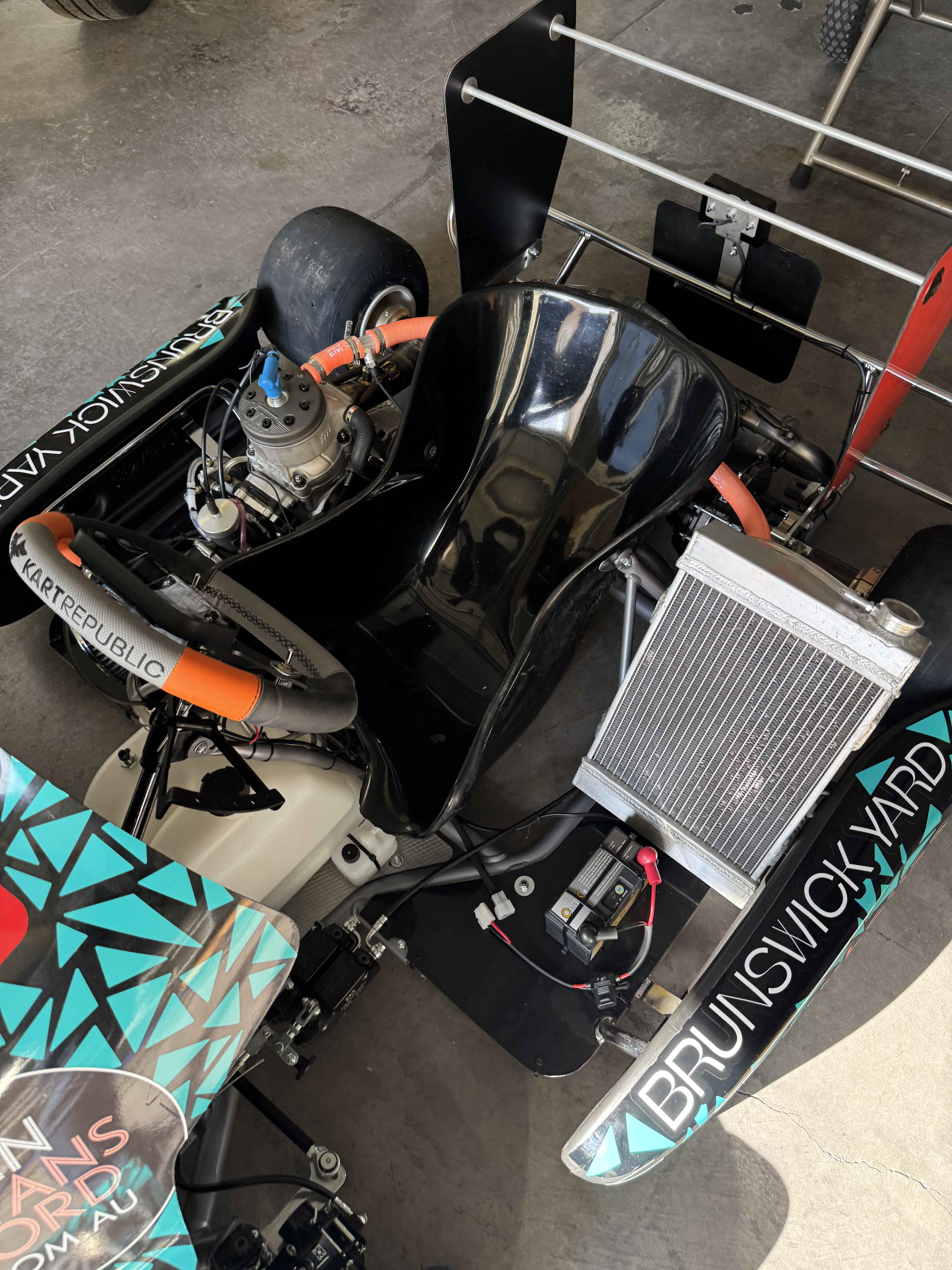

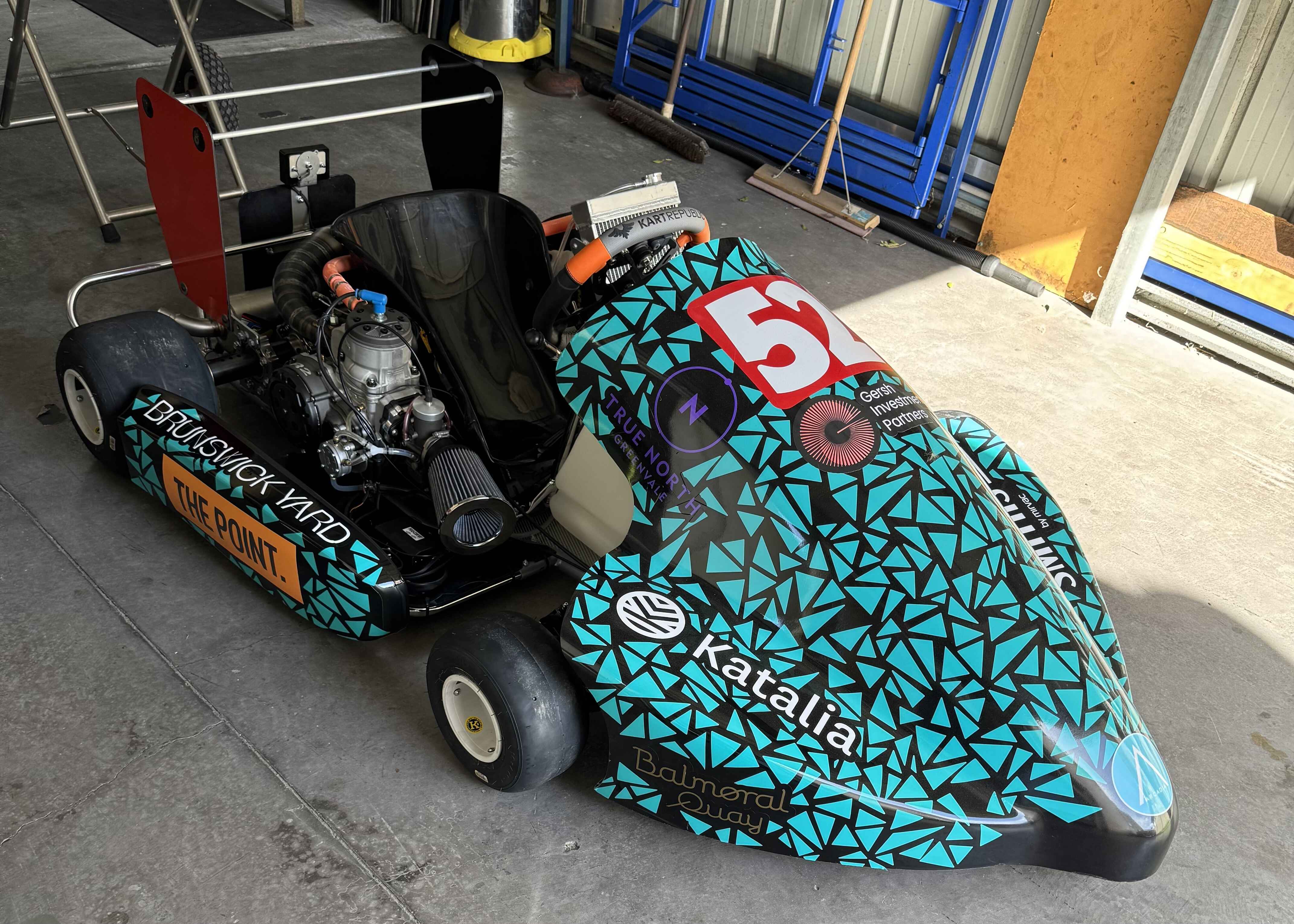

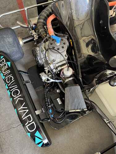

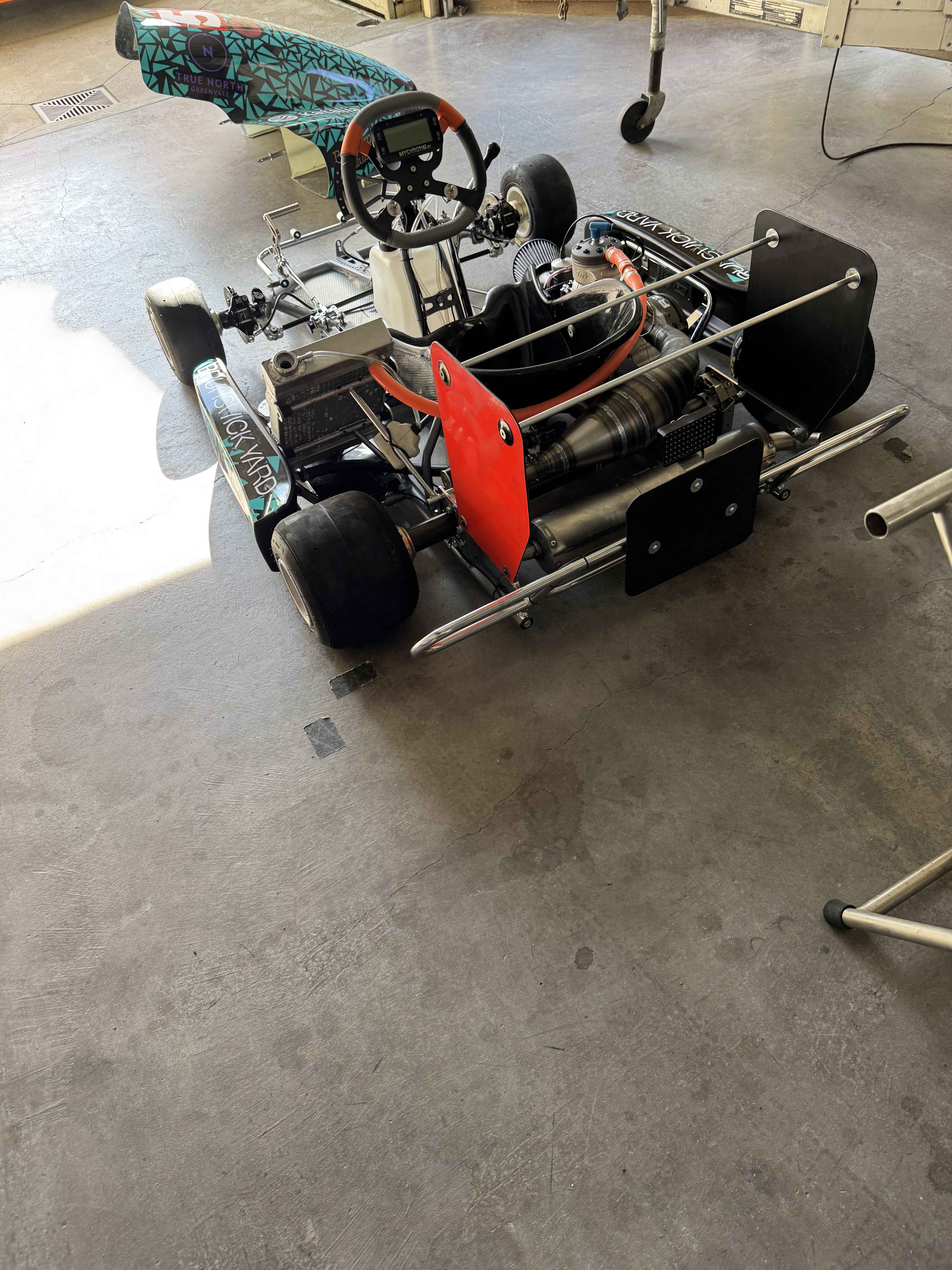

My latest build getting closer. Taken way too long and the seat fitting has been problematic given the lower orientation of the fitted seat and my height at 186 cm (different clutch handle required and some alteration to the steering to create leg room). Due to have its first run on 4 May at Broadford on which I’ll post separately. Rather hoping I don’t blow it up at the first meet, but them the risks.
I’m just using a standard KR KZ chassis, but otherwise lots of Superkart bits. Open 125 is the class, so a new TM R2 with an Anderson digital ignition (BIG spark) and separate power supply, 39 mm Dellorto and running a 220 main jet (so lots of fuel). The intake manifold is a special CNC and the boot I believe comes from a standard 250 twin. My builder did look at changing the primary drive but didn’t quite work, so sticking with standard gearing. I believe the sprockets will be 21 front and 21 rear. Top speed at say Phillip Island into T1 should be over 190 km/h (118 mph), some say closer to 200 km/h, but we’ll see. My Stock Honda peaked at 180 km/h. Will be puckering for me and above my pay grade since I’m not meant to lift.

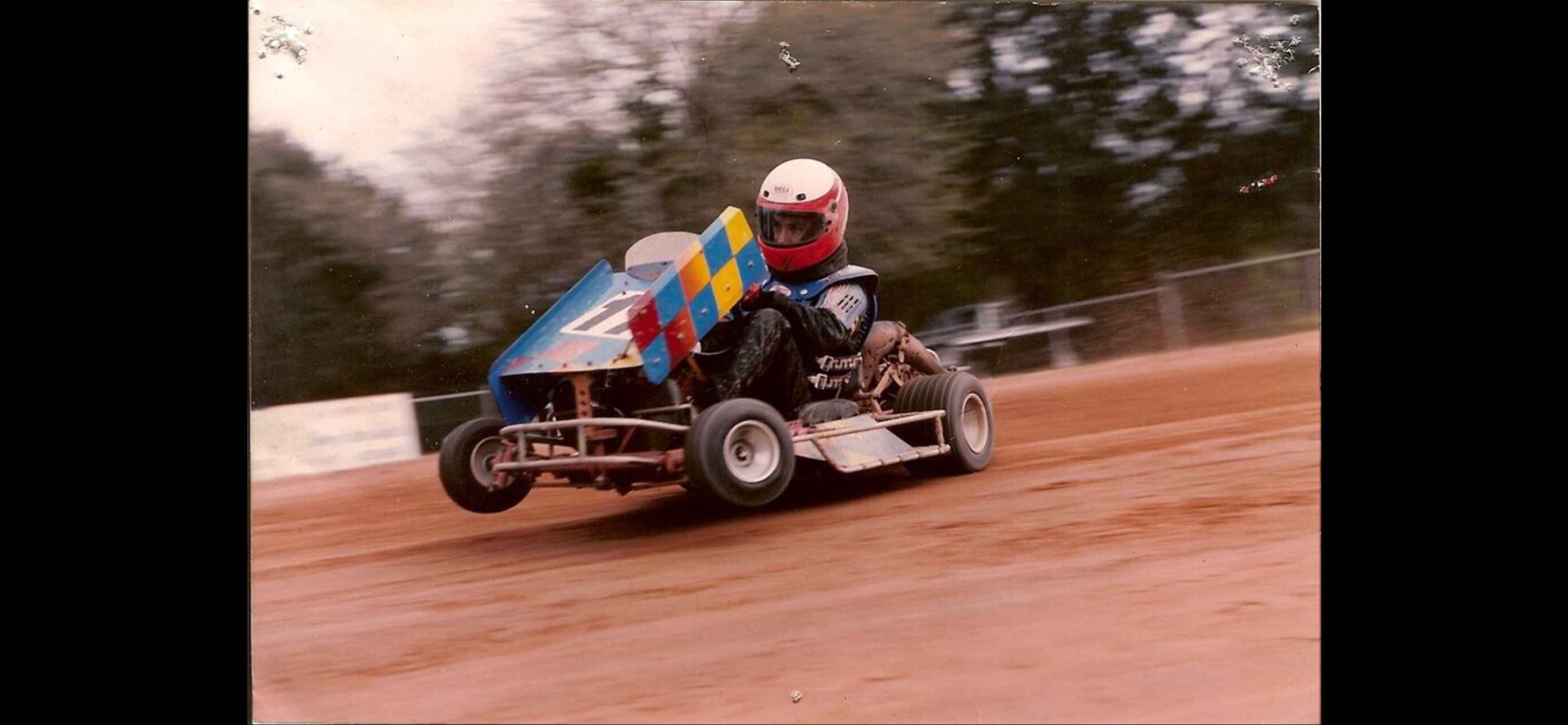

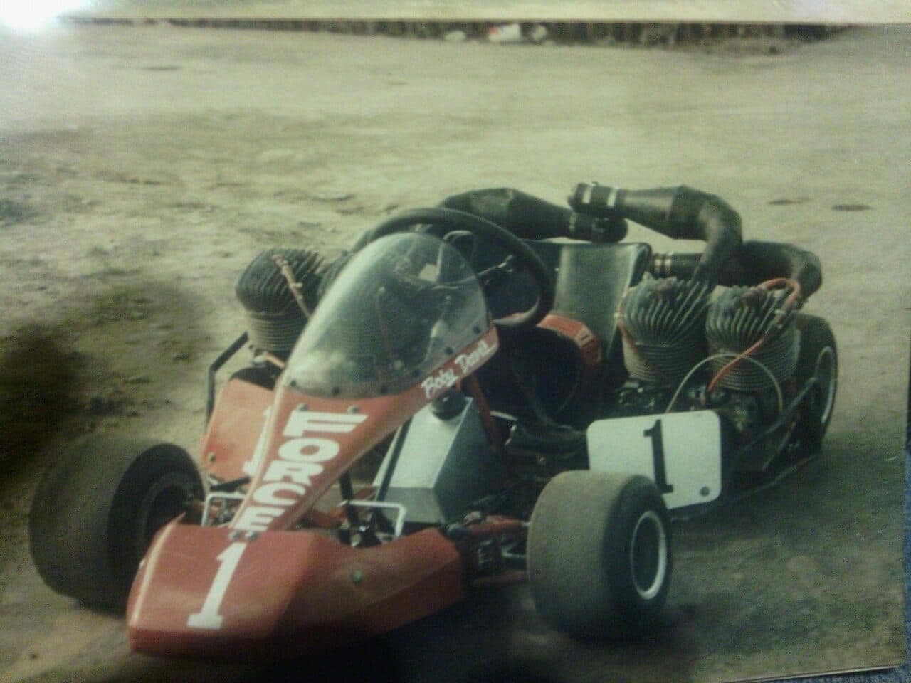

Dirt, 30+ years ago. 500cc two stroke on methanol. 100 hp or so.
I know it’s Easter, but JESUS Rob. That looks like so much fun. The last shot with the front end coming off the ground is so cool. I lived on the east coast and did a little dirt oval in a clone one night. Other than the boringness of going left with no one else on the track it was extremely fun.
Did you guys have tear offs back then or did you just grit it and go blind?
