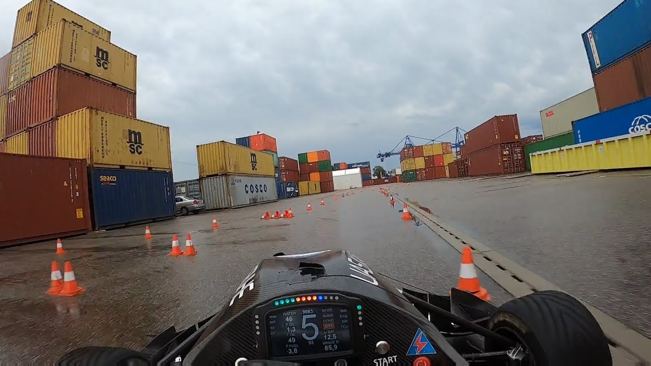

@speedcraft OK, change of plans. We arenât going Barbie racing. Instead we are re-matriculating to college and going off to dominate (well, you maybe) formula student and drive like @KartingIsLife around sketchy stevedores and shipping containers. Our team name can be âOld dogs, New tricksâ. Our team principal below:
How about âOld age & Treacheryâ as a team name.
I actually canât believe that in this safety obsessed world this is allowed to happen, but Iâm glad it is.
Tracks with consequences make me smile. ![]()
It might be Euro, because I agree, it seems like the kind of thing a college/uni wouldnât risk.
