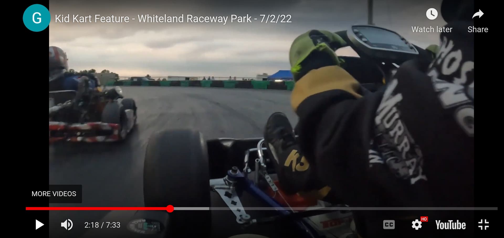

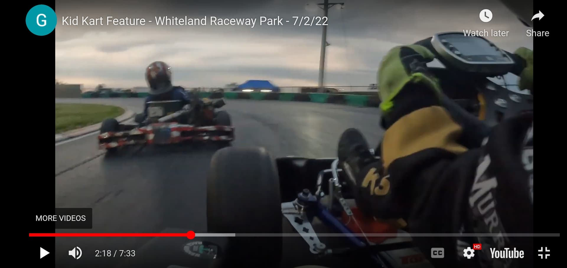

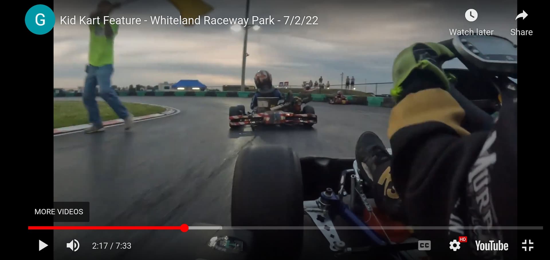

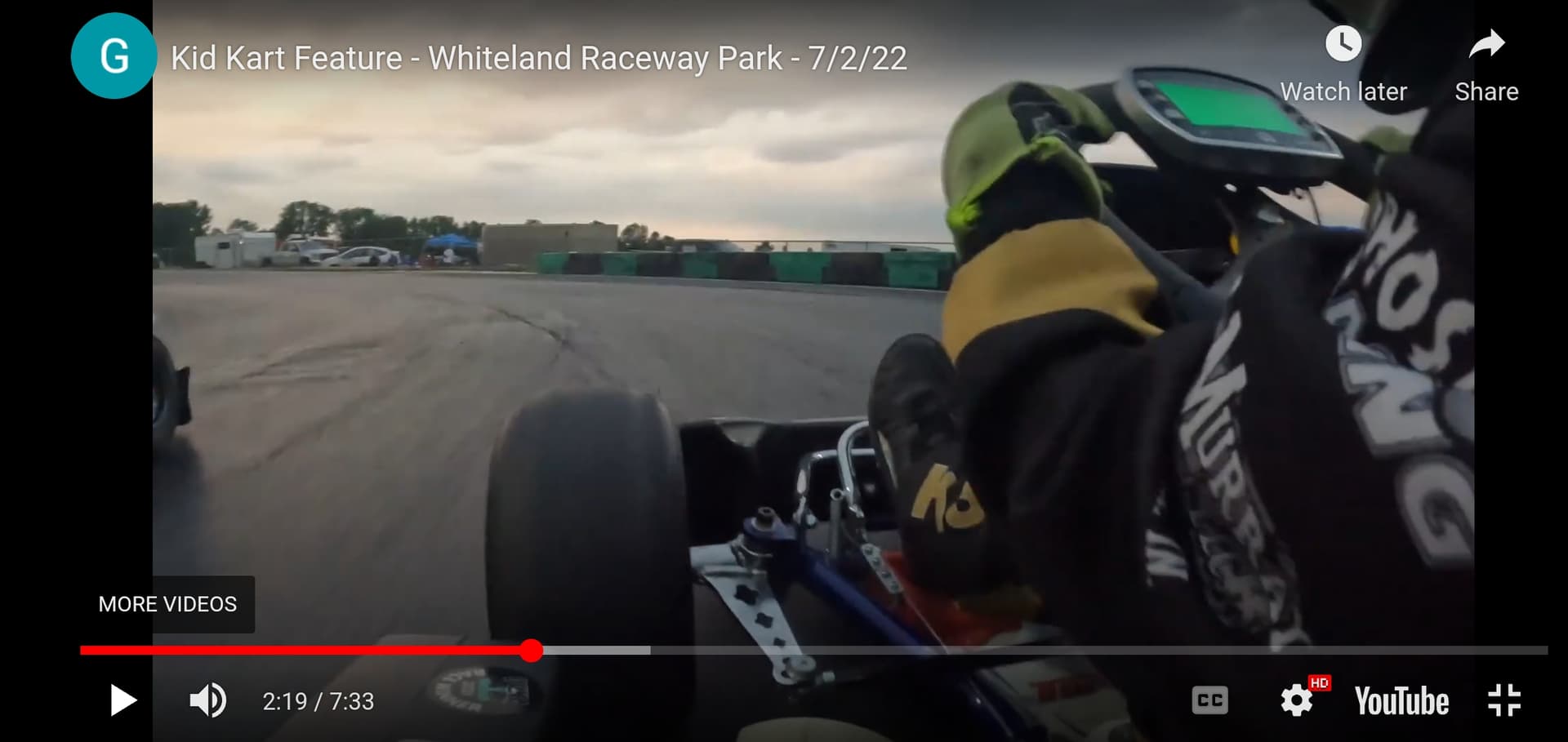

He is past the flag and past the incident when the pass is initiated.
You can see the incident here
He’s beside the incident here and almost past it.
He is well clear of the incident.
Pass

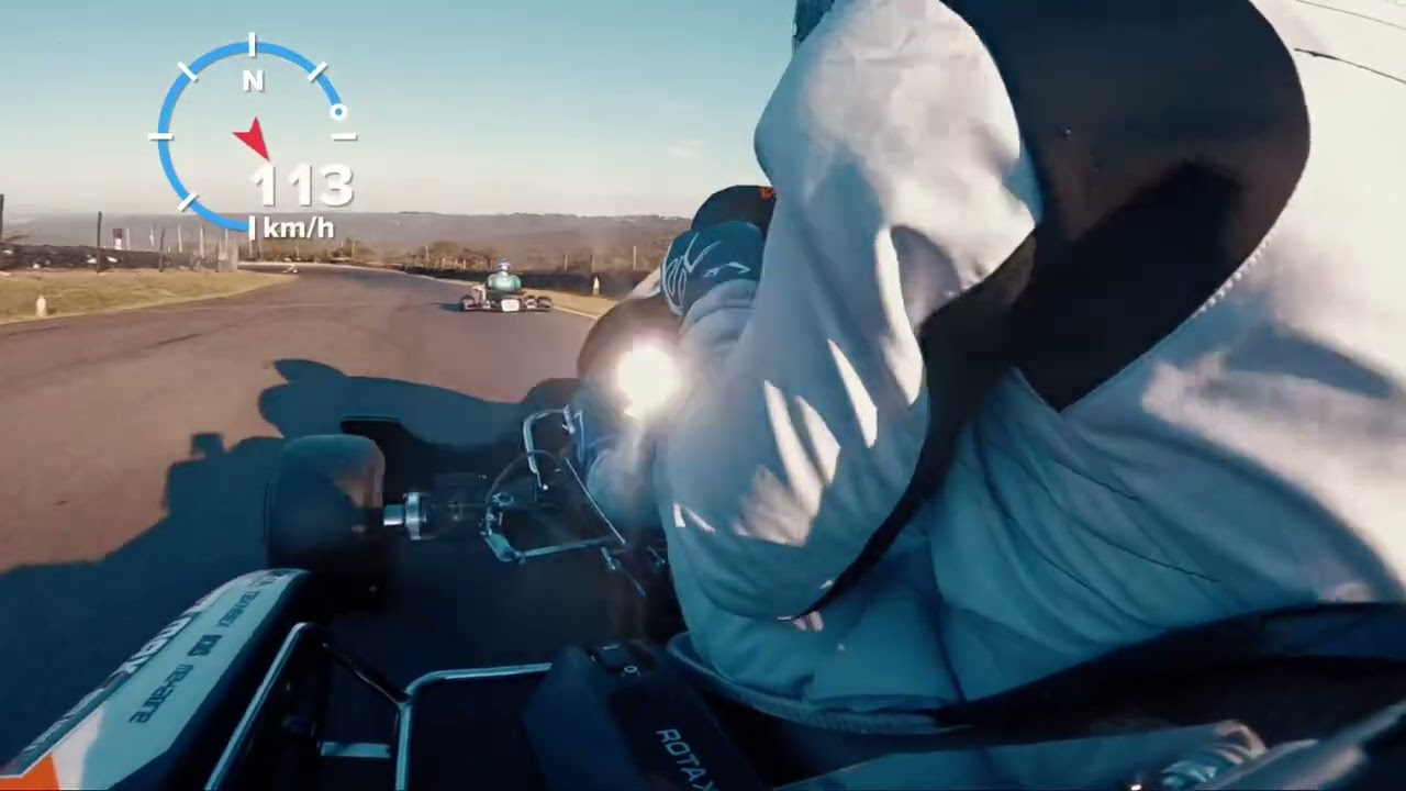

I’m a sucker for Idube, so I thought I’d cross post this which was in my suggested this am. Recent DD2 footage.
The downhill bit seems insanely cool and this is a bucket list track, imho.
Dd2 is probably a PITA with its odd axle/drive system but two gears seems better than 1 and it seems to be the weapon of choice out there in SA. I’d love to drive one, someday.
