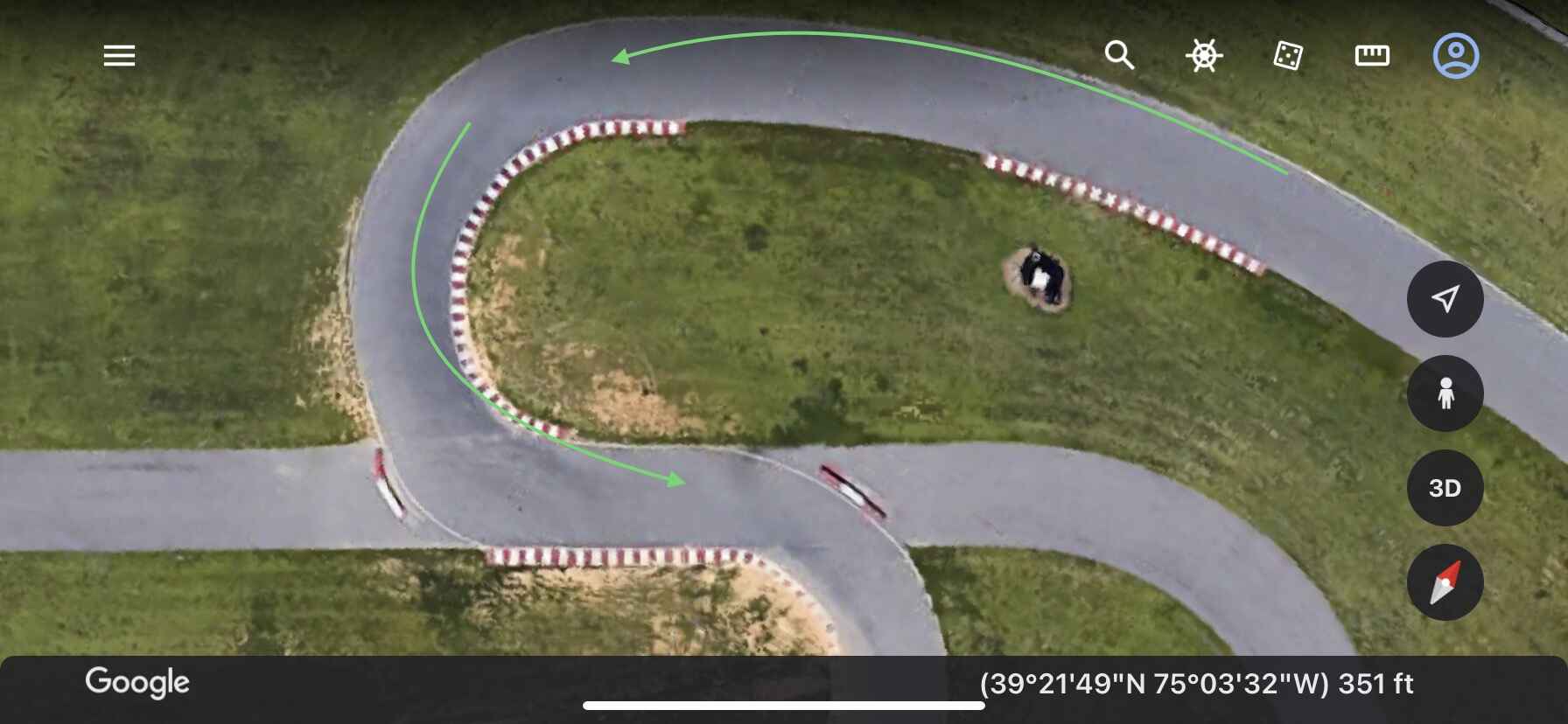

T1:
This is the trickiest and where you will likely struggle initially. T1 has a bend prior to entry which throws people off line. Assuming a normal entry, try to get the kart parallel to the inside red and white stripe. The dirt patch at the end is from wheels off there and it’s basically the brake point (but work into it). Key here is to hold that right side a touch longer so you don’t turn in too early and get wide on exit.

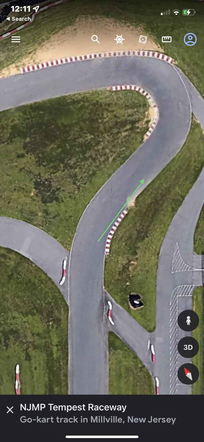

2-3;
Start with two. The fast line setup is to hold the outside right edge of the track on the way down the “front straight” and delay the turn into 2, allowing you to late apex 2.. In defensive mode you will be middle or left of track entering corner (narrow). Sets you up for slightly llate apex into 3, just be conscious of braking here. You don’t want to overdo it and push/understeer midcorner.
If you set up 2 correctly, 3 will allow you to get to apex and push out fast. Early 3 will push you wide and and you will open the inside up and lose at apex/exit.

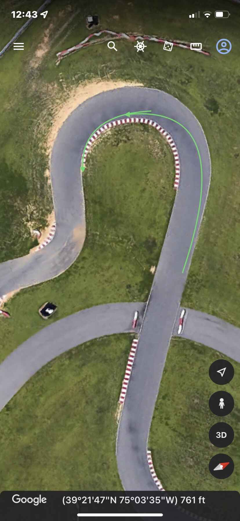

5: The fast line is hold right side and delay turn in and come from above, coming down to a late apex. In defense mode you will not be able to set up wide right and will have to be thoughtful about sending it into turn. Idea is to get it down to a late apex to power out. Fast entry is no good if you slide or aren’t efficient in the middle.
We will do a track walk. Take from these drawings the spirit of the line as the drawings are pretty badly rendered and I get frustrated.

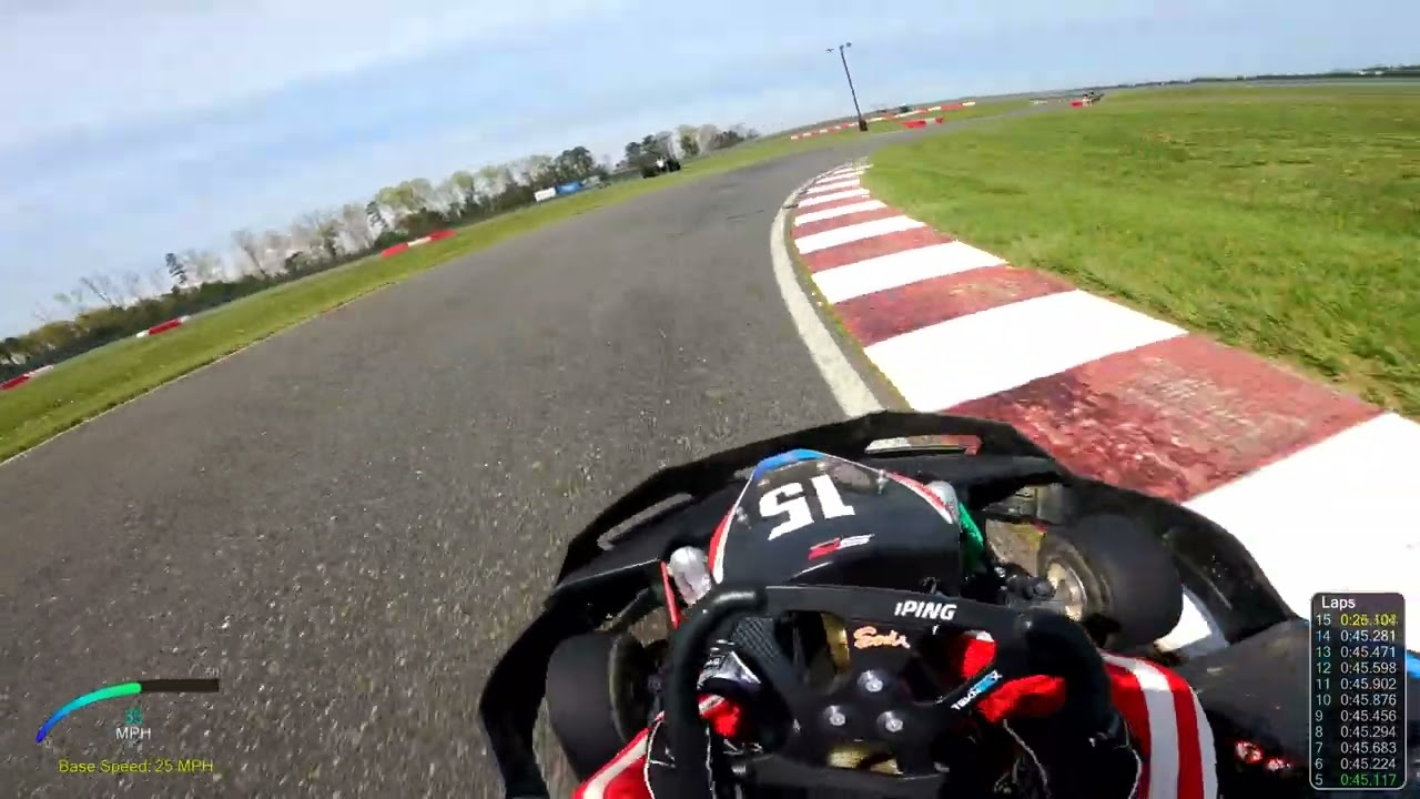

Man you had a close call with the barrier there. How do those karts compare to the ones we drive?
Those are the new Sodis. They are very similar. Perhaps a tad better. This one appears slow. A good lap for me on a decent one will be 44ish. Good kart I can go 43 ish.

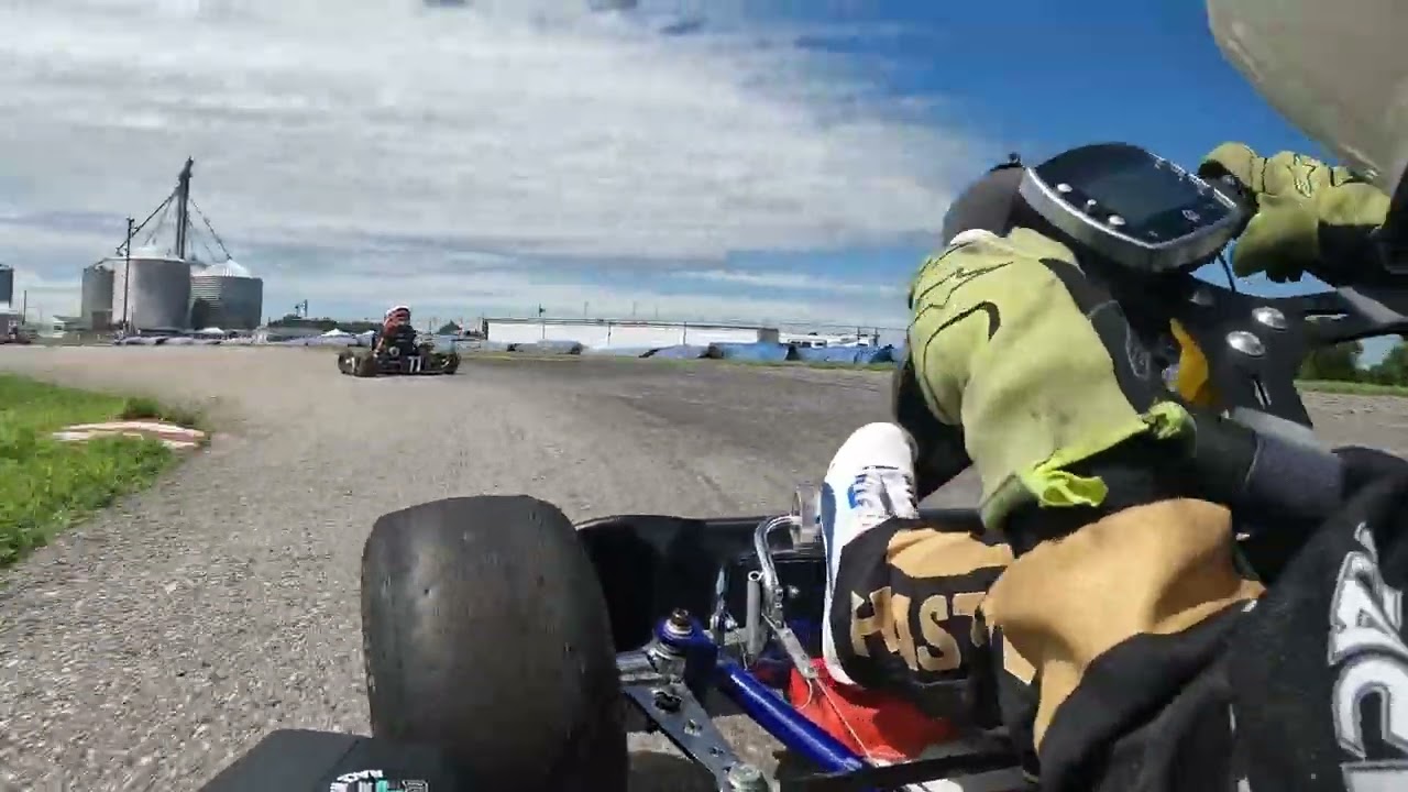

Here’s some actual race footage.
This footage has both offense and defense.
Pay attention to the corners where I am entering “narrow” in defensive mode. See how I use the braking/positioning. There’s footage of me defending or passing into each corner here.
You’ll learn by doing where to reach for position and where to chill.

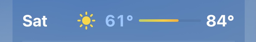

Here’s the surprising forecast:
