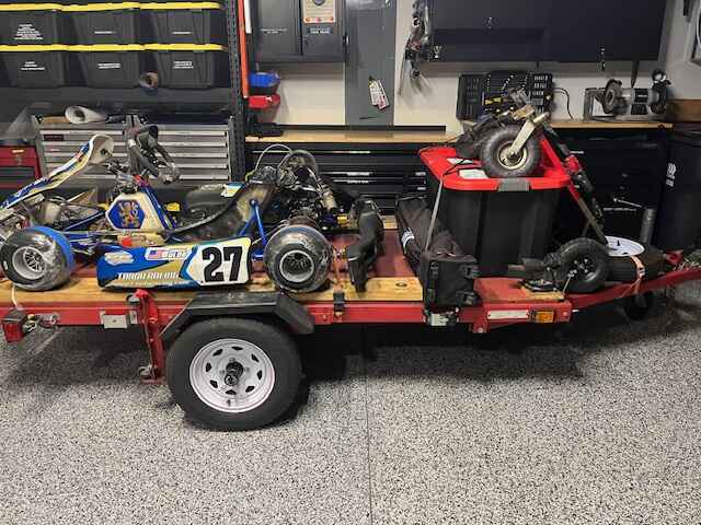

I loaded kart up on trailer, considering going to Jacksonville Tomorrow…

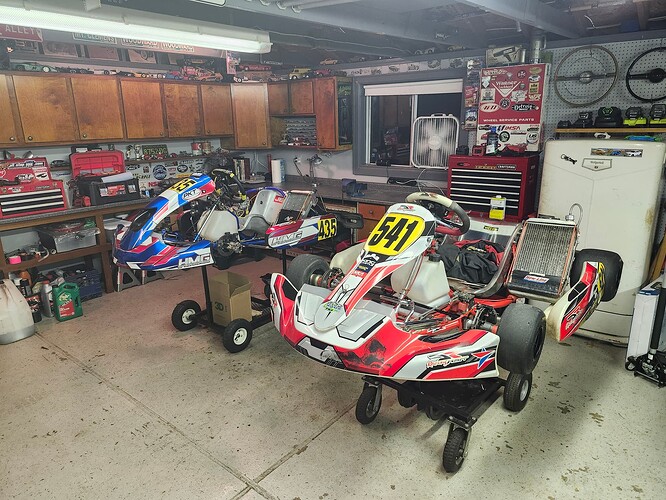

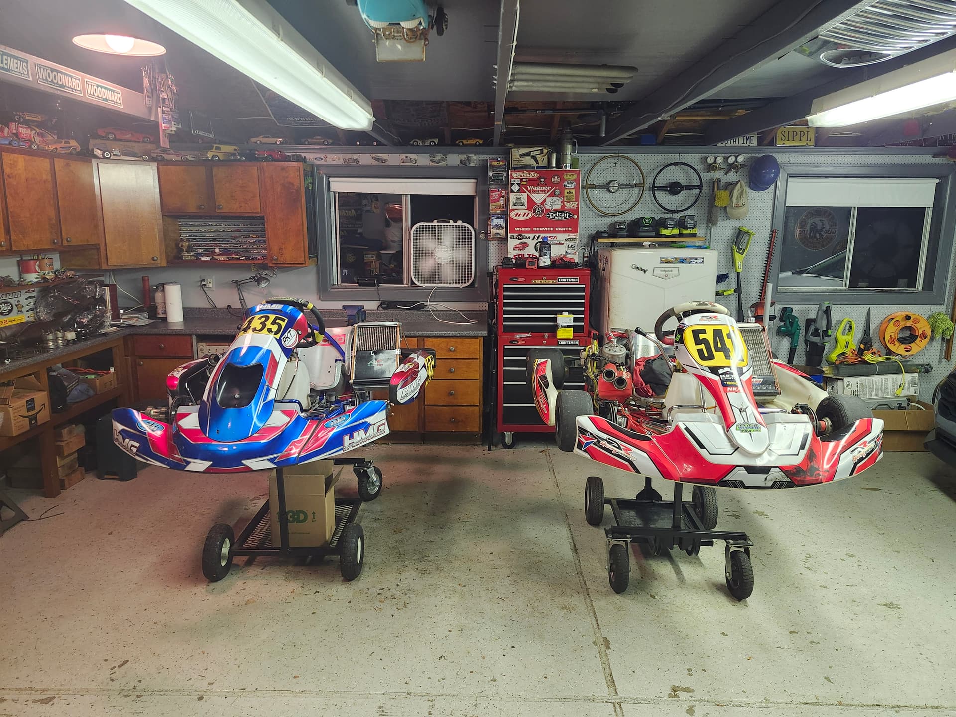

Cleaned the garage today. You may notice there are now 2 shifter karts in my garage. Thats because @Flyingfin789 is now a shifter kart owner. 2020 DR M99 with a K9B. Fingers crossed we get it out before the seasons over.
