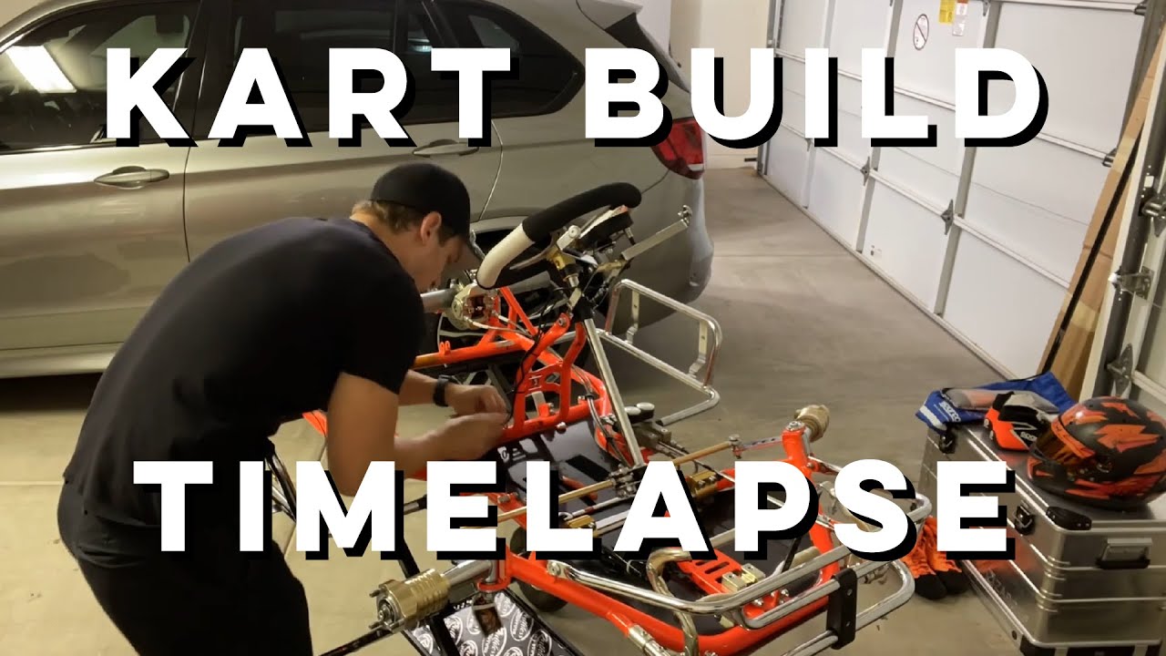

It’s back together! Virtually all new hardware and bearings. Just need to mount the new seat when it arrives and get some of my competitors rubber of the plastics! Couldn’t find Exprit orange at the local hardware store. It’s gonna bother me that it’s a different color, but not that it’s gonna hurt laptimes.
Edit: also I did a timelapse of the whole thing I’ll post later when I splice it all together.

Threw together a little edit of my timelapse. Several wardrobe changes later it’s complete. It was a miserable +100*F in the garage, about 8 hours of work from start to finish, and about 20 popsicles :sweat_smile:
