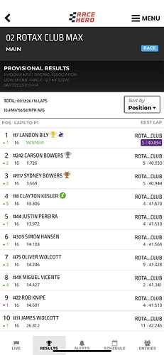

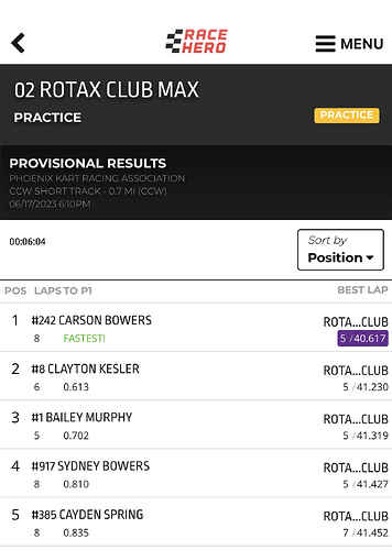

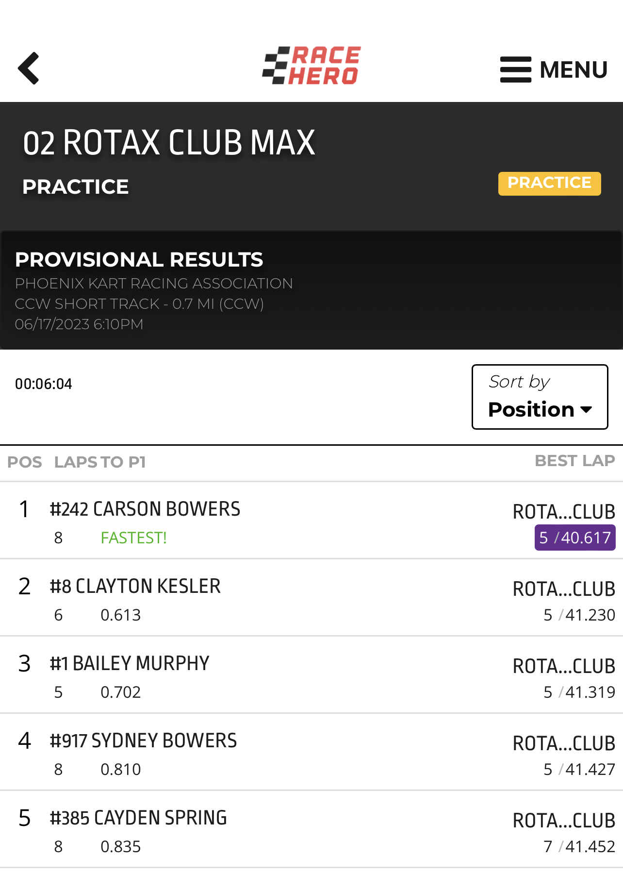

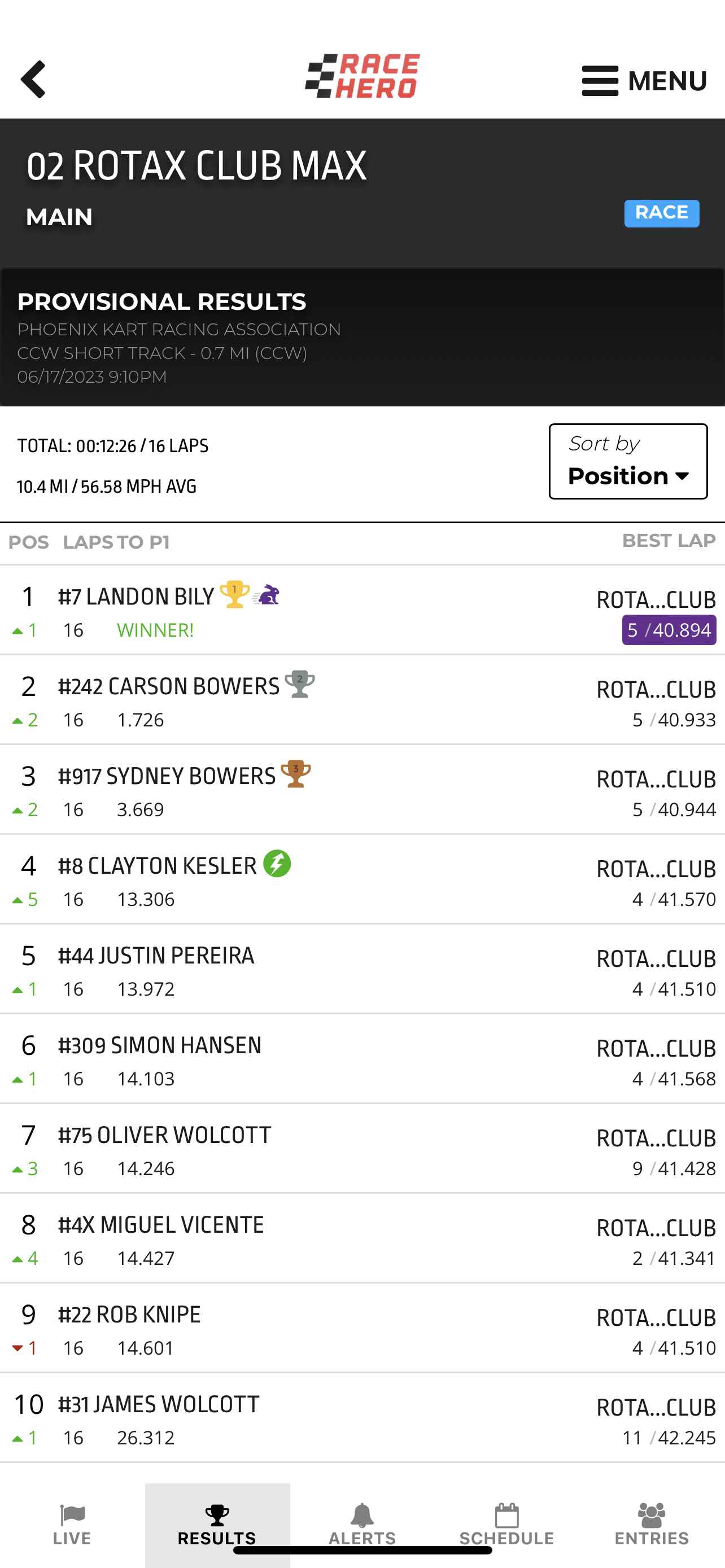

Local club class I ran is a weird one. It’s the Rotax junior motor and tires but at 350lb min weight, calling it Rotax Club Max.
I was about 20lbs overweight and the motor I ran was just getting worse on bottom end power throughout the night.
Practice I went alright, but right from the start could tell the motor wasn’t 100%. Made some engine changes and it just got worse for qually. New tires and race the same lap time. Heat race made some early passes and just kind of just chilled in my place.
In the final I still managed P4. Had a great first lap and made up a bunch of places in T1. Then just had to defend for my life coming out of every corner from a train of guys behind me with a lack of power.

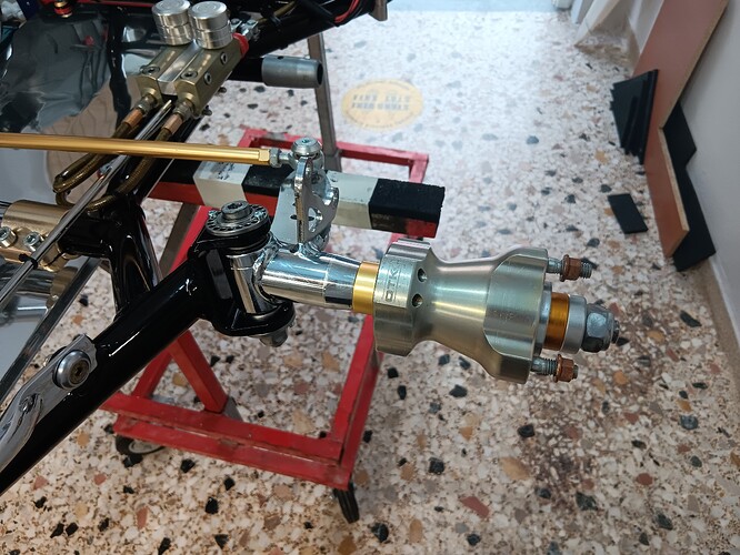

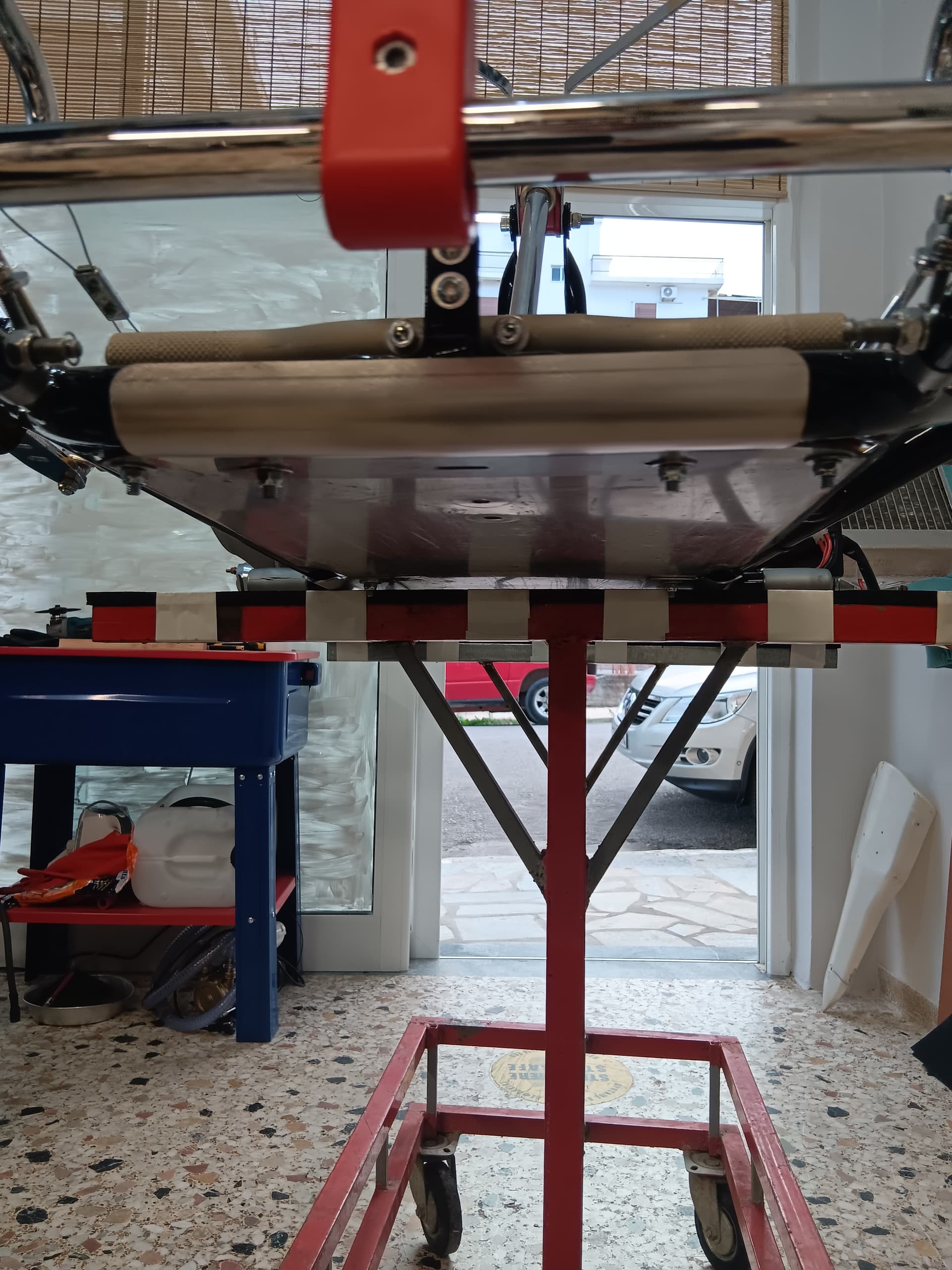

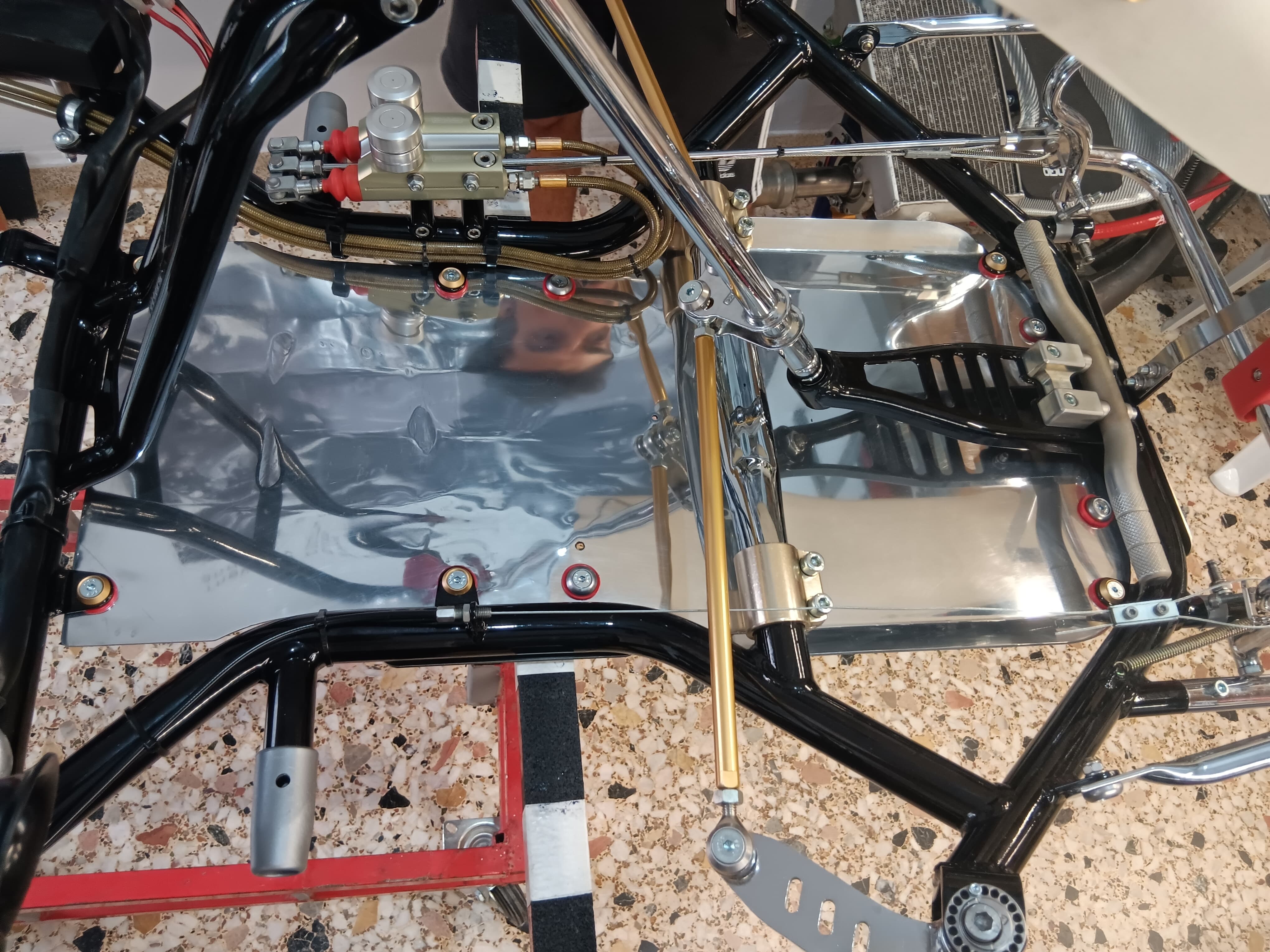

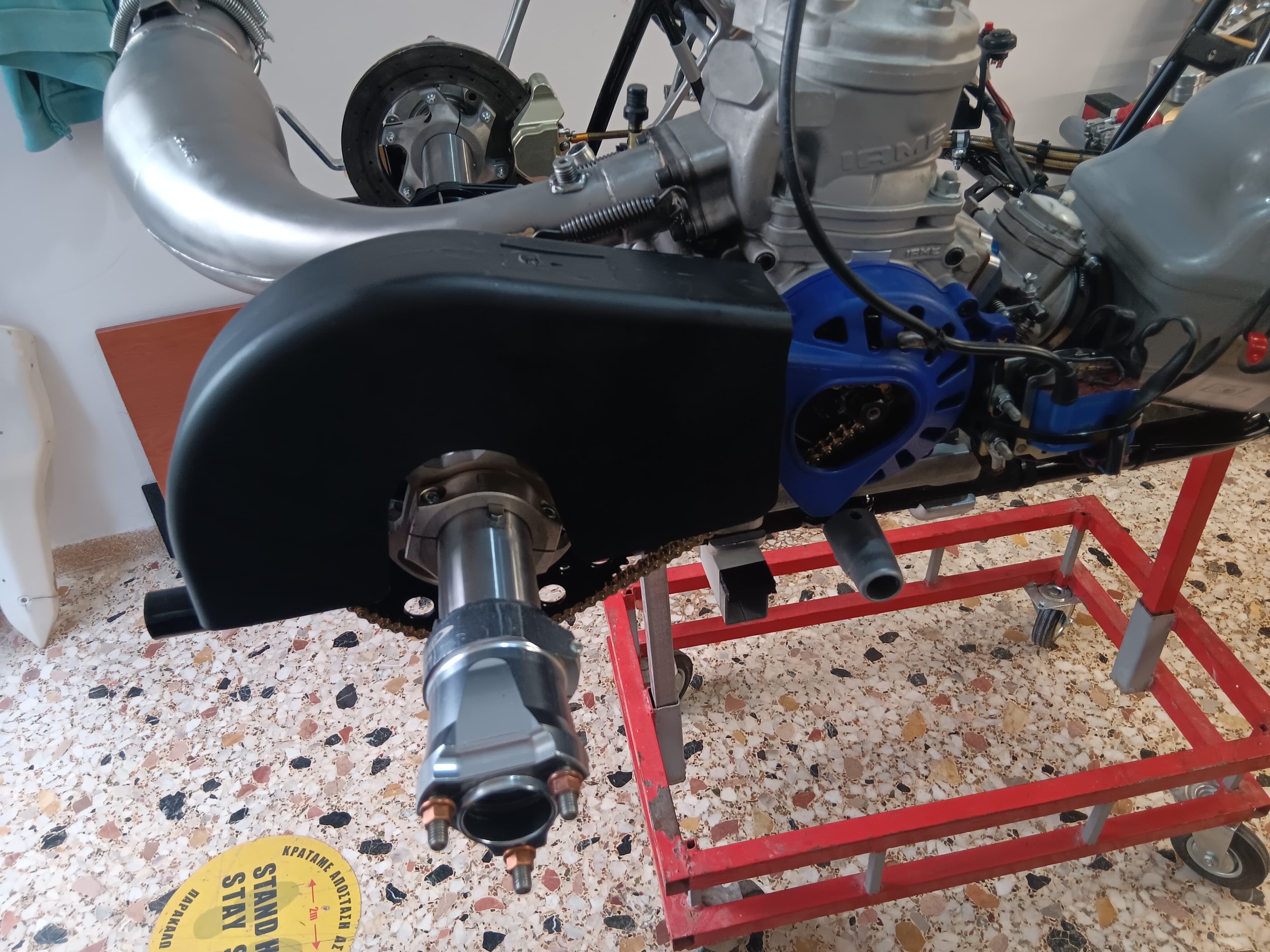

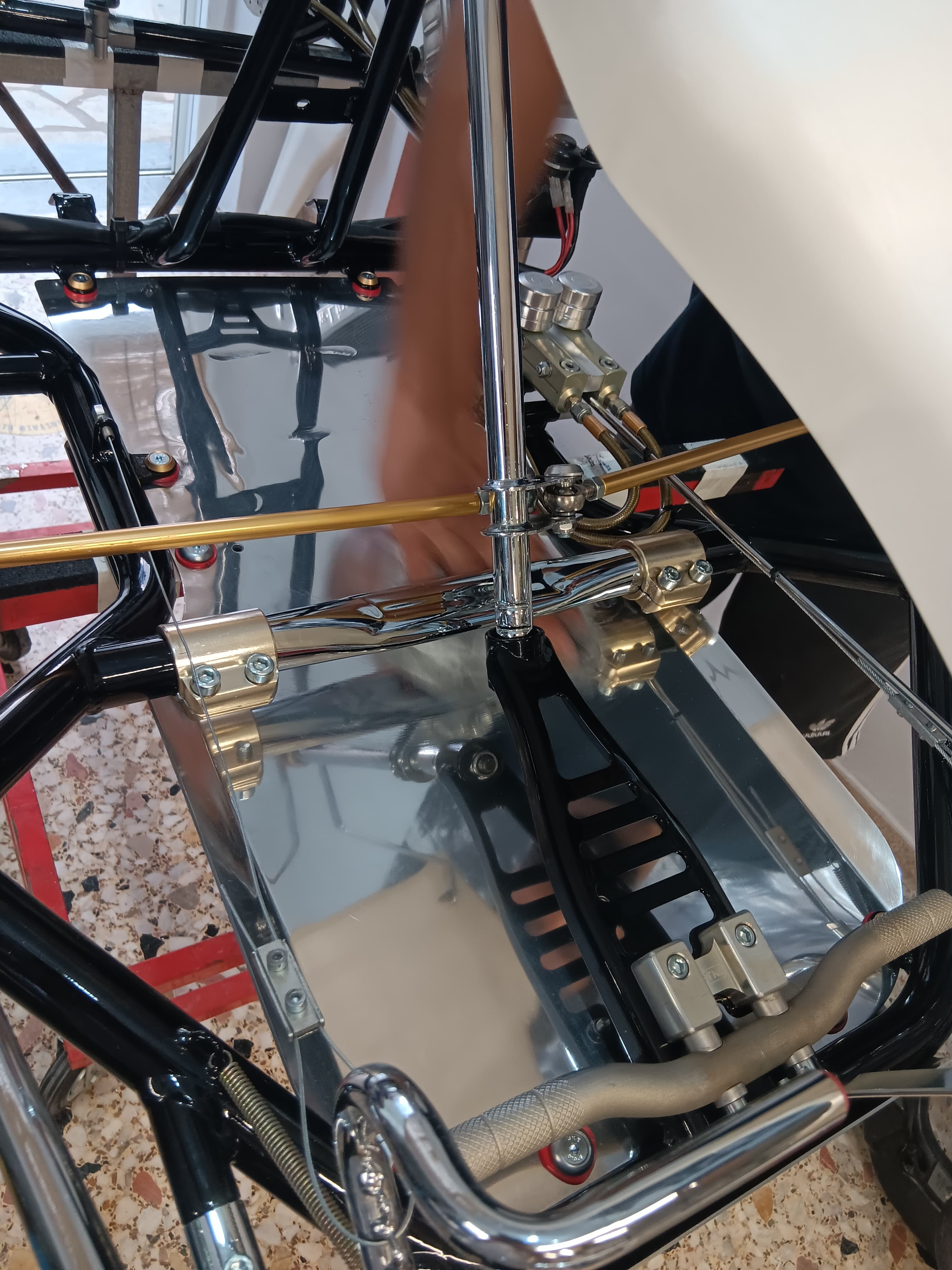

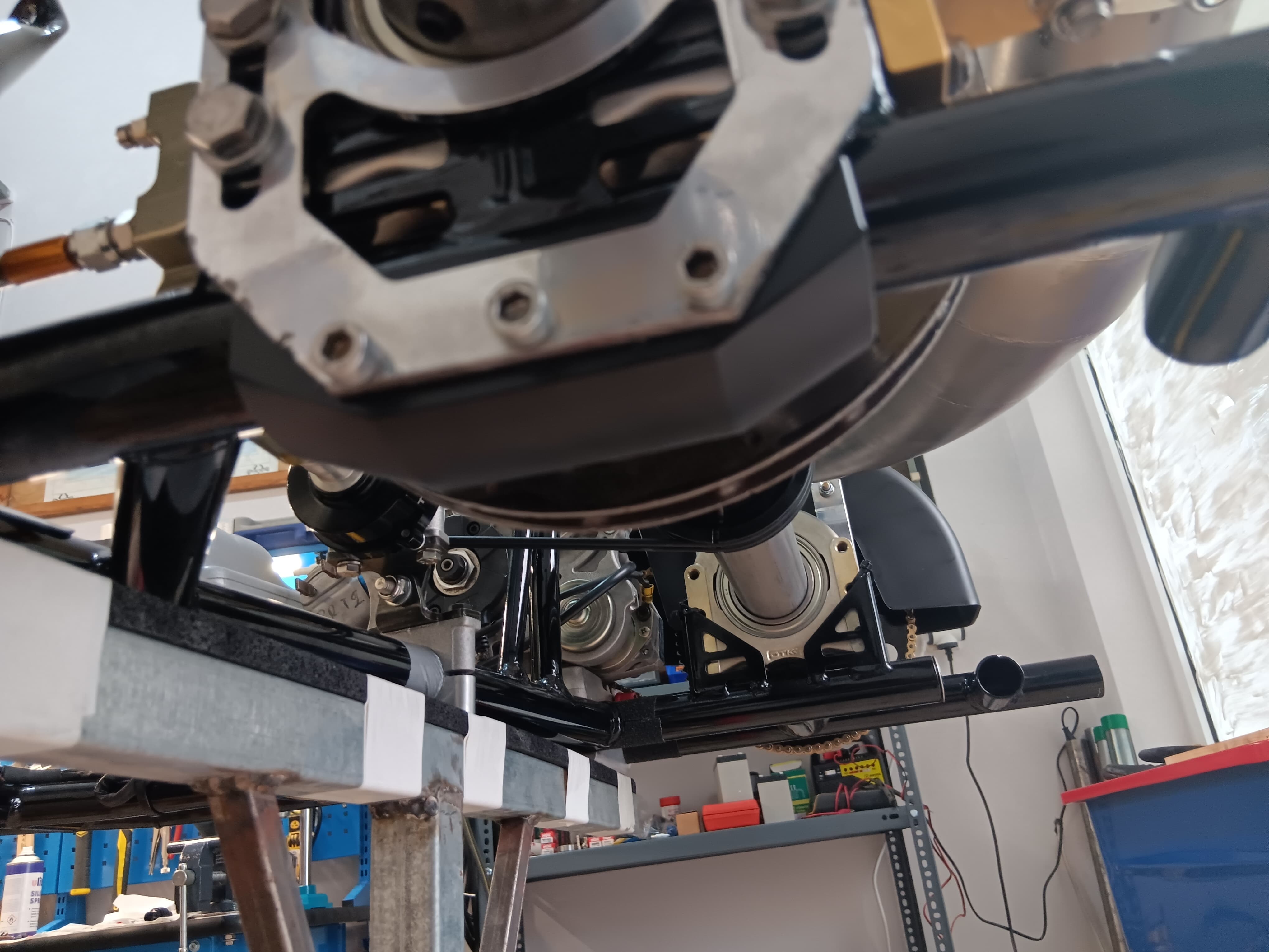

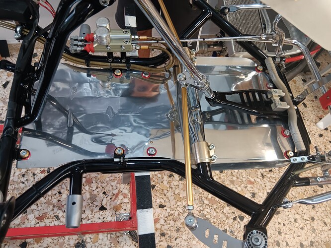

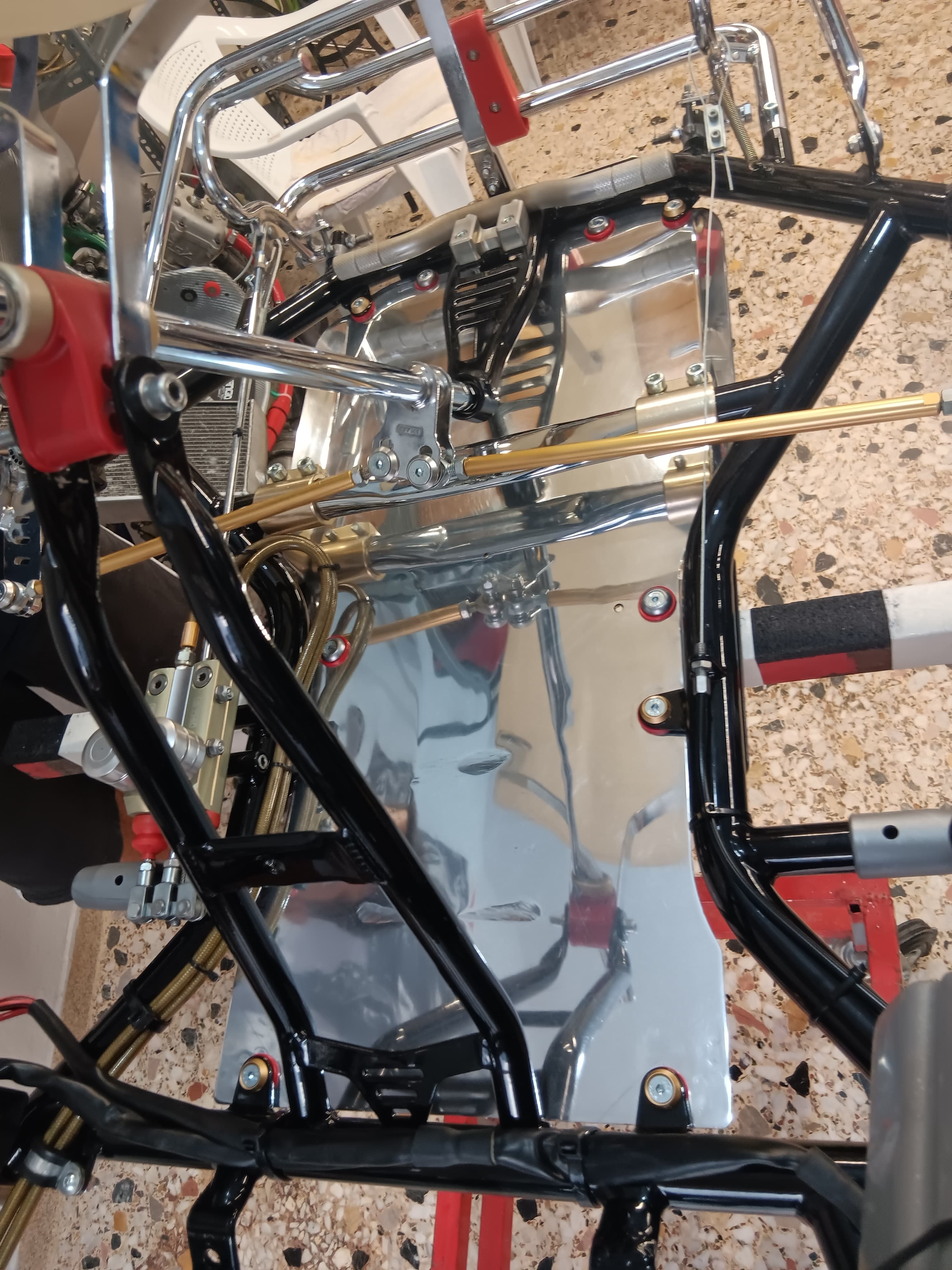

Well new parts arrive and we had some work to do .

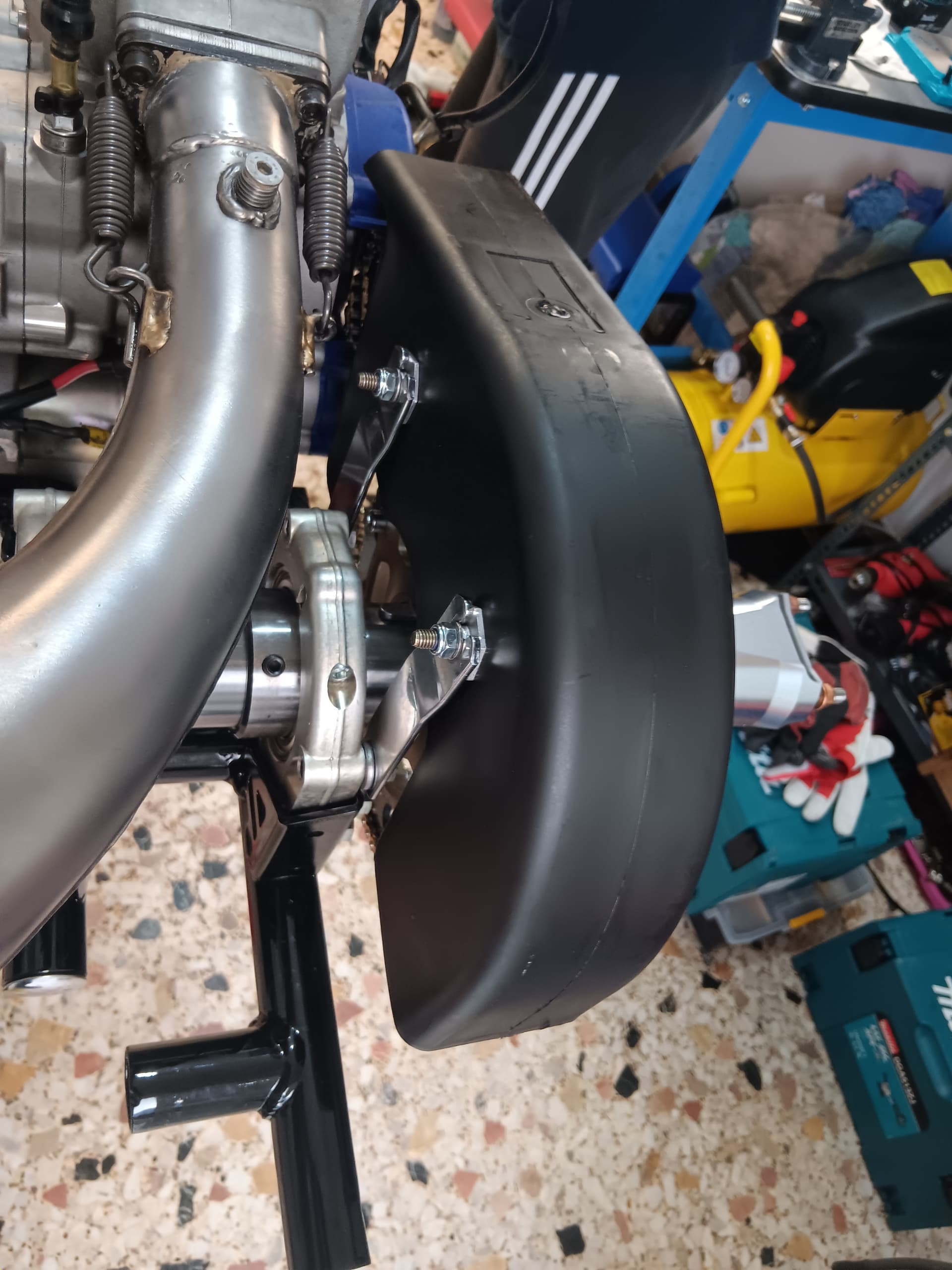

Frame protectors installed . Floor pan also installed . New front hub bearings on . Chain protector from Righetti witch is very decent installed . New water hoses are in house and we will work with then next time we get some wrenching time .
Front allighment end is on the way to start also .
It looks great as it goes on !!
That floor pan is looking SHARP!

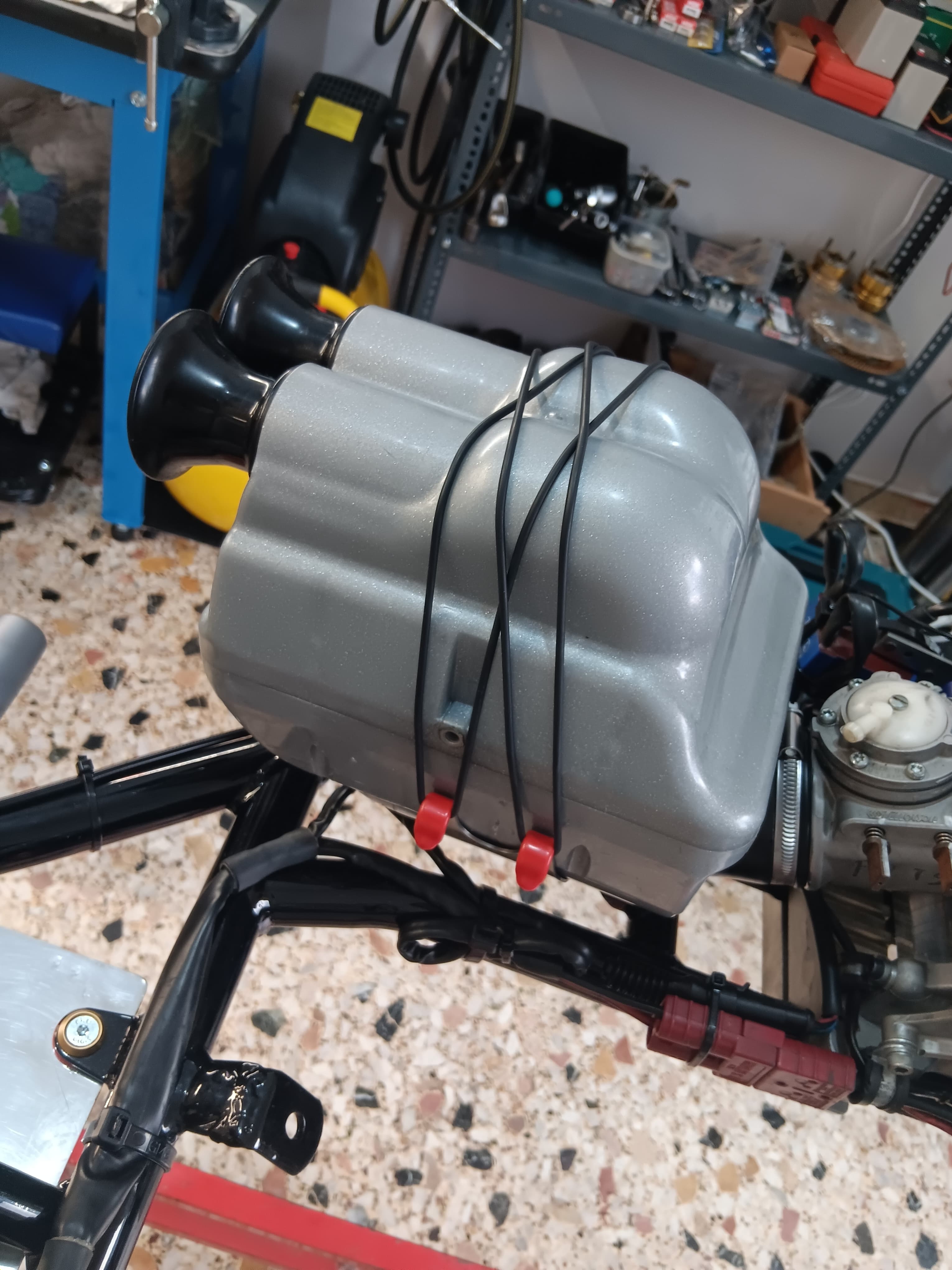

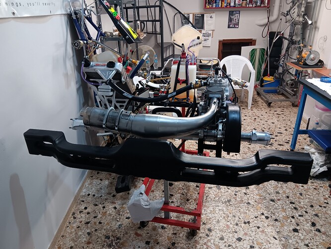

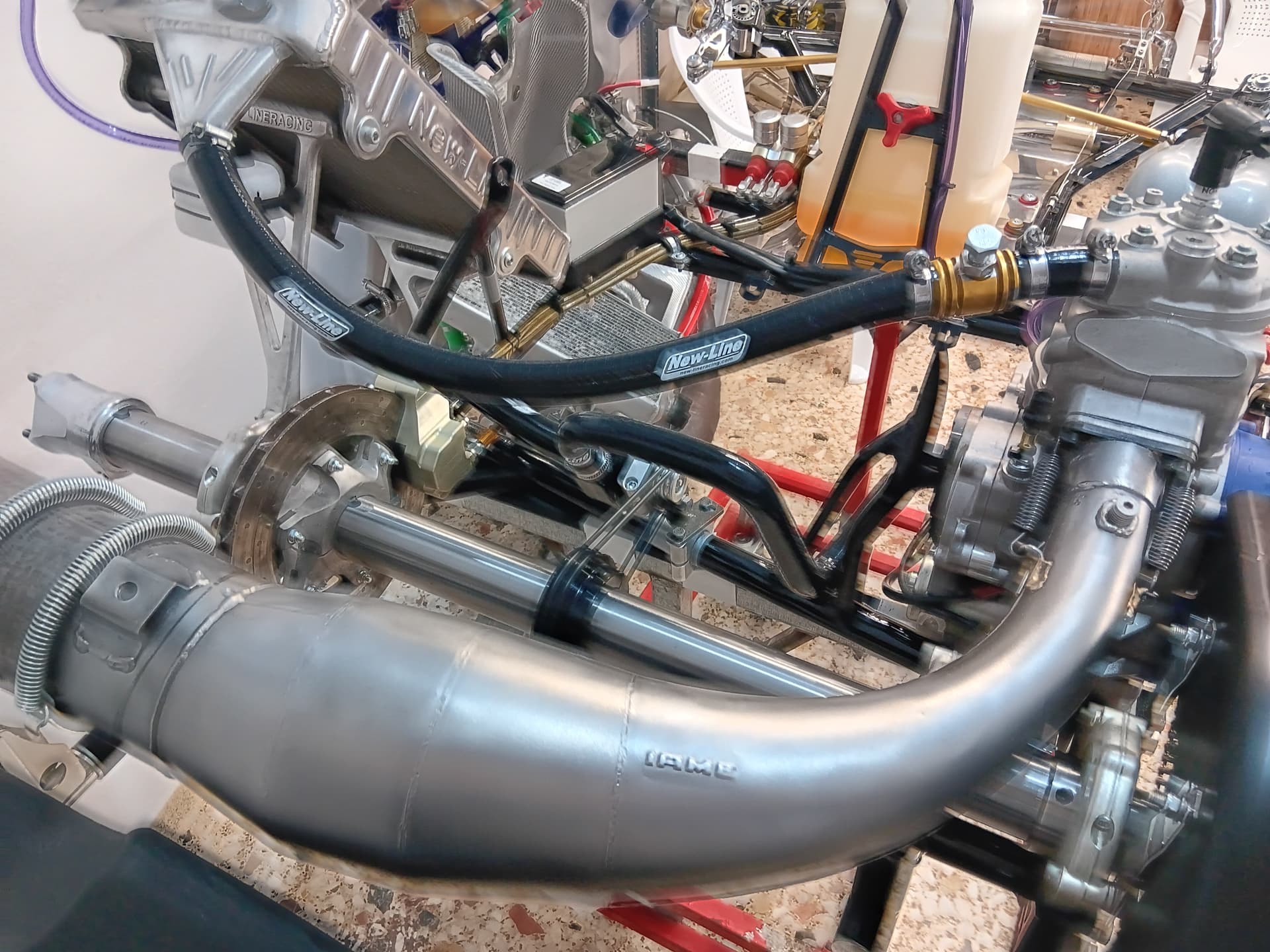

New water hoses and check for leaks and if the water pump do the job . New rubbers on rear bumper bases and bumper on . The tillotson parts for the carb are in house and we are getting that a Proper service next time .

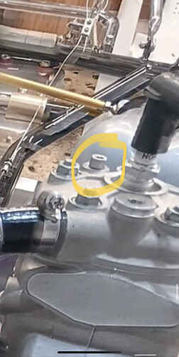

As i check the water cooling system and also check the manuals i can see only one way to bleed the system and thats from the engine head . It seems that iame engine dont have a small bolt down the crankcase sides that you can do also bleeding air from there as the rok engines have …
Am i right ??
Or i am missing something ??
Fill it with water and then lift the kart from the radiator side to burp the air out, and top it off. That’s how I’ve always done it on watercooled engines.
You can use this bolt on the head to bleed. That said, I have also used TJ’s method countless times over the years.
