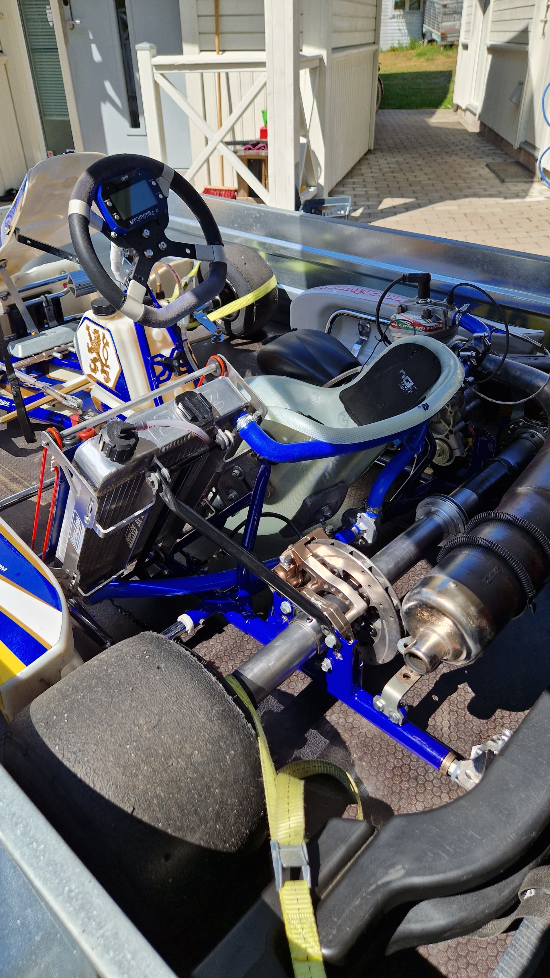

Going for testing in my brand new 2023 praga fighter to se if everything is good before nationals. And test out the new brake system…:smiley:
Ofc going with the 2019 bodywork beacuse i just love it. The gold and chrome blue❤️
Looking good, hope the brakes are good. But a brake is a brake😂
Different feeling, same outcome
I mean… yes and no. I have now the track record at my hometrack (unoficial) and it was 0.500 faster then old brakes and chassis. Alot better brake performance. I had 4 year old brakes… and now i can move my braking points about 5m longer

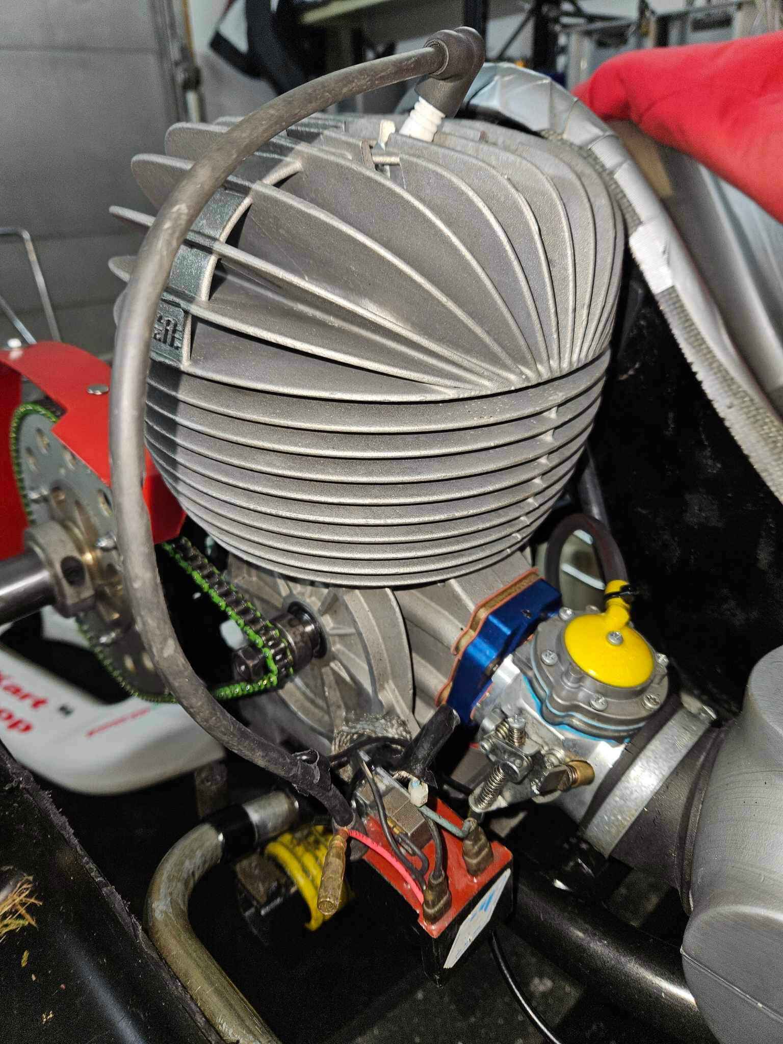

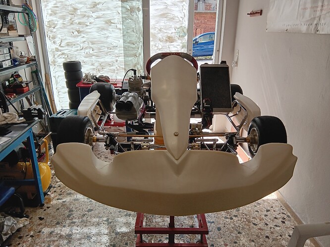

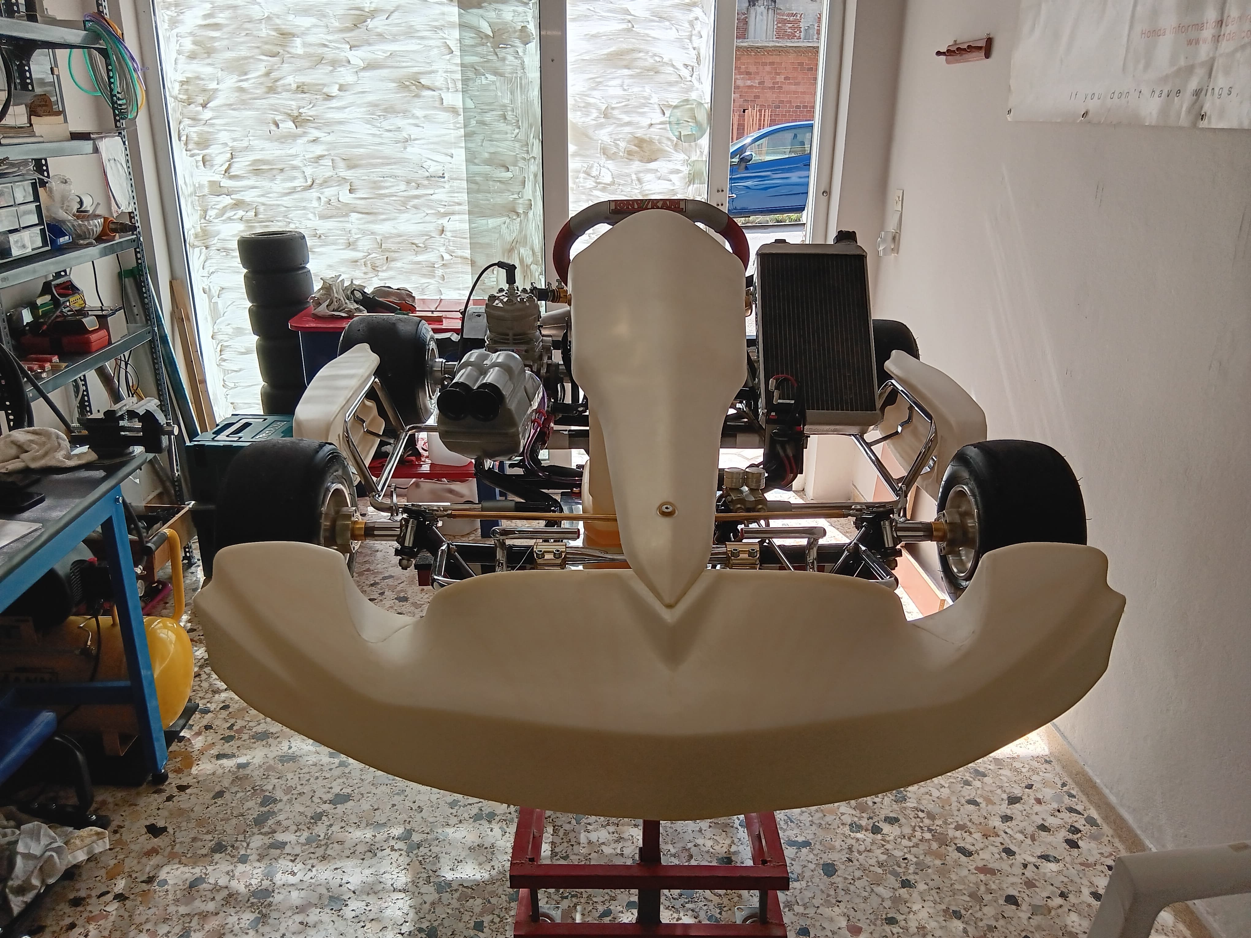

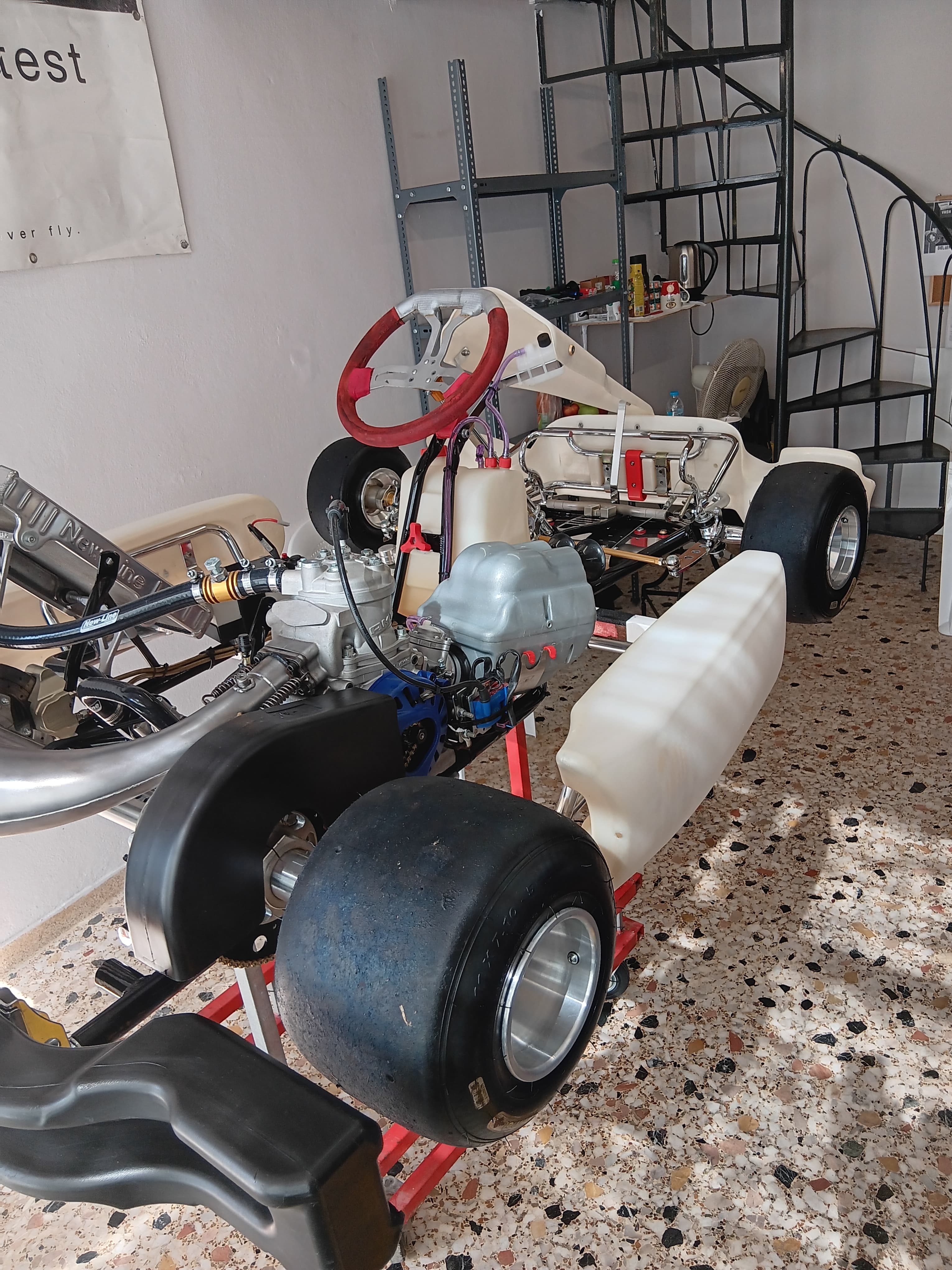

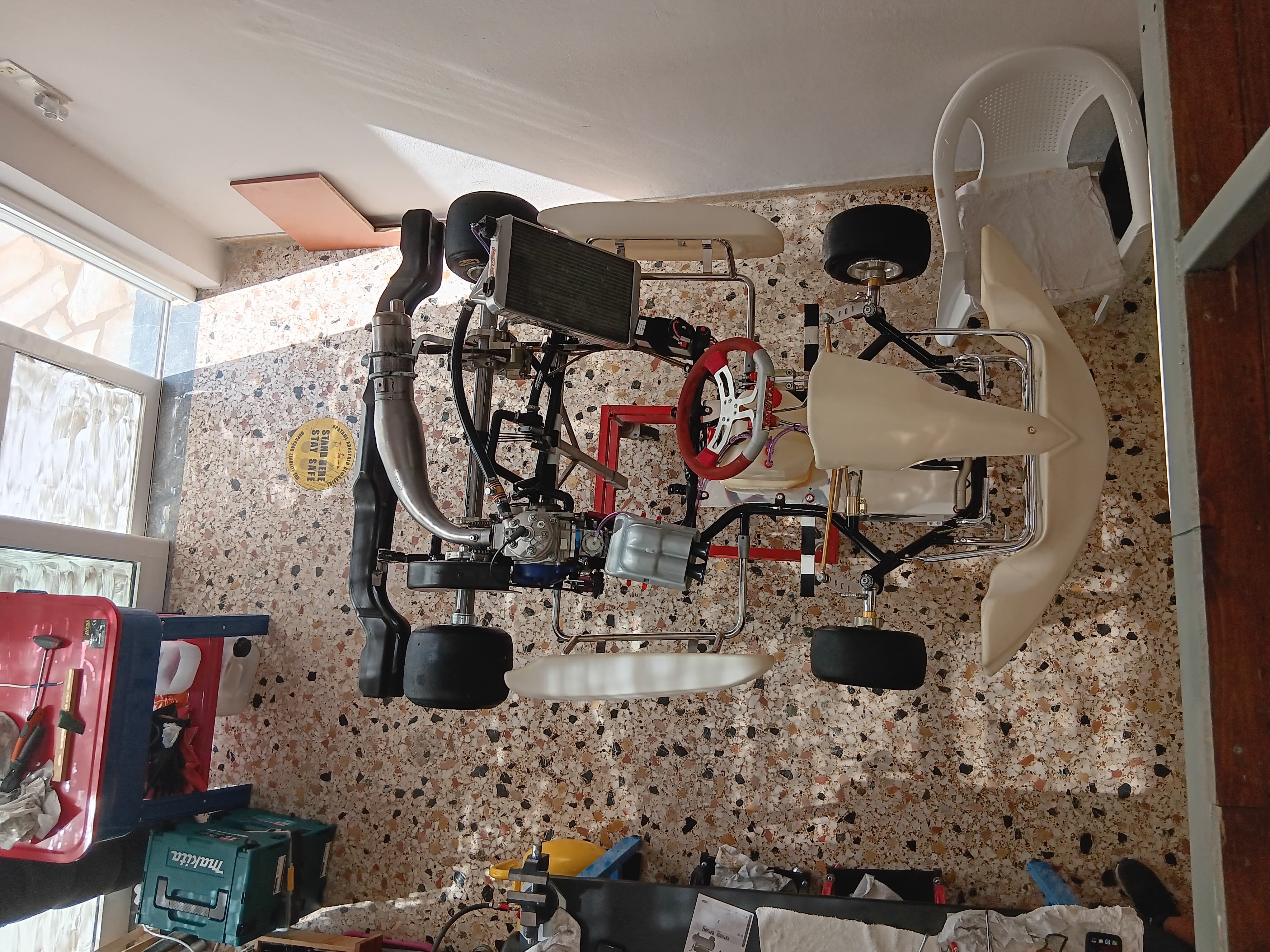

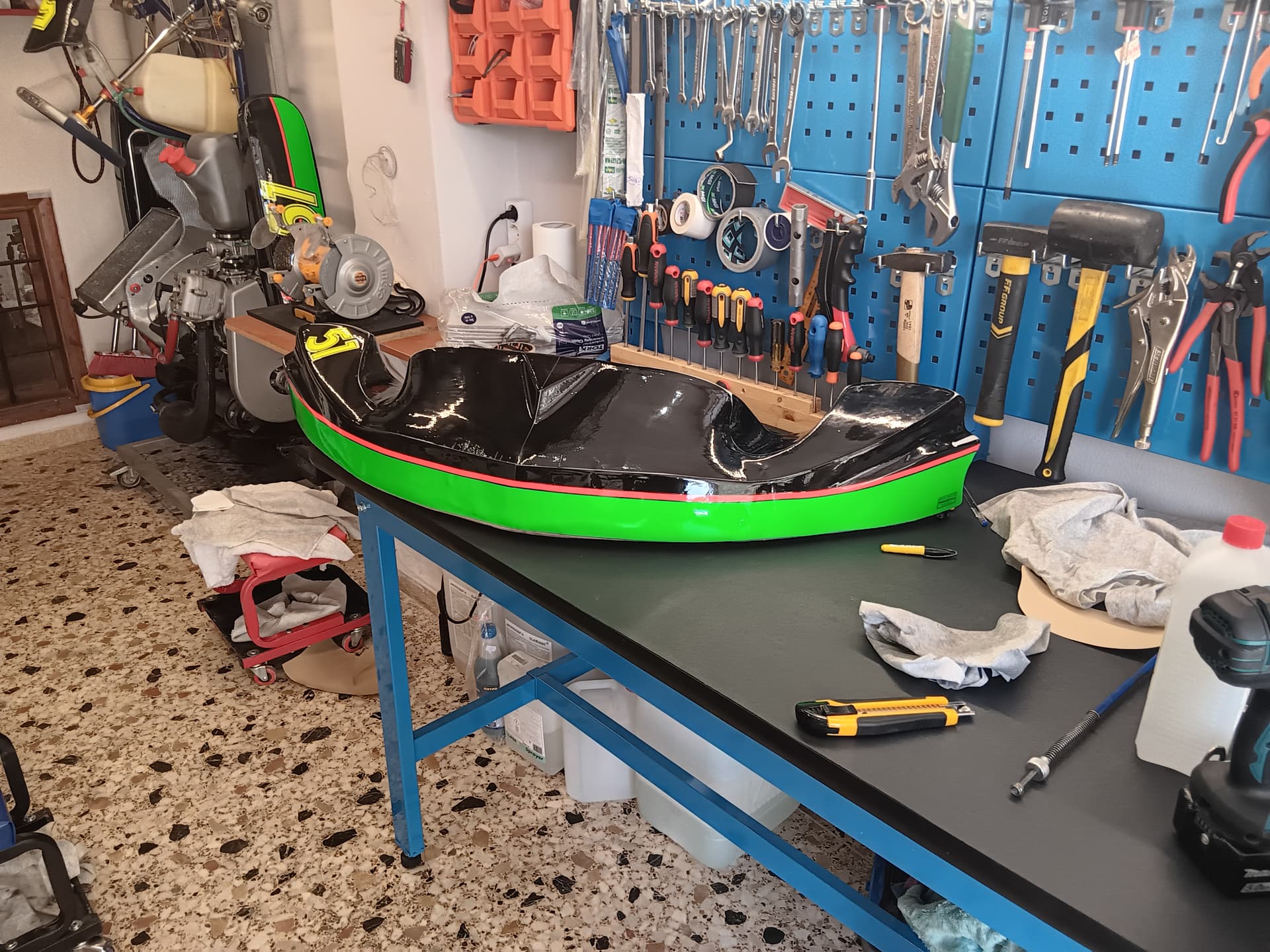

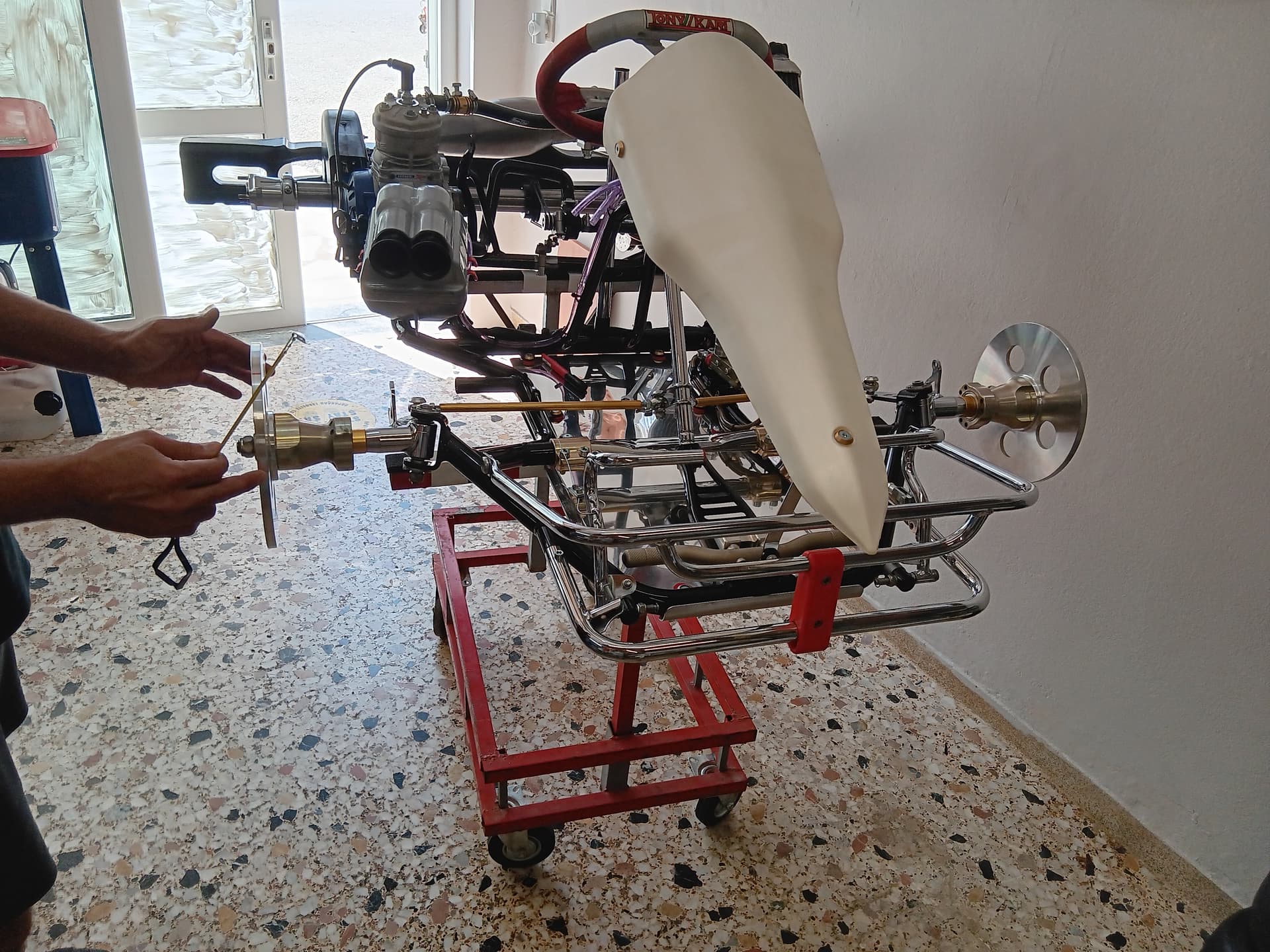

Servicing tillotson carb with a new kit , checking also for the pop off it was a little bit lower but we give a litlle stretch to the needle pressure spring and after that it pops at 10 psi and hold steady at 8 psi . Off course i will order new springs 42 and 46 grams for future tests .
The engine was running a litlle Ritch on low rews and bogs at idle so the low needle needed to be a litlle bit tighter from the baseline set up to make the engine run crispy at low revs and keep a healthy idle . Front end aligment also done . Almost new tires installled and all the bodyworks clean up and set up to see the picture almost done .
Now we will try to raise some money and get a new seat . I thing is gonna be a jecko coz we are happy with the same seat on our other kart .
Almost done !!
One more photo from the other kart the mello yello livery is my all time favorite and i cant wait to get some seat time with her !!

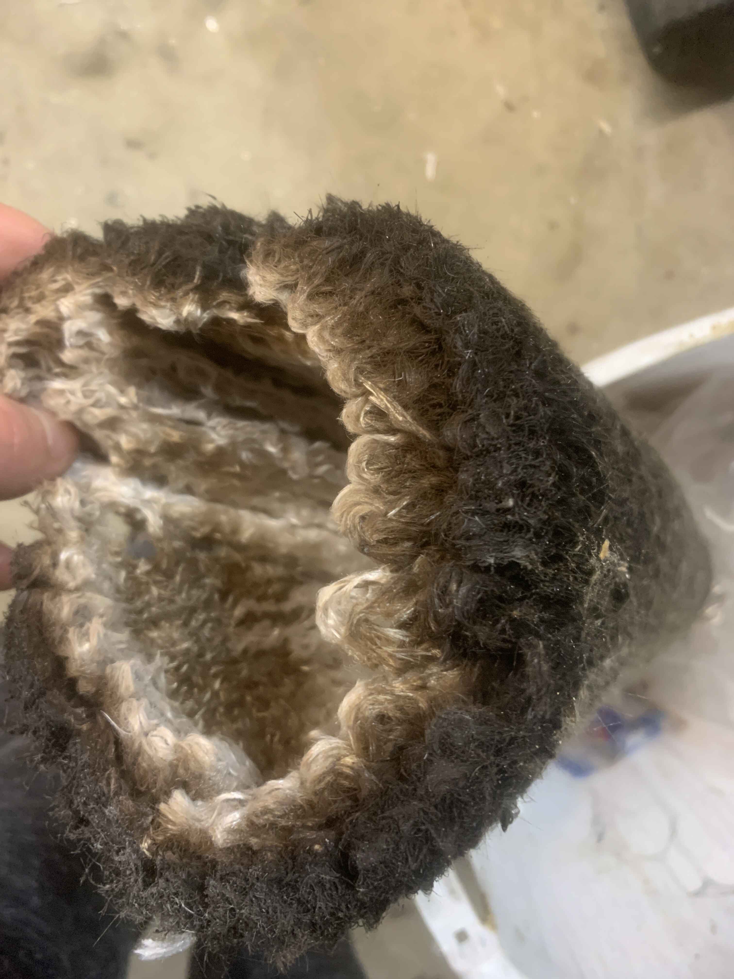

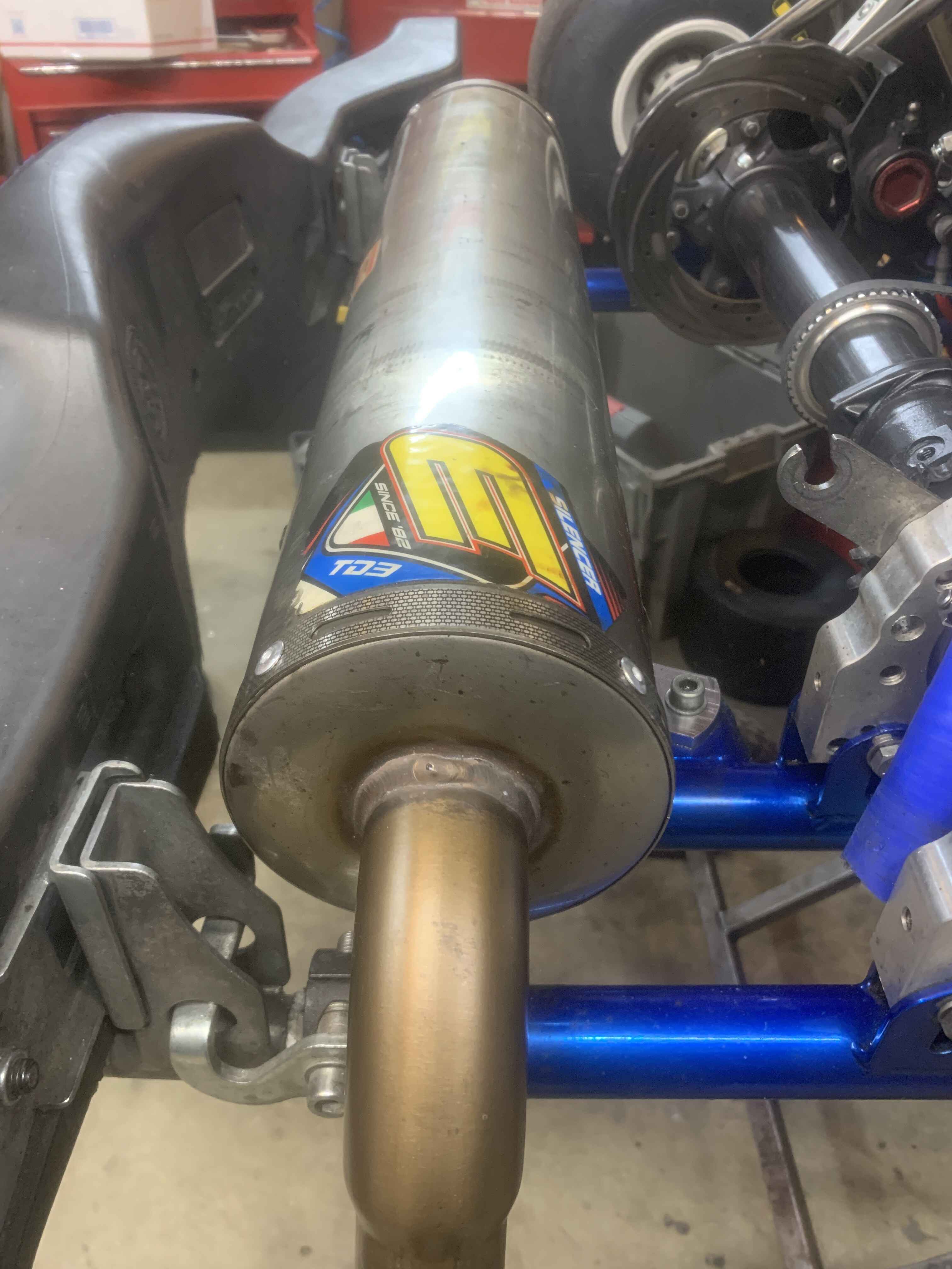

Prepping things for round 3 of the Stars Championship series. I replaced the packing in my exhaust silencer, and swapped over to a different piston and head combo to test in advance of the race weekend. I fully expected the silencer to be heavier with the new packing due to loss of material, but it was actually the opposite. The packing seems to collect oil/soot over time, so the silencer was around 20 grams lighter after replacing.
Looking good!
You just drill the rivets to take the packing out and the re rivet it?
I have the same silcencer in mine and hasn’t done this yet. How tightly did you pack it and with what?
Yep, just drill the rivets out slowly with a 5mm bit and replace with new 5mm rivets (I used rivets with 6mm grip length).
Elto makes a packing replacement kit that I ordered from a shop here in the US, but I’m sure it’s easily available in Europe.
I pulled both end caps off for easy access. The “entry” side cap has the core affixed, so simply roll the new packing around the core, reinstall and rivet that side, then reinstall the “exit” end cap, making sure that it is aligned to the core. It will require a rubber mallet, but it’s pretty straightforward once you have it all apart.

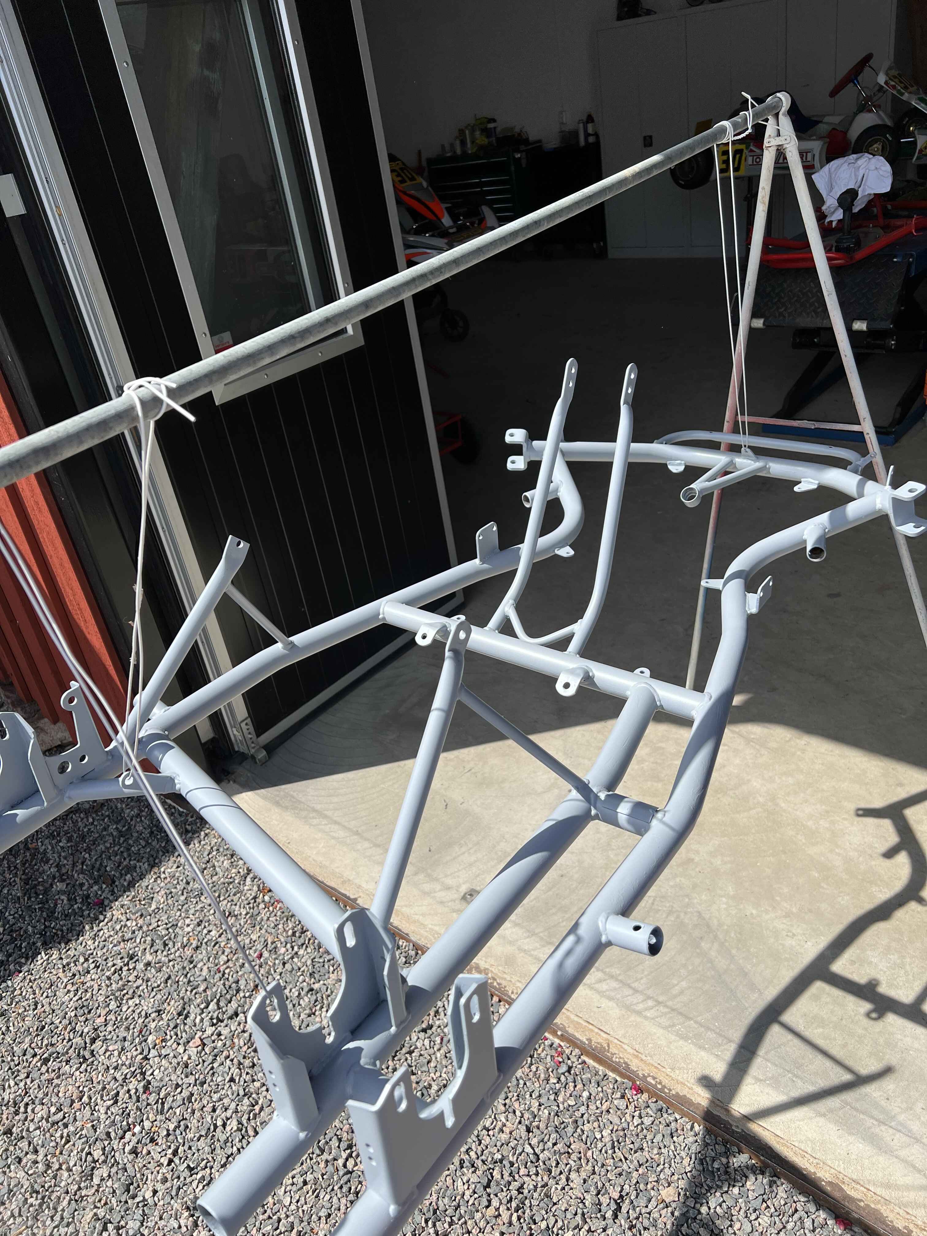

Finally some paint on my PCR Leopard chassis, previous owner scraped the color off and put some clear on in. I wanted it oem red, bought new stickers and found brand new yellow plastic!
Fun stuff
This is delicious.
Oh yes :fist:t2::sweat_drops:

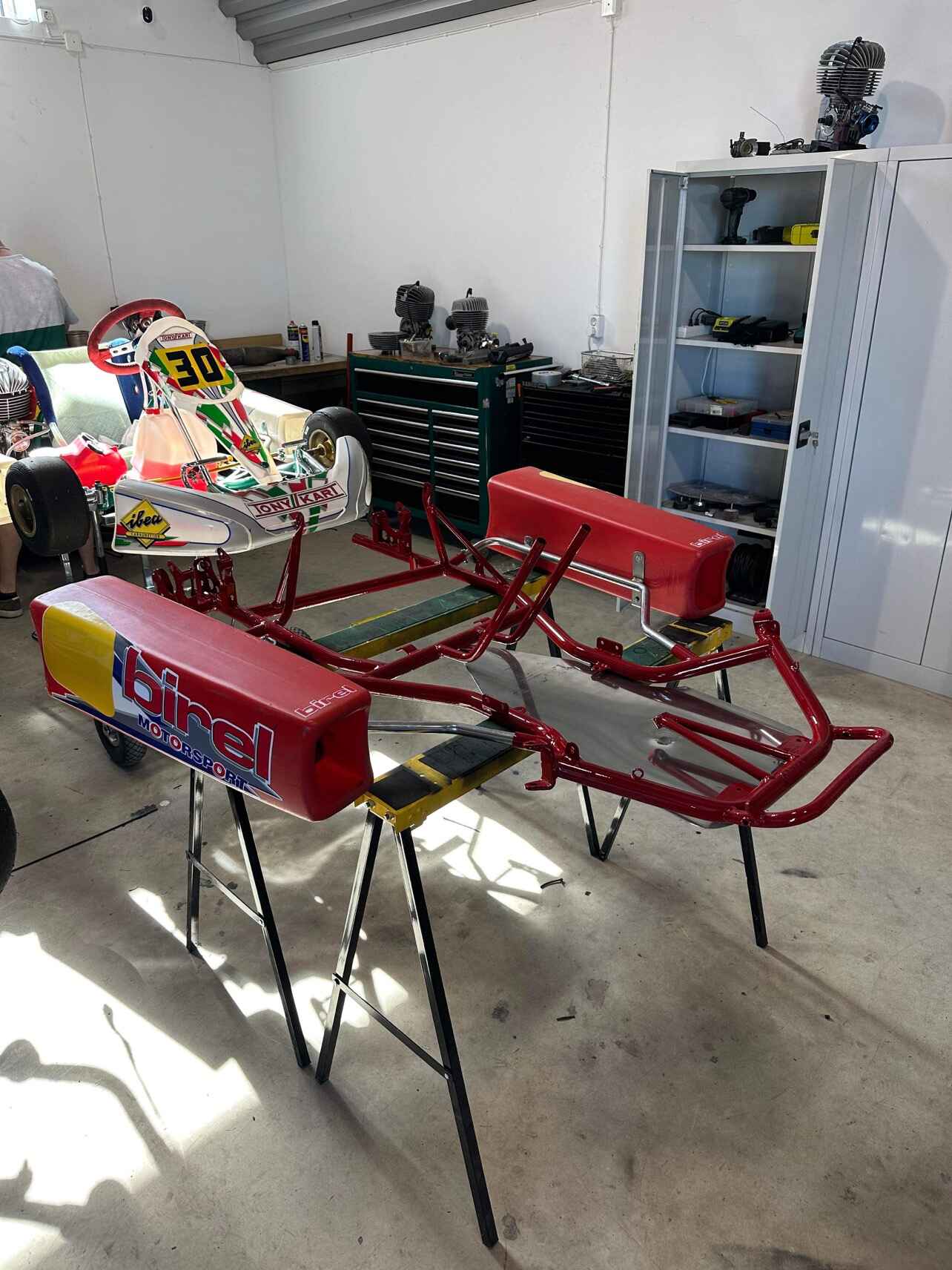

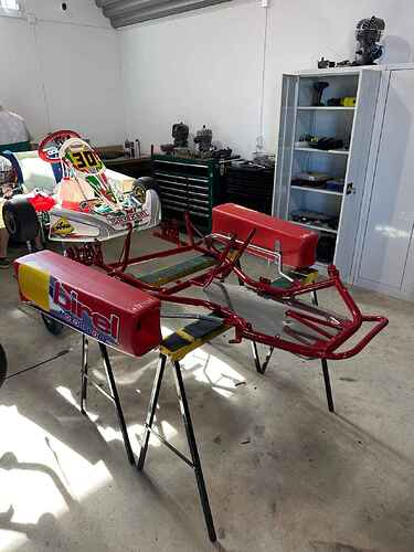

We have lots of stuff going on at the same time now, my friend is rebuilding a Birel. And myself bought a PCR engine yesterday also. I now own a Minarelli, Vortex and PCR😂
Beautiful, just beautiful!!
