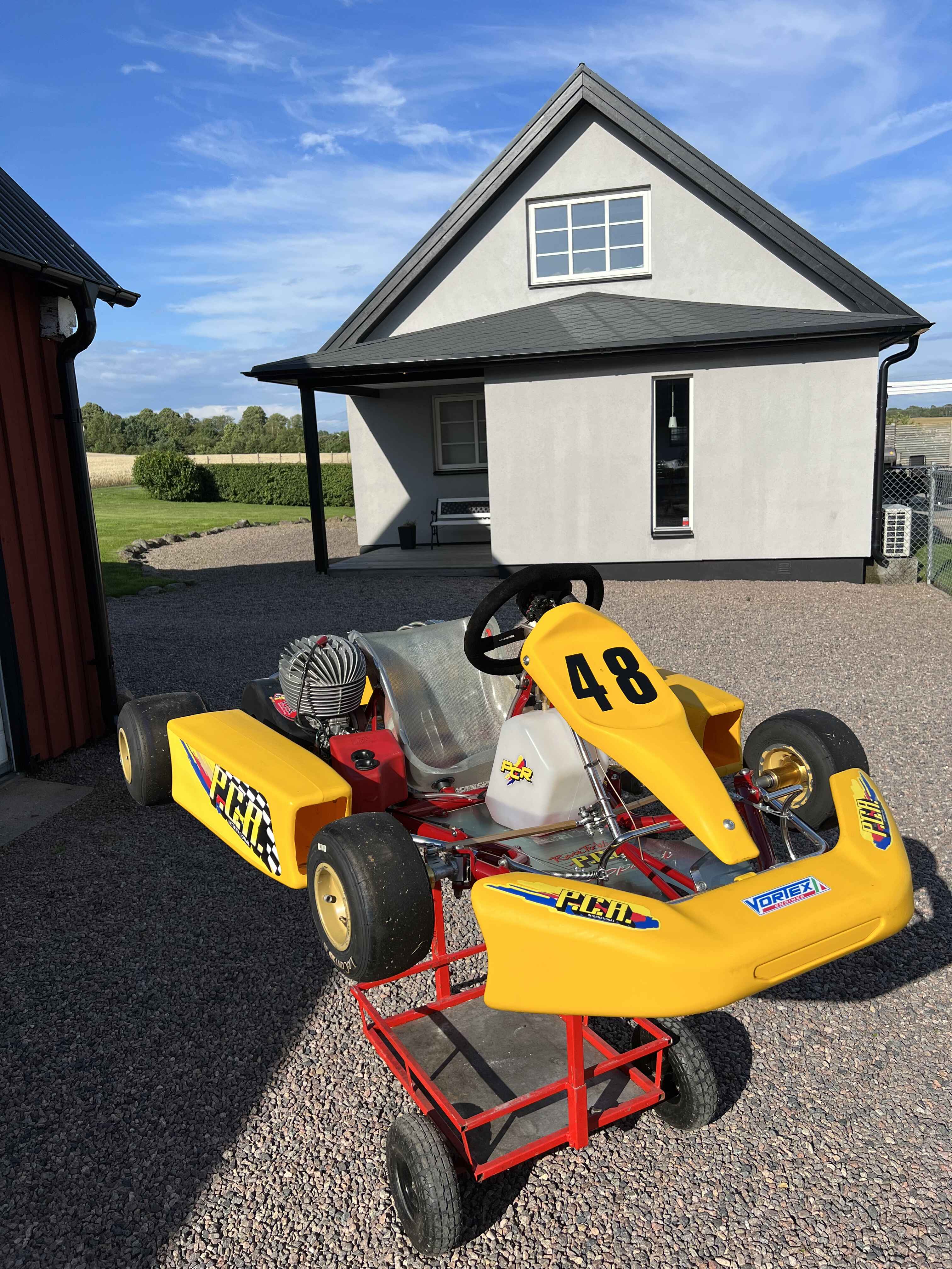

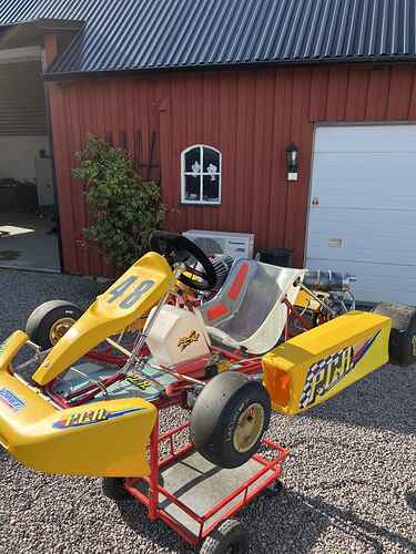

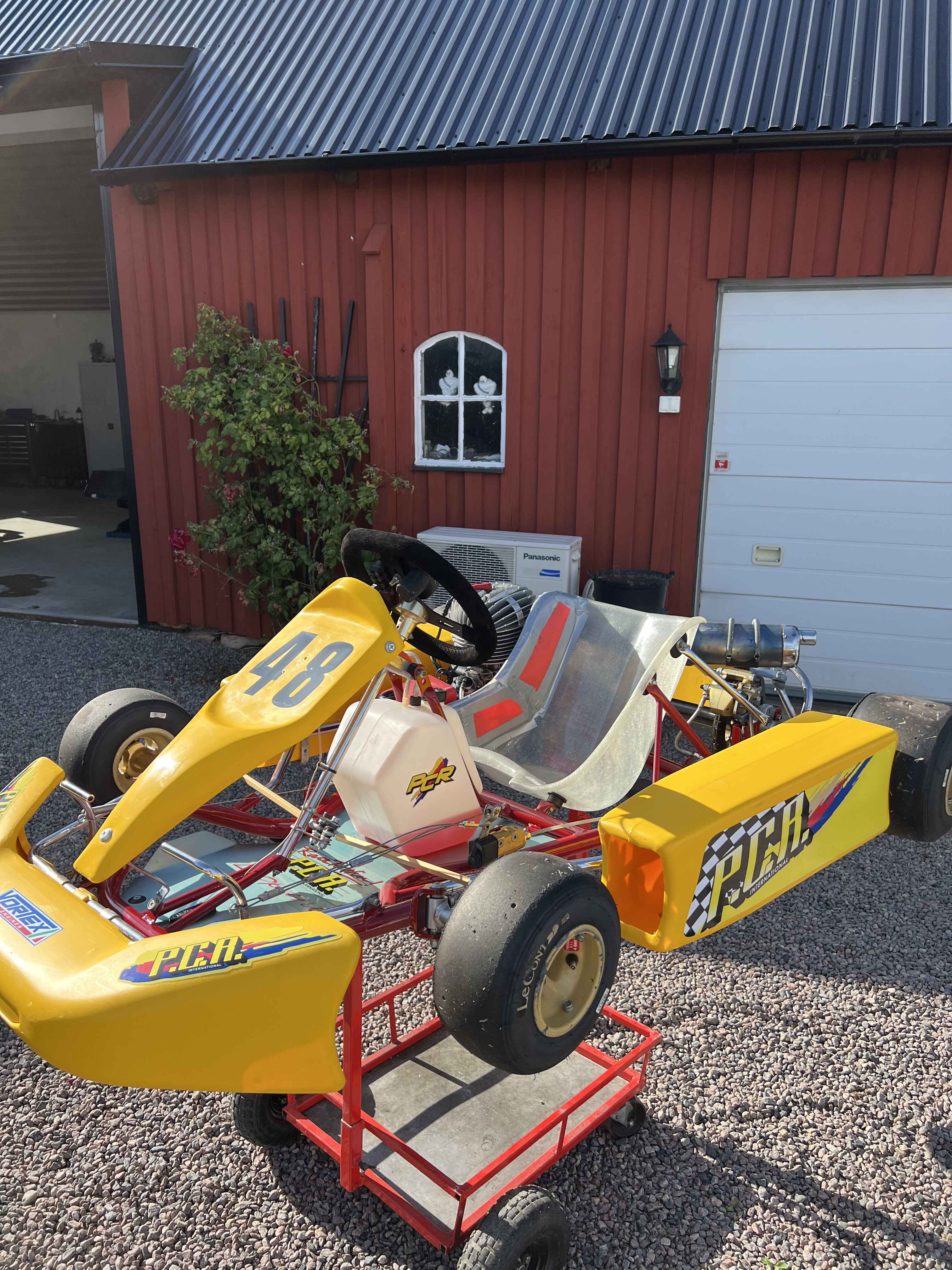

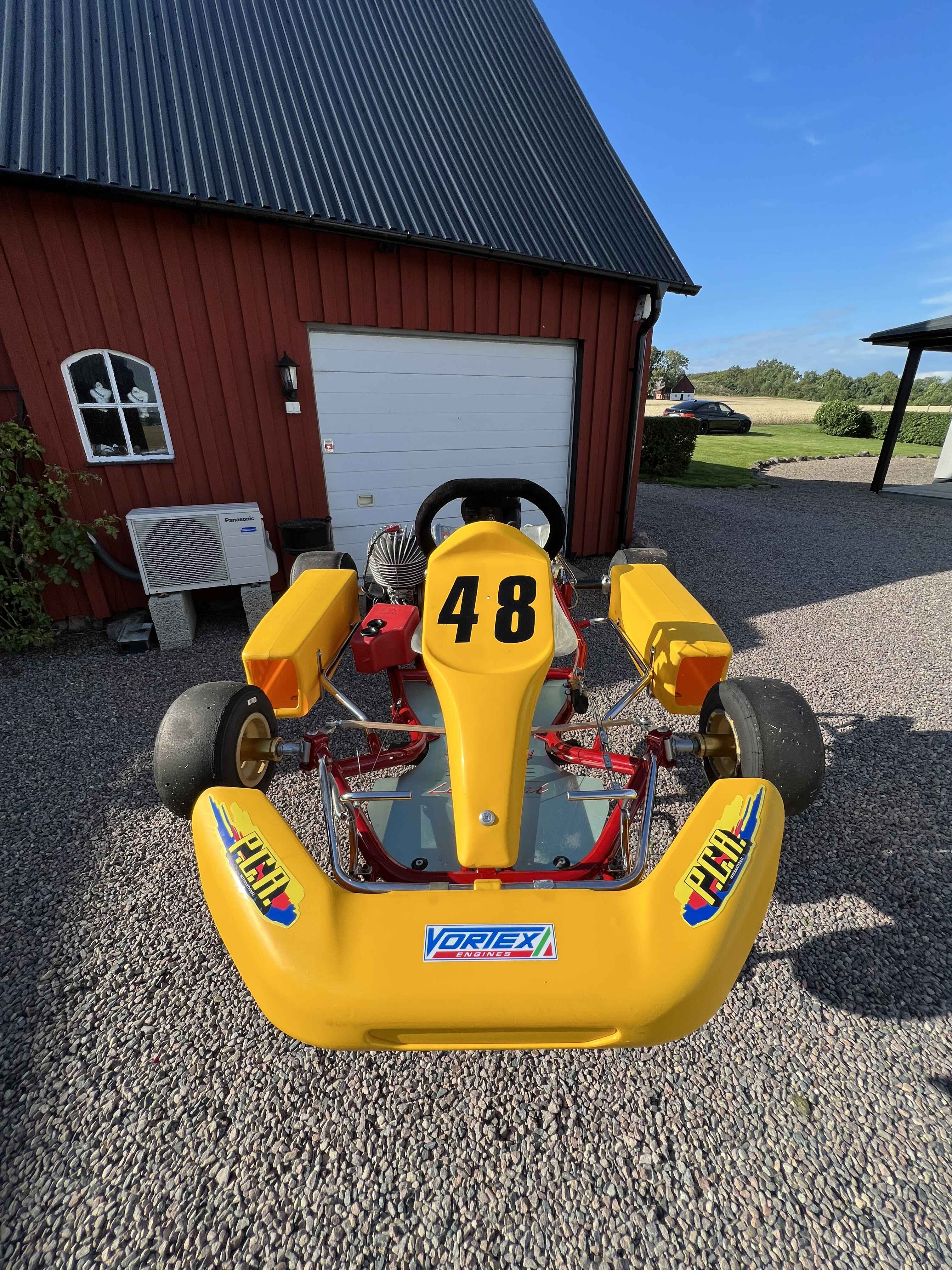

Finally, the old boy is assembled! Very pleased with how everything turned out. Nice bright red in the sun with lots of sparkling metallic in it. Bmw Melbourne Red actually :grin:
Brand new yellow fairing with new stickers🔥

looks great!
Thanks!

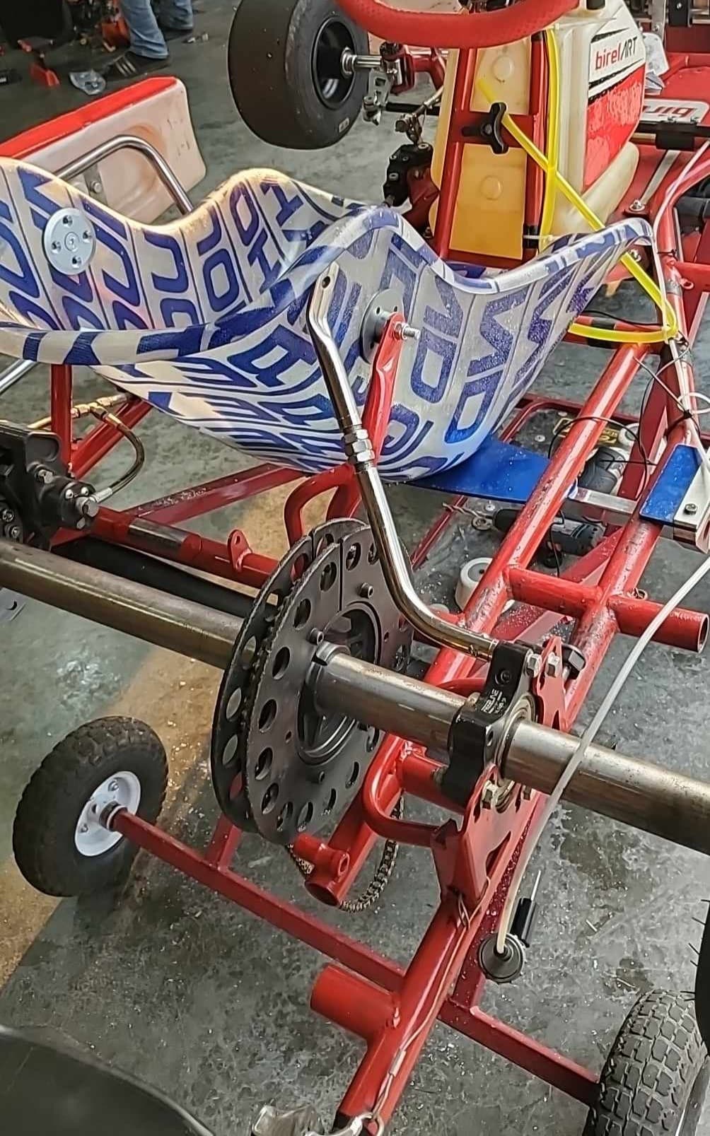

Last minute offer to run a friend’s chassis at the CKNA race at my home track this weekend resulted in me spending a couple hours installing this sexy Greyhound Racing Seats RS5 seat in a borrowed Birel AM29…
Engine is getting new valves and springs and a light touch on the seats tomorrow to finish prepping. :crossed_fingers:

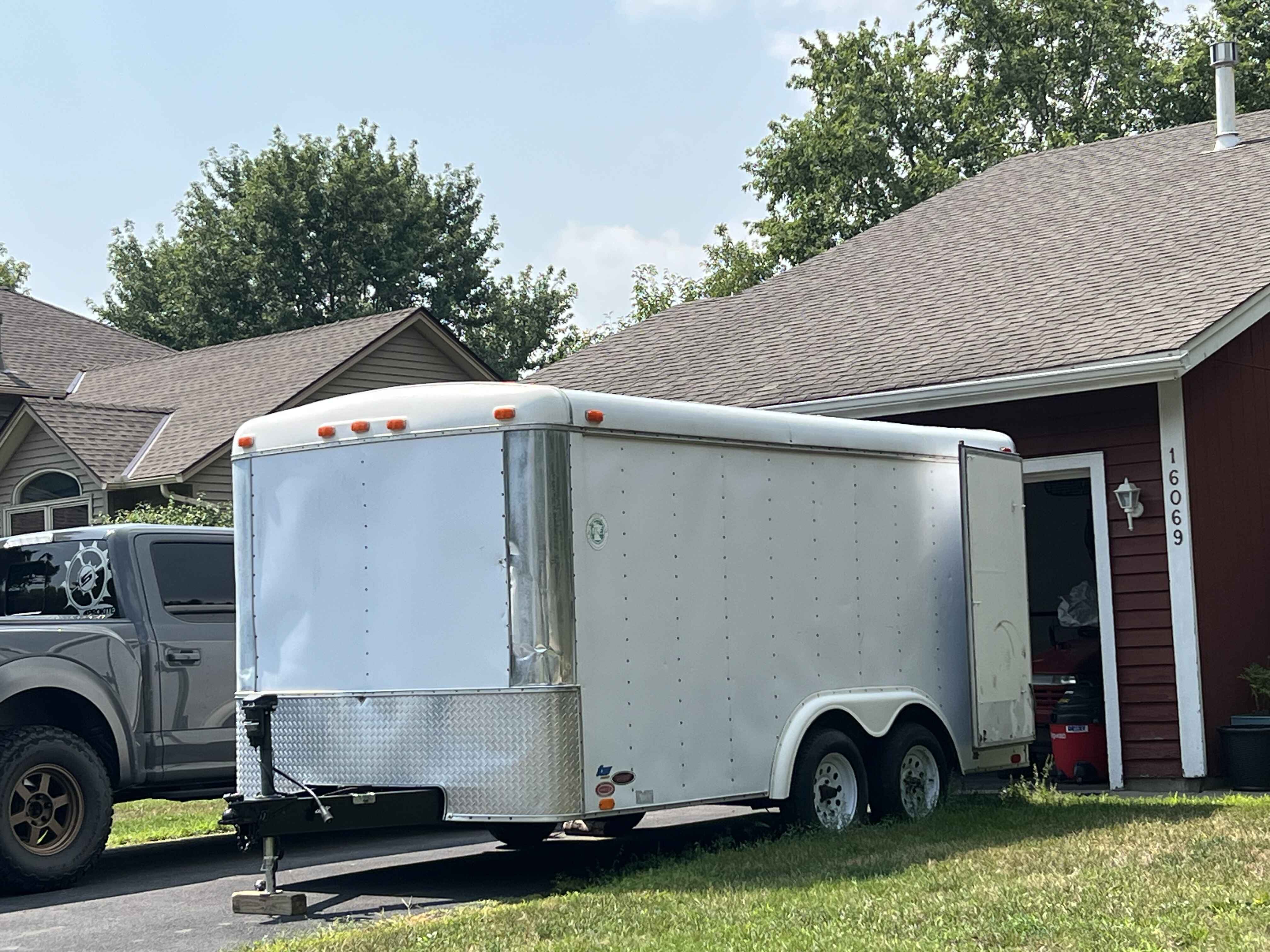

Also picked up a trailer…

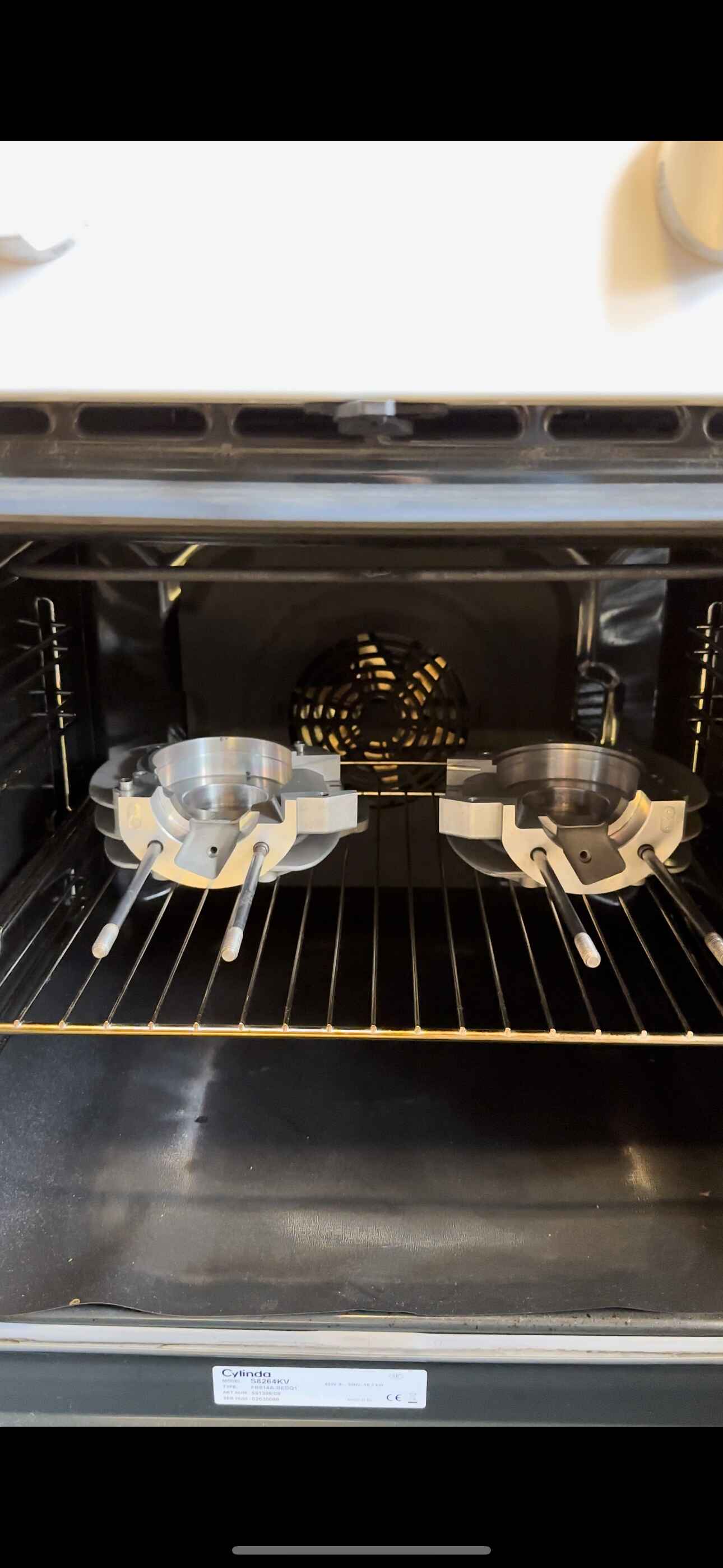

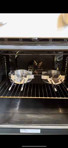

Today I installed crank bearing into the crank case of my PCR engine.
I was filming a step by step tutorial on how to do it, but I f*cked it all up in the end when taking the crank cases out of the oven😂 I got the bearing in slightly wrong so that I had to heat it all up again and do it all over again and forgot to video it…
But basically what you want to do is clean the halves thoroughly.
Put them in a cold oven and then put the oven on 140c to gradually heat them up so it doesn’t get warped.
Have an infrared temp gun available and measure the halves until they have reached 110-120c.
Then take the bearings from the freezer, take one halve out and just drop it straight in. Thermal expansion will do its magic!
Keep in mind that some engines run very tight tolerances so sometimes it is a one shot as the aluminum cools a lot faster than the bearings made out of steel.
And voila, no harm done and bearings installed

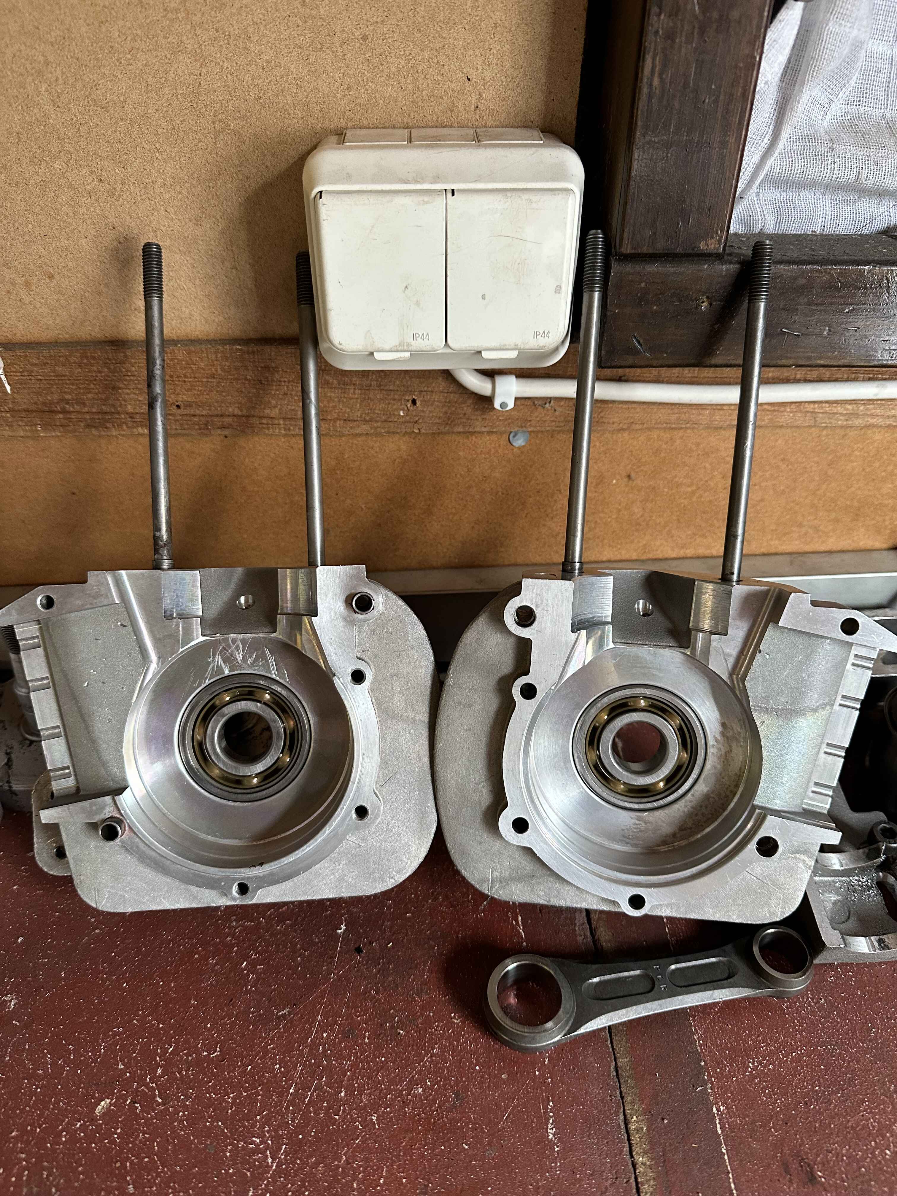

Hey Luca, what’s all the scratching in the left side near bearing? Is that ok?
I think it is from a previous seizing or the previous owner wasn’t to careful when I messed with it.
It is only surface scratches, so no harm ant all to run with. If it was chunks missing I would be worried😁
