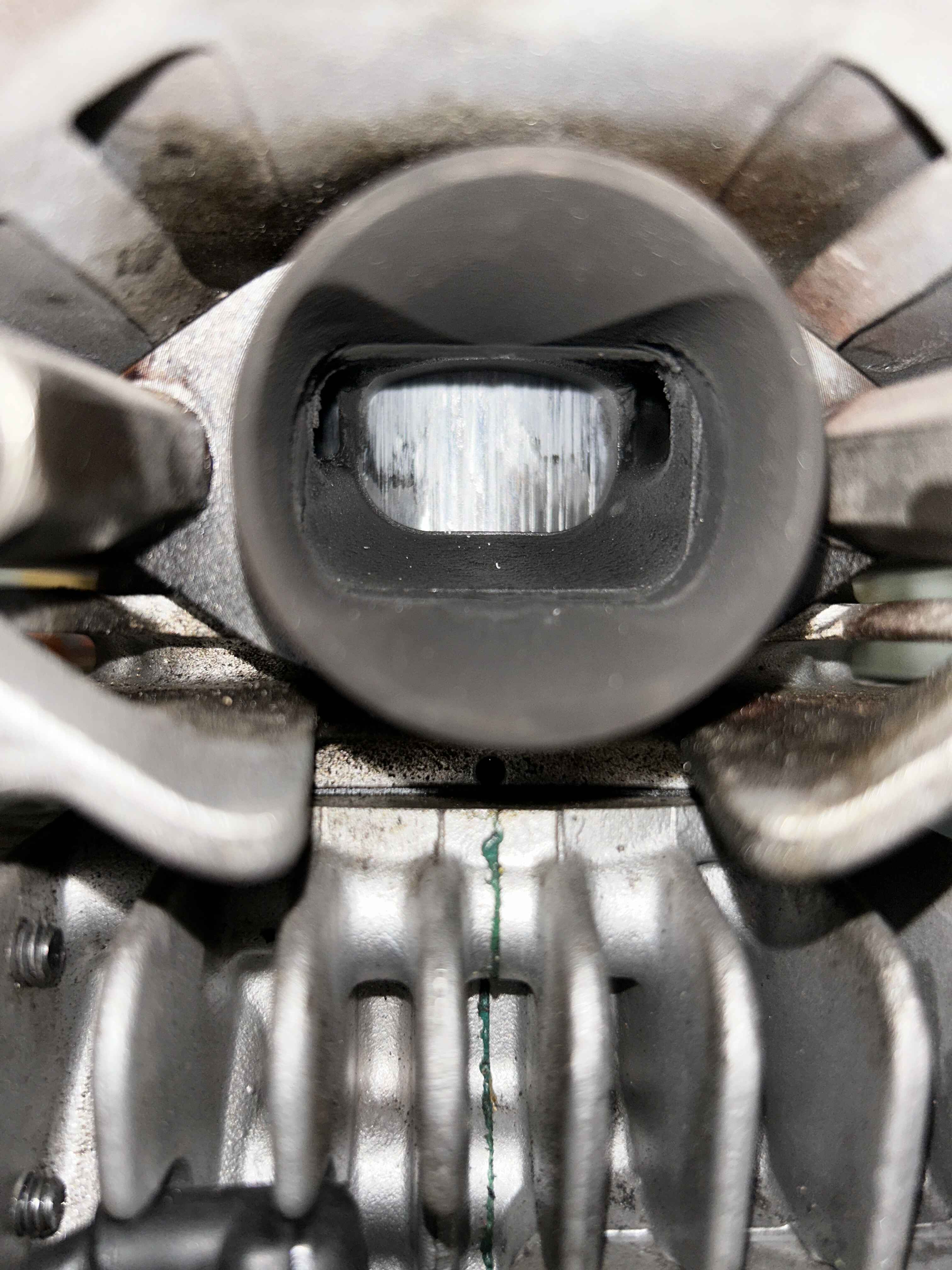

Was doing some driving, coaching, and lead-follow today and seized the engine. ![]()
Been a while (probably 5 years) since I last stuck one. Last I can remember was an X30 bottom end.
Bummer…any idea what failed? How many hours were on it?
I’m not sure yet but it had a good amount of time on it. Was due for a rebuild before Route 66 anyway. Gotta pull it off and inspect it this weekend.
x30 or ka100? 20 char
KA.
I think it was a bottom end seize but hard to say without tearing it down.
Bad but likely not catastrophic! Does the piston move at all?
I see you’re a welder now ![]()
Am I looking at a stuck piston through the piston port on side?
Yeah it freed up when it cooled down, I can turn the crank now. It was real stuck when I tried to re-fire to limp back to the pits.
I just wanted to tighten the tolerances a bit; it’s called “blueprinting”!
Yeah this is the piston through the exhaust port.
Dropping it off at Franklin this week for a rebuild and dyno break in before Route 66 next weekend.
