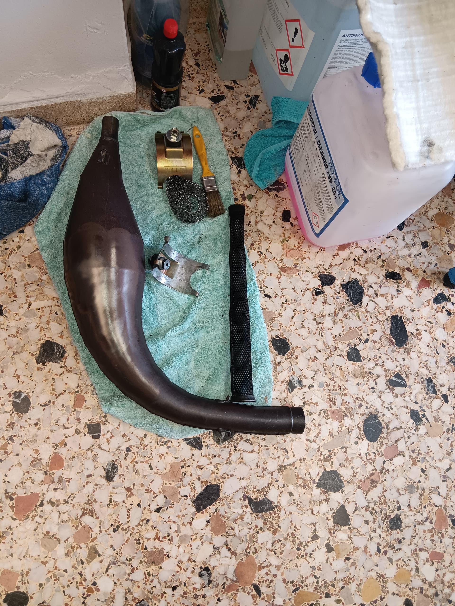

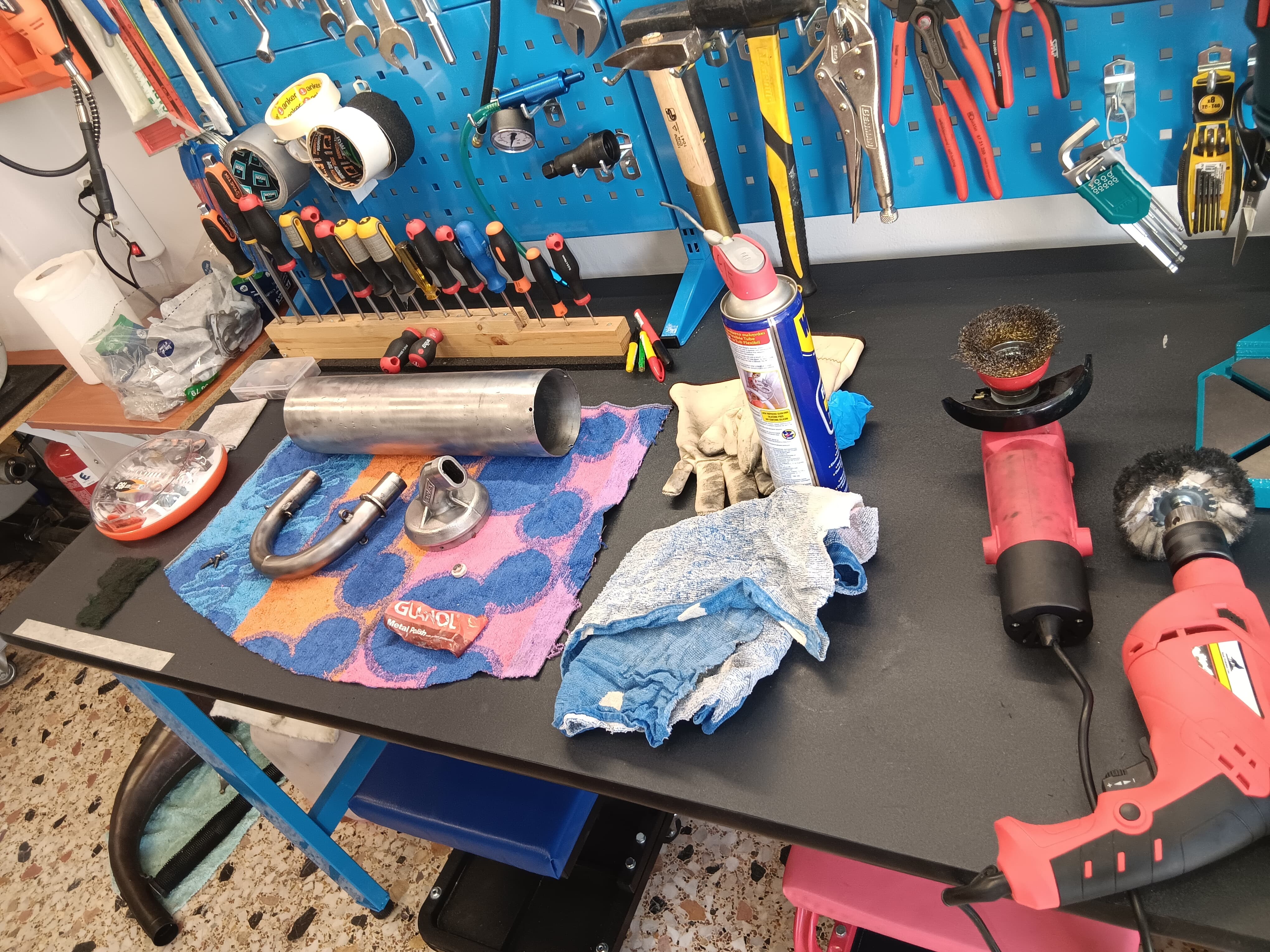

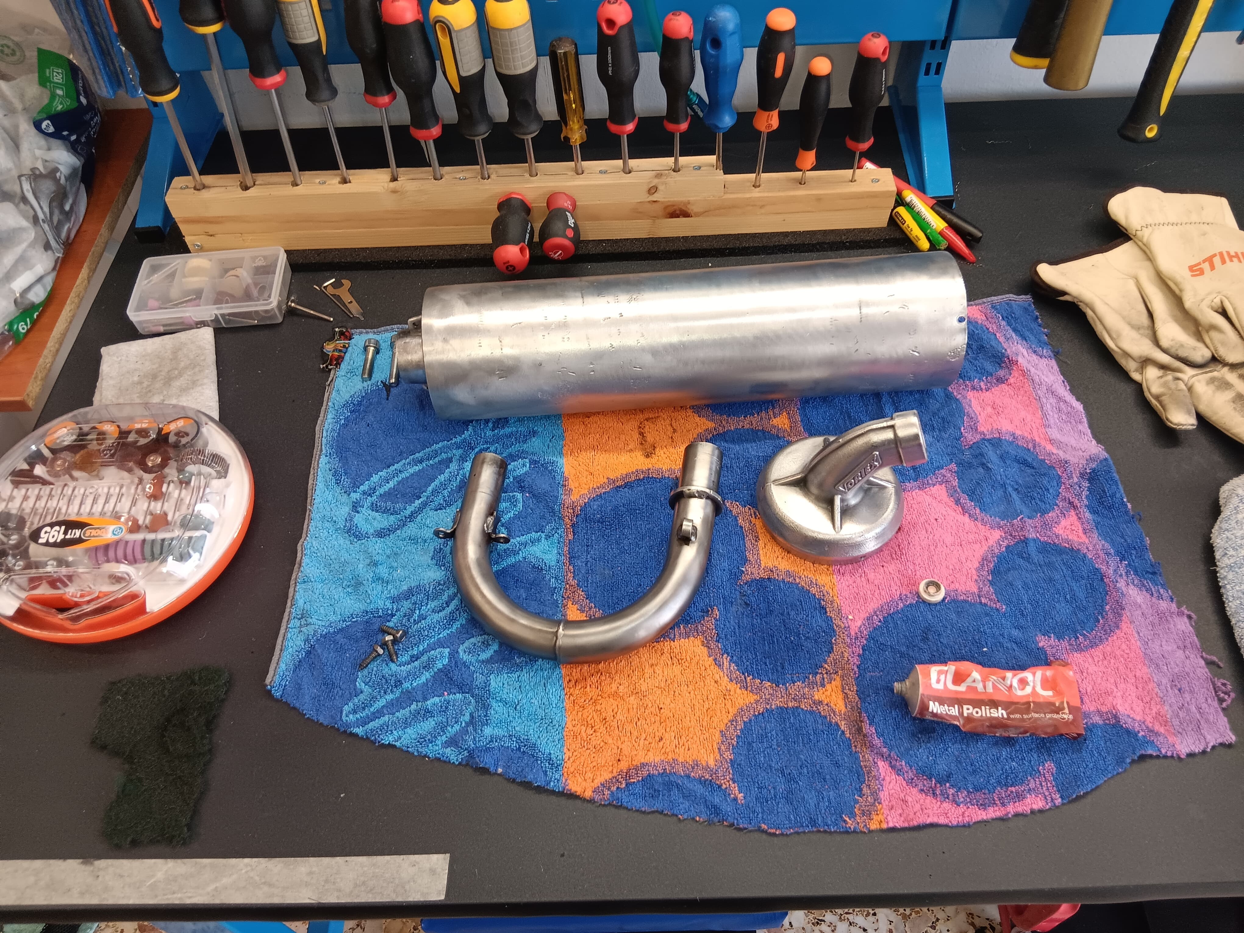

Maintenance of the exhaust system on the vortex rok engine . Also change the springs and the exhaust flange.
It was a surprise that i find that vortex rok has exhaust matting that you have to replace inside the exhausts tail pipe . I thought only rotax has that thing inside .
When the job gets done i will share just to sent joy on the other side of the Atlantic ocean .

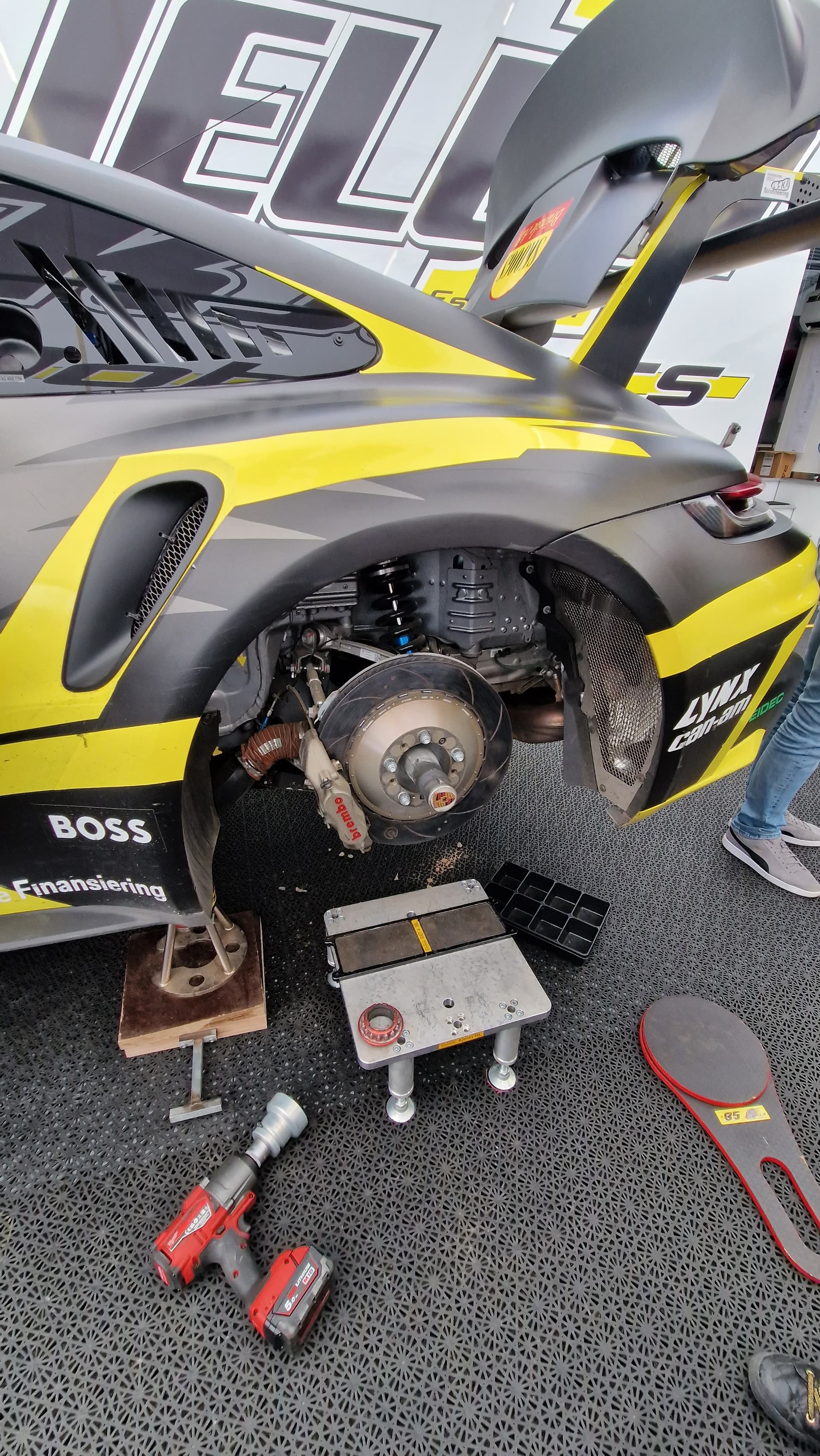

Long story short… carerra cup final in sweden. Hang out with swedish prince (security didnt let me take pic as i did last year) talking about my racing career with indy 500 world champion marcus eriksson. Sitting in a porshe cup car. (Team owned by a friend of my dad) and joined porsche parade with my dads porsche (he let me drive it)
Cool day! Seems like fun! Did you try the rig?

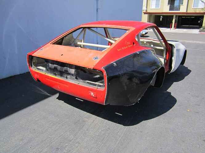

Nice Z car, do you race that too?
Never hit the track yet still in the process of putting it together my grandpa use to race one in gt2 at Laguna Seca, Sears Point and some other tracks back in the 80s. We hope to have it done by next spring. Gotta put the engine in all the plumbing etc.
https://youtu.be/4dUrJhkUjSw?si=PzlL0fQQOTwgv4AB This was his car at one point now on display at Z Car Garage.
https://www.zcarblog.com/2014/06/23/events/joel-anderson-datsun-z-car-racer.html
It will be my first experience in a car I can’t wait.
Awesome! What is your grandpas name? I grew up at Laguna & Sears point. For a time my parents with Chief and Assistant Chief of the Flag crew for the San Francisco region of the SCCA. I literally attended every driver school, regional, national and pro race at both tracks from the mid 70s to the mid 80s. My parents kept going long after that… my Dad worked his final race in 2018 at 85 yeas of age (Tech).
