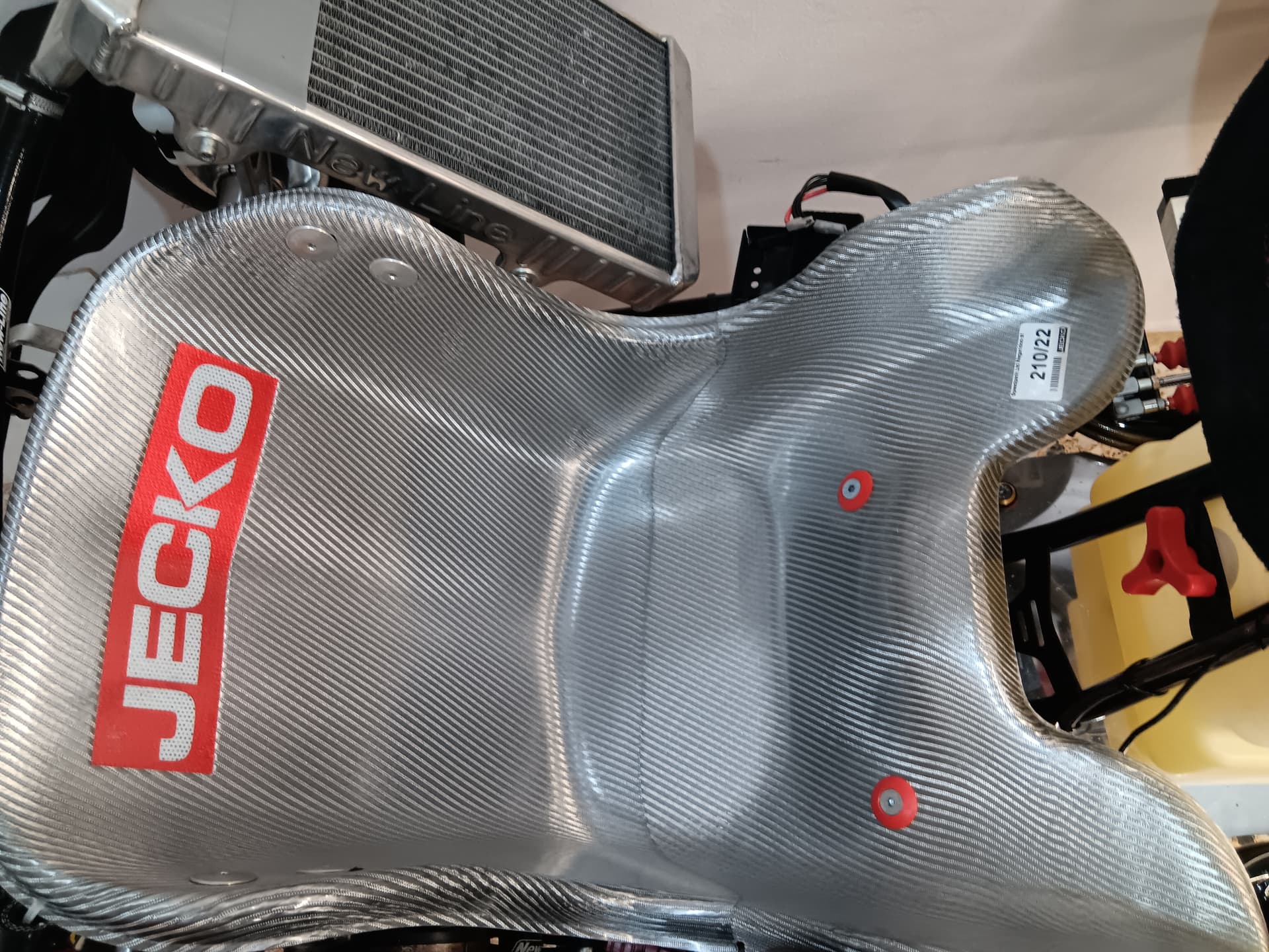

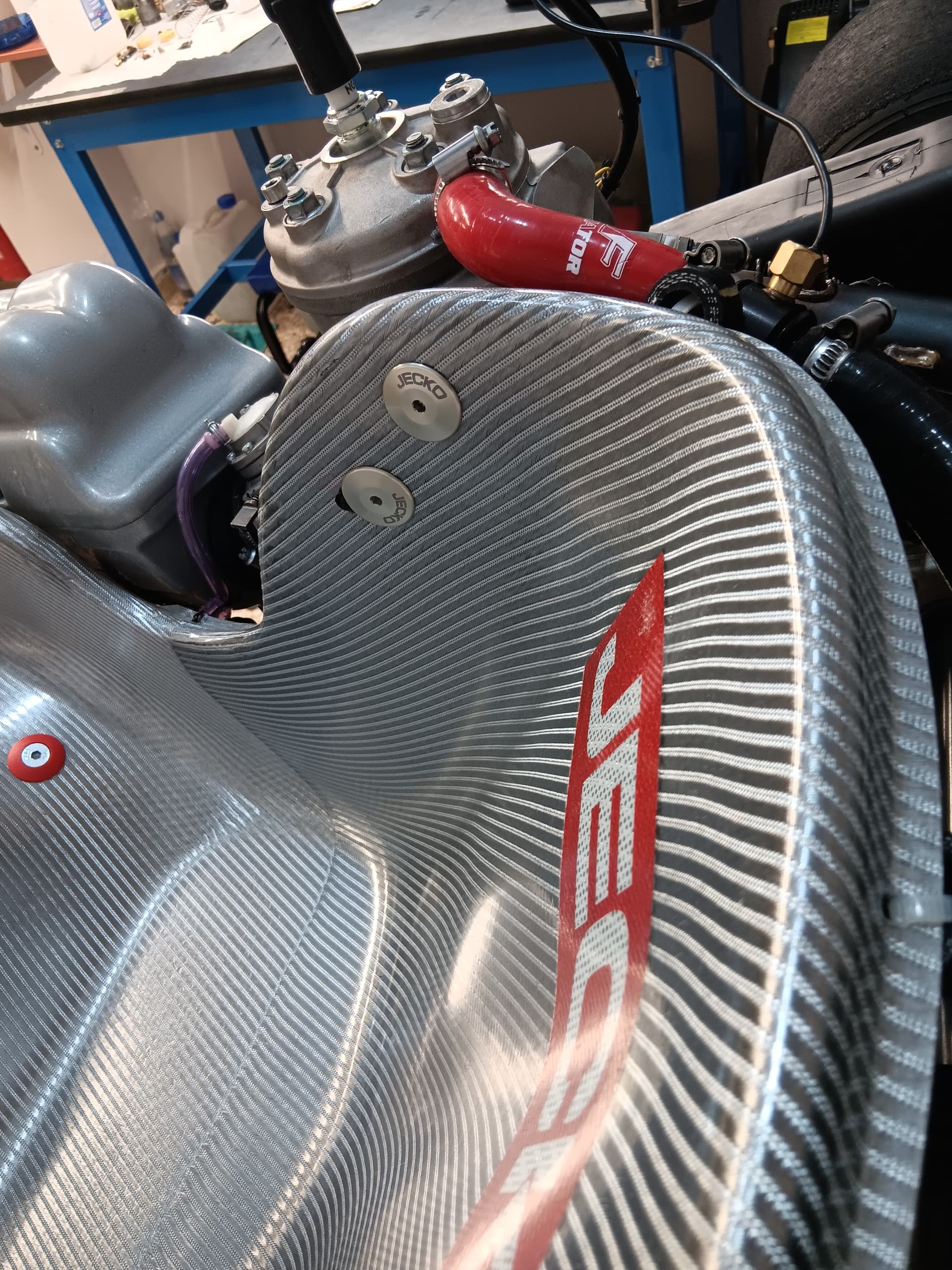

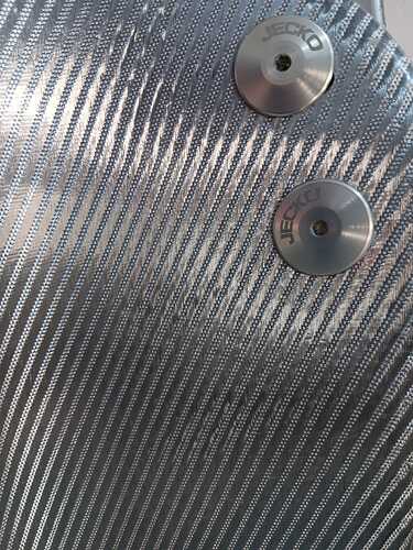

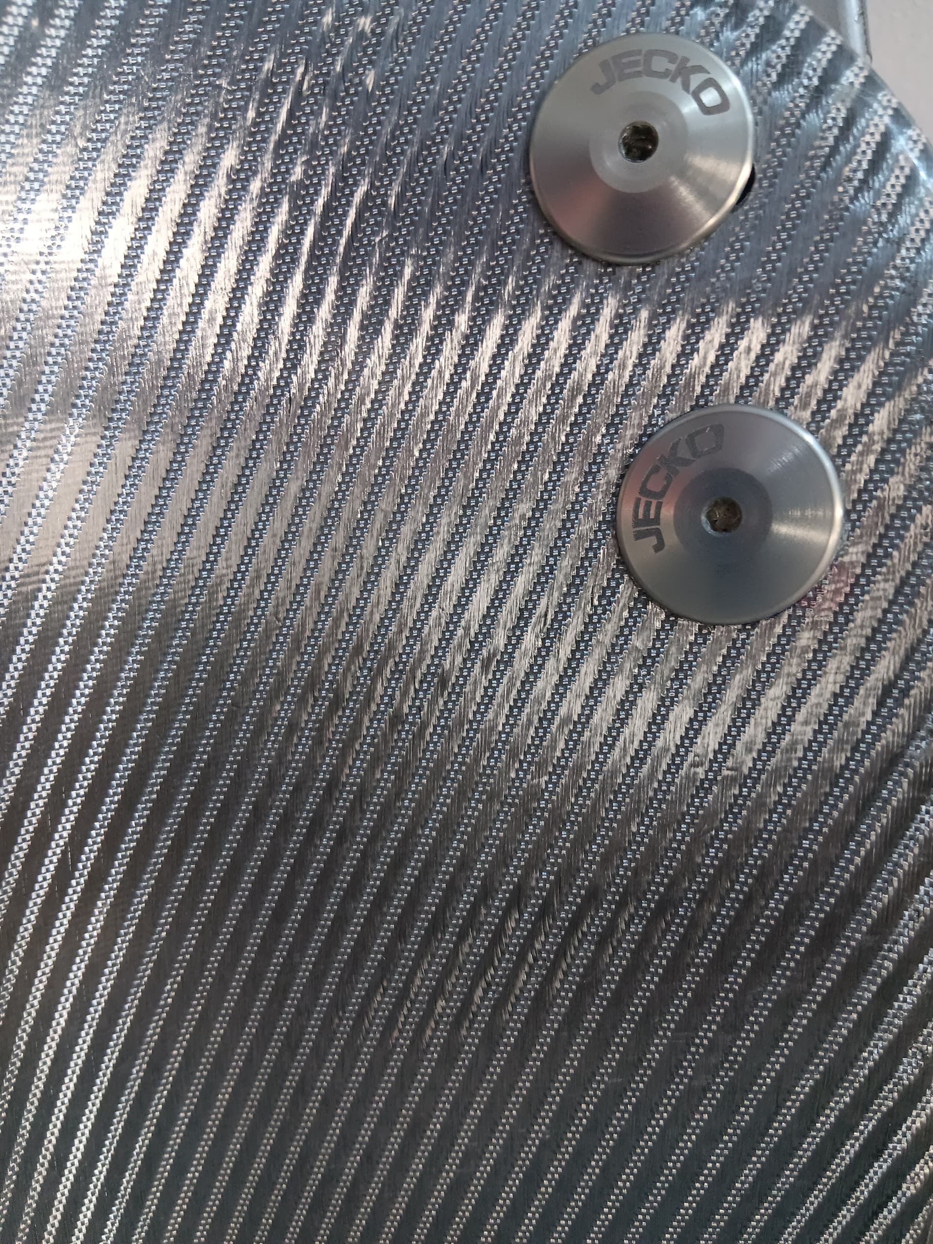

Changed from the usual seat bolts to the better and giving more clearance jecko ergal type bolts . They are a beauty yes !
Those remind me a bit of the ribtect flat kit.
IMG_9800
Those Ribtect ones are as flat as they come!
My go to (albeit not the lightest option) are 1/2" flat washers. The head of an 8mm flat head bolt rests nicely on them and sits very flat compared to standard conicals.
And, I bet they don’t cost $88 for the set. (No regrets, very high quality and re-useable).
That’s my credo!
Never, ever again will I use those bolts. Entirely too soft. My son stripped several when we were at the track making a seat and weight move this year. I managed to get them off, but they were not salvageable for re-use. Also had 1 bend on the seat. Haven’t bent any traditional socket flat head steel bolts, so that’s what I am sticking with.
Sure wish they had been more durable, they were so flush and comfortable for him in the seat.

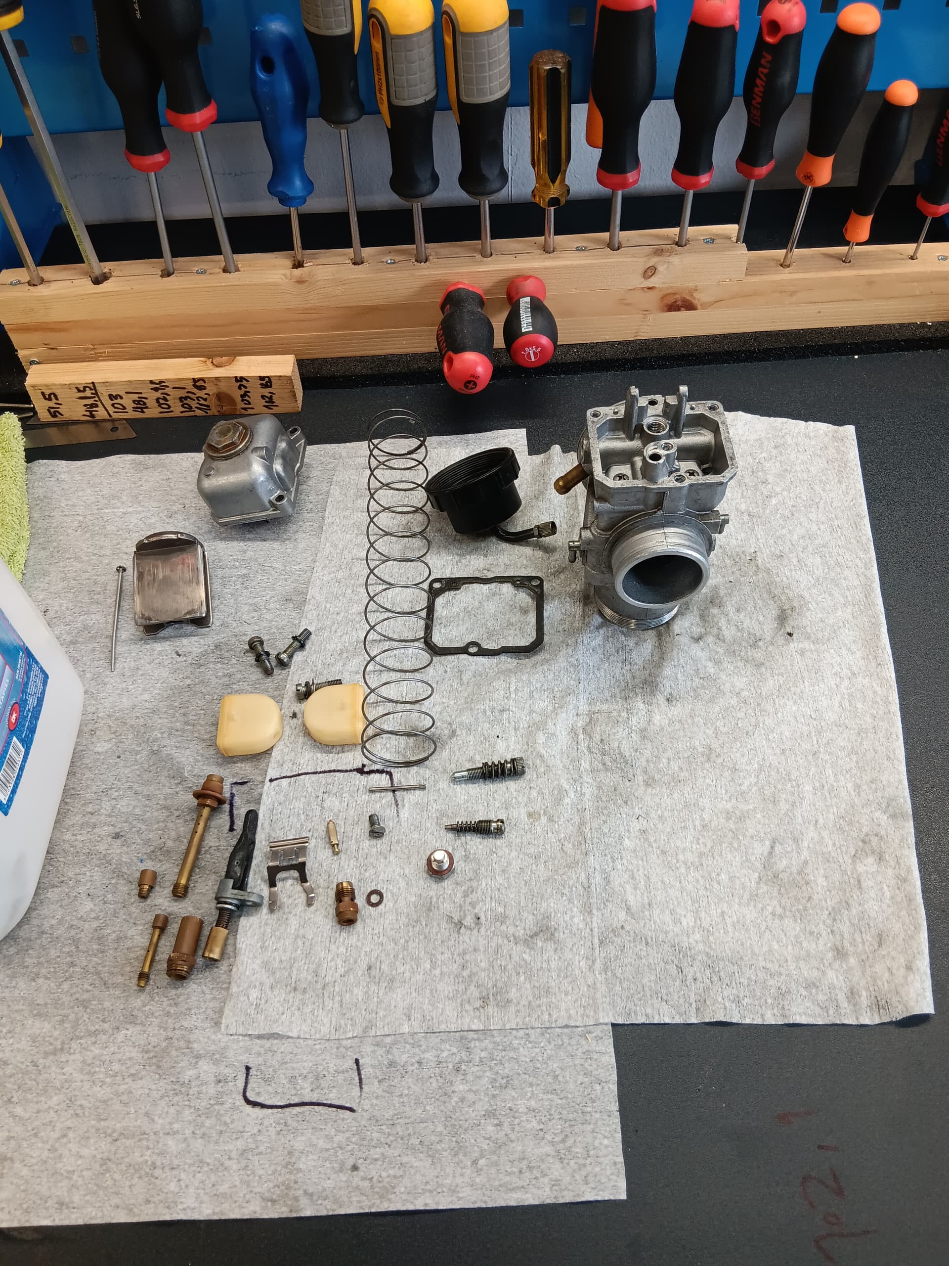

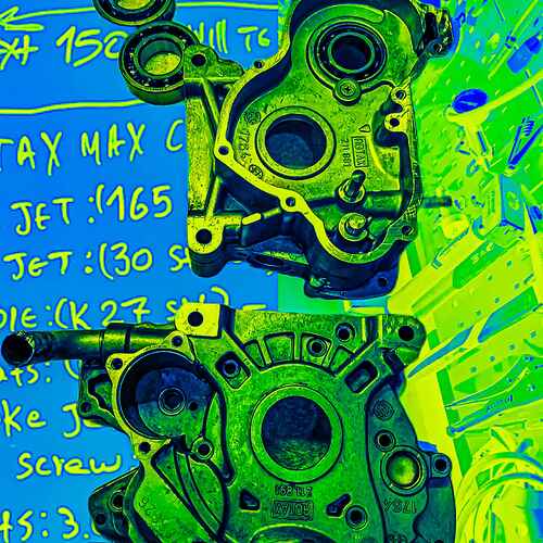

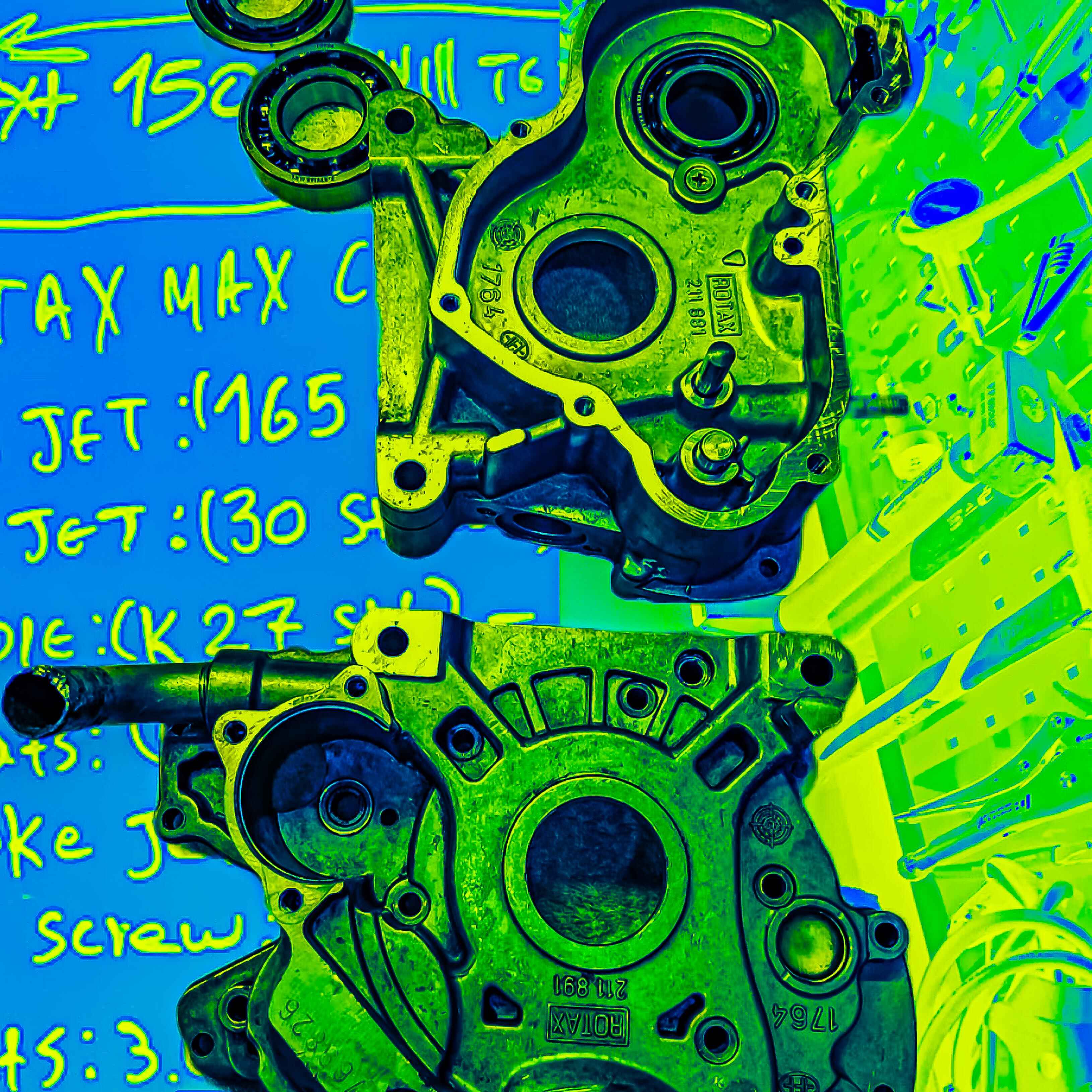

Carb day today . We will bring back on its baseline an old dellorto VHSB 36 for the pre evo rotax engine . And yes it has seen the napoleons wars in his prime as lukas would said .
We also get a wall board in the garage .
God i love them ! Smile :smiley:
Some assembly required…
Almost everything inside isnt in the correct size , exept the bowls and the atomizer . We will need new jets , needle , needle stopper , filter ,all gaskets .and a mixture bolt . The good thing is that dellorto parts are cheap enought to let me buy them , so now david its cleaning and wait for them …

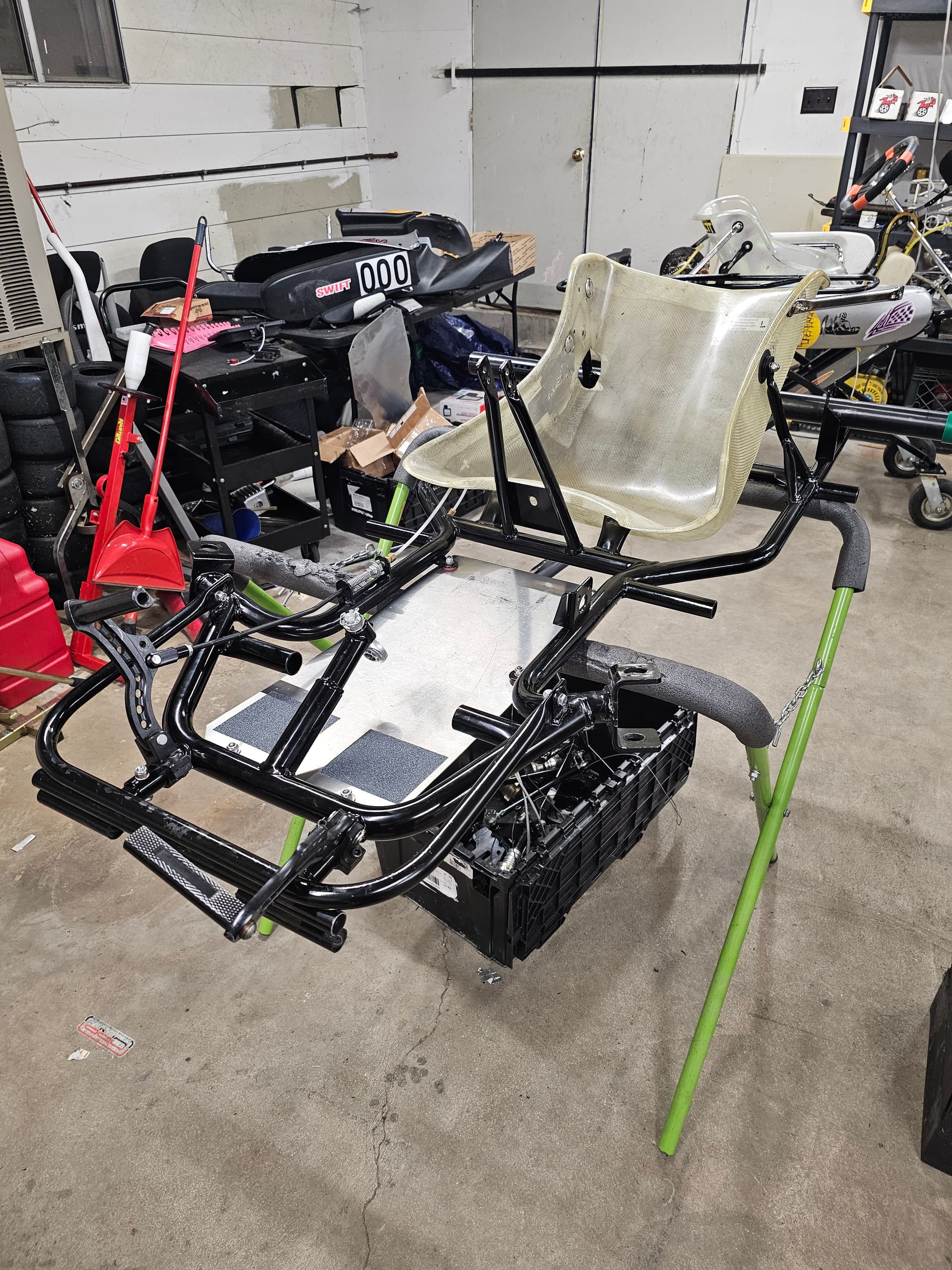

Put the floor pan and seat back in the kart tonight.
