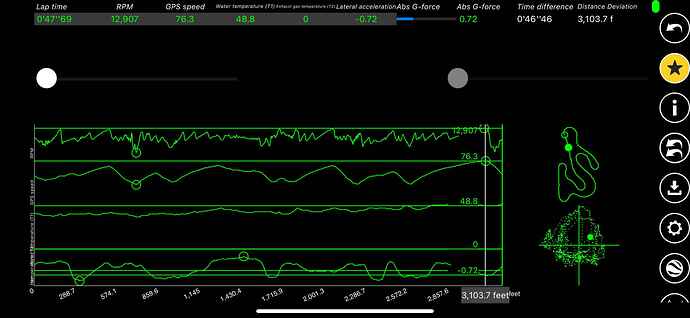

Tweaked the setup and drove my old shifter again at Orlando, and decided to do a 4 lap time attack a little later in the day like the old SKUSA qualifying. I was able to get a 47.69 and a 47.68 back to back on lap 3 and 4. I was on MG yellows from 4 months ago (not the new compound from what I understand). The laps in the video are low 48’s on worn tires during my first session.
