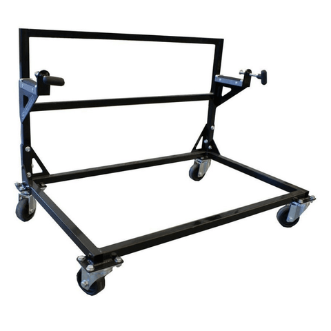

I would echo this. I have seen these and for a manual stand they are nice. They are pricy but well designed. You still have to lift your kart but you lift up the front and pivot on the rear bumper, so it actually easier than a team lift on a non tilting stand.
yes the Stone stands are really well made. They ride over the bumpy pit/paddock area well too.

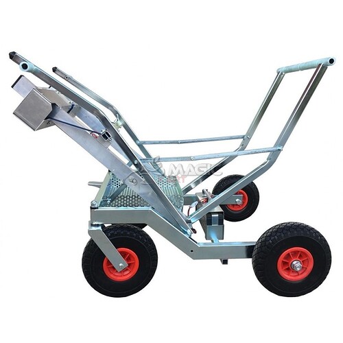

Can’t go wrong with an electric Streeter or Kartlift.
I have the Kartlift, and its cool, but its alot more flimsy than the Streeter. Tubing is aluminum and prone to warping. Streeter appears to be metal.

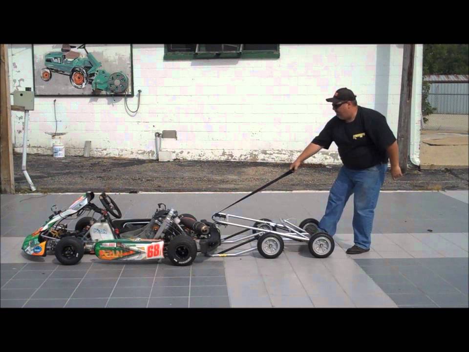

KartLift makes great powered stands and used to make the excellent “manual” kart stand as well:
If you could find one of those used it might be a great deal. Otherwise one of their WinchLifts would be great for heavier karts. Obviously I got quite a bit of use out of all of them, and with any of the stands, hiking up a really heavy kart is pretty easy.

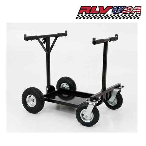

Standard stand: RLV Heavy Duty
RLV_Heavy_Duty_Stand_Main_PointKarting.com_480x

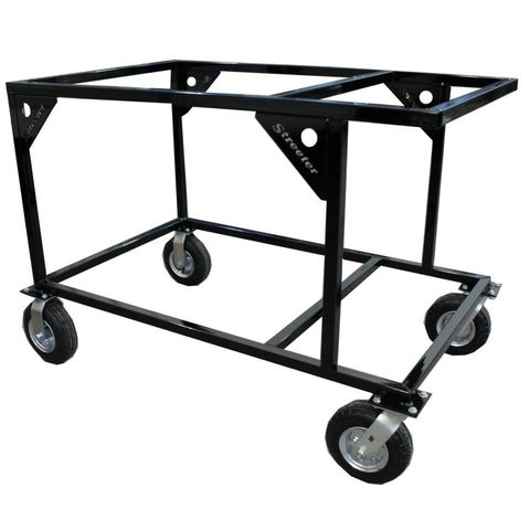

Stacker: Streeter Double/triple
Streeter-Kart-Stacker-Stand-Double_f72fa737-f56b-4d3b-be59-6a1b0ea18d2e_480x

I used to have one of these Stone Kart stands. They work well for a single person to use as long as you are on COMPLETELY flat and level pavement.
If the pavement is uneven then in can become difficult to hold the front of your kart up with one hand, while trying to align the stand and roll it under the kart with your other hand. It can also be difficult to do this if you are tired and worn out after a long day of driving.
When I bought the Stone Kart stand I was tight on cash and didn’t want to shell out all the money for one of the electric stands. When I get a new single person kart stand next time I will get an electric one for sure.
The Stone Kart stand is a good value. It is lightweight and well built. As long as you are on level pavement it works fairly well. However if you’re not on level pavement, or if you’re tired, then it can be tough to use on your own.
I have a Dalmi bigfoot & really like it. Chassis sits flat, engages the frame tubes instead of bumper (no hooks), under tool tray, aluminum construction makes it fairly light weight. Caveat is that the electric stands have all nearly doubled in price now. But if you have the means, it’s a nice - really nice - stand that makes karting life easier.

About how heavy is it? One of the things I never understood about some of the electric stands is this: “Sure now I can lift my kart by myself. Except the stand weighs 100 pounds so now I can’t lift the stand by myself.” I have never understood that :grin:
66#. Not too bad. The batteries reside in a removable tray. Just unplug & lift the tray out before packing it. Removes some weight.
