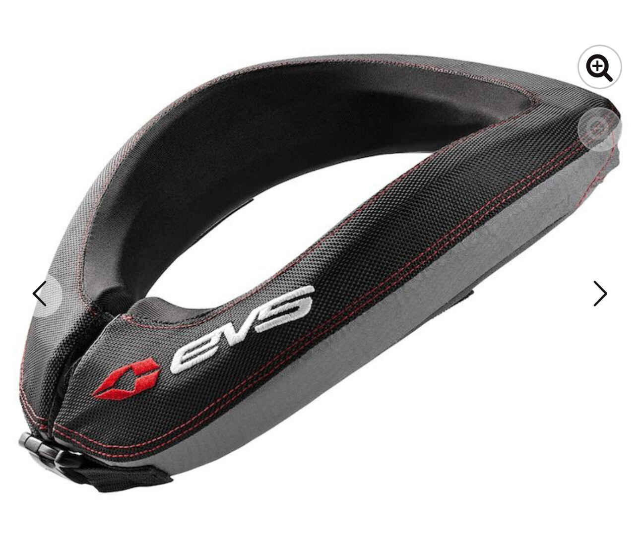

I had earlier bought a Sparco neck brave, which is just a large ring. But when I around around, I saw other kinds of neck braces. E.g. the EVS. And I can’t find much that says which is better.
So- Is a more complicated neck brave like the EVS a better purchase for me? Or would the Sparco ring still work.

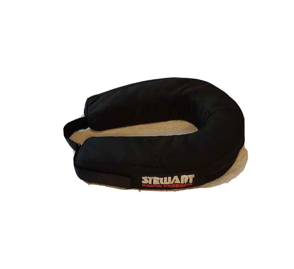

I am using an old Stewart brand formed foam U with most of the foam removed…There is no spec, so they can’t tell me that my mostly fabric visual aid is non-compliant…and there’s just enough foam there that I think it will marginally help in a flip.
I have raced with the EVS pictured above, and it’s also fine. Just heavier and notice it more while driving if it bounces. I use that one while riding dirtbikes…
