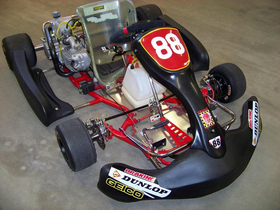

If I was going to try to find a 4 cycle motor, I’d go along the lines of the Honda horizontals, and there’s currently a Daytona 190 shifter group… the Cg is lower, and the power seems reasonable. No idea on what the rebuild intervals end up being. Also unsure on how much power the 2v gives up vs. the 4v Anima, but seems to be quite a bit… At least there’s lots of Chinese support (read: parts availability, albeit of wildly varying specs.)
https://www.facebook.com/groups/4z190shifterkart/
ooohhhh….those could be lots of fun.
