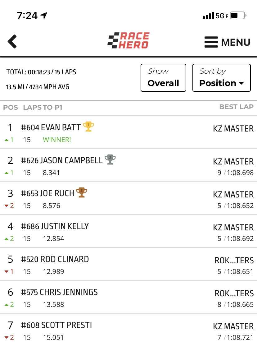

Coming back to my earlier reply on this topic, I was able to use an HMG Kart (made my Factory Kart) at the first round of the Stars Championship Series at NCMP. We had a stacked field with nearly 20 drivers in KZ Masters, and 27 in overall Masters Shifter (includes Rok).
My only complaint is that I had to readjust the shift lever due to the rose joints being slightly out of alignment and putting it in a bind. Quick and easy fix. Really enjoyed the chassis, and was able to bring home a commanding win in the main on Sunday.
The kart is tremendously easy to drive, meaning it is responsive and goes where you want it to, but also physically much easier to drive than other karts I’ve been on recently. We started out the weekend on the setup that I tested a few weeks ago, and made a few changes throughout the weekend, basically converging on a box stock setup for the final on Sunday. Only time we went the wrong direction on setup was trying a Hard axle for the pre-final. Here was my setup from the event for anyone who is curious:

Congrats! 8s is indeed a commanding lead.
