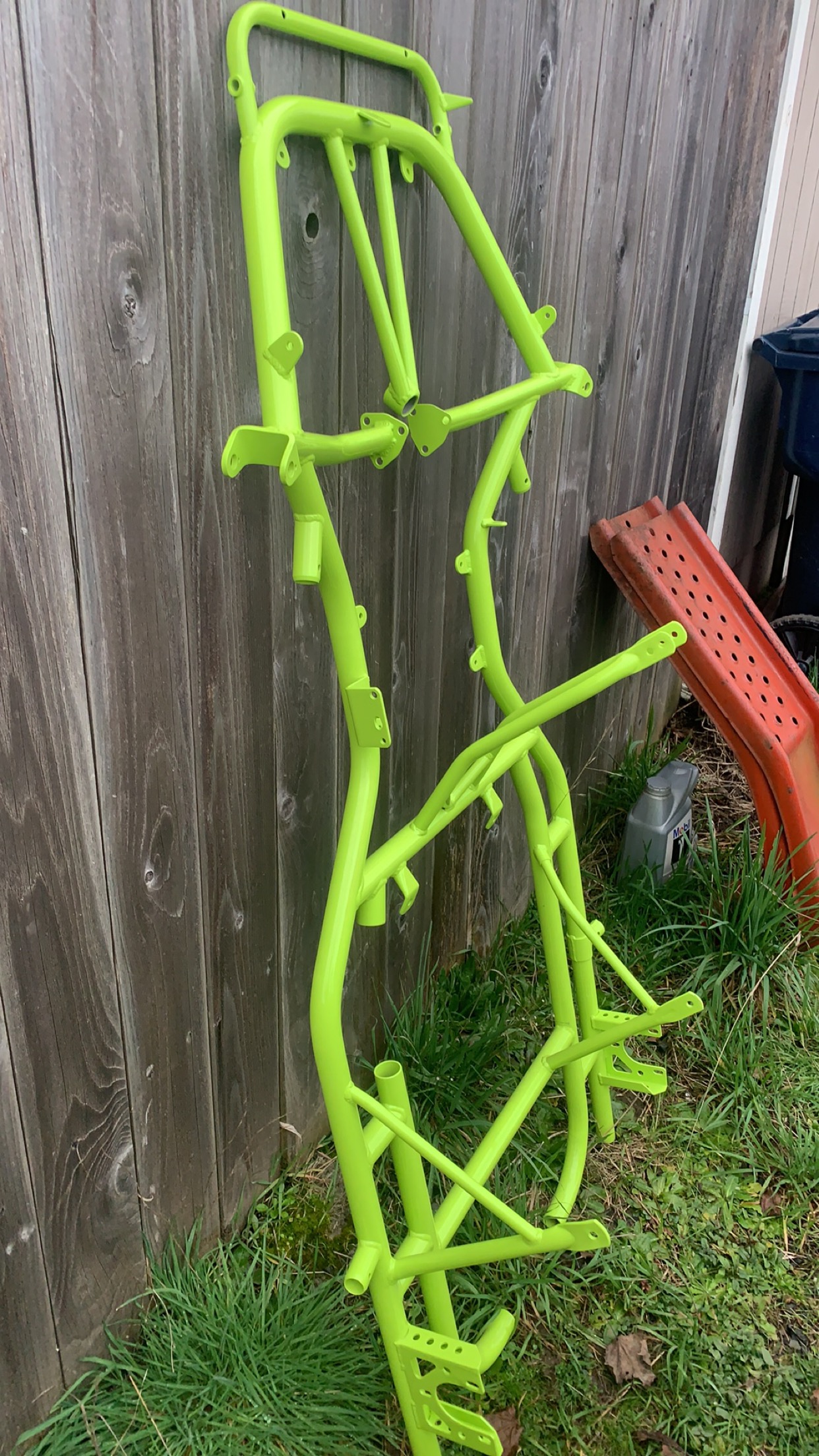

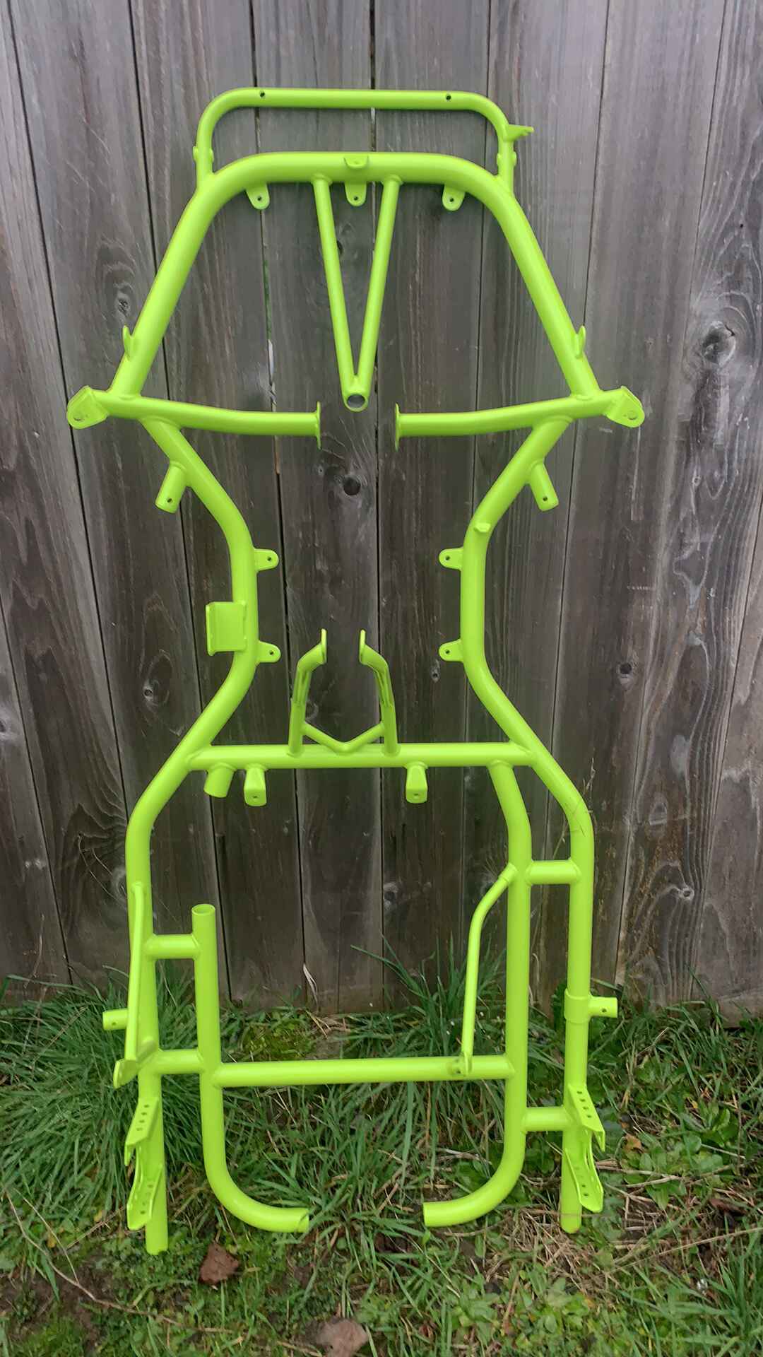

Maybe you mean longitudinally (ie front to rear)?
I’m not sure how much difference it really made… I can’t imagine it would add a lot of F/R stiffness\rigidity.
I doubt its a patent issue.
More likely they didn’t see a benefit or the addition hit their bottom line more than they wanted.
Yes, that is what I was getting at. I really doubt as well that there is much flex in that direction. I wondered what those tabs were for, at least I know now. :slight_smile:
Theoretically, since the chassis “waist” is the narrowest segment, it would be relatively more inclined to flex there, even in that plane. The mystery is how much, & what effect - if any - does it have?

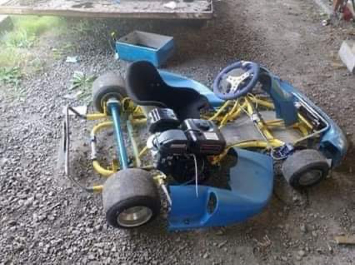

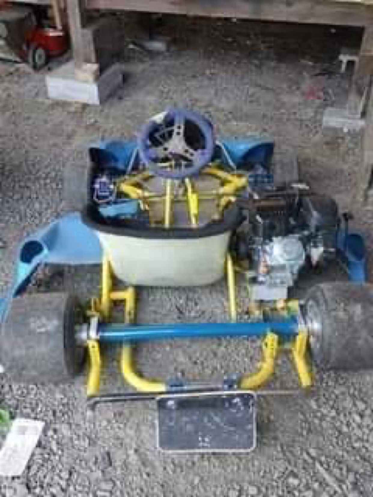

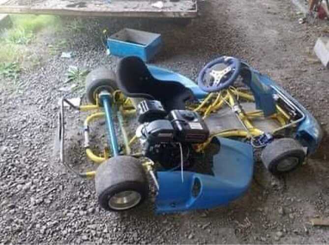

I’ve made a few posts trying to find out what kart I had, but no luck yet. Looks pretty vintage and I just picked it up. Let me know what you guys think
My eyes are getting so bad, is that a floor tank I see There in the front of the kart? It lookks somewhat like one I made for the Emmic kart. A real close up would help. Hard to tell who’s kart it is, mid-70s there were a lot of copycats. lol

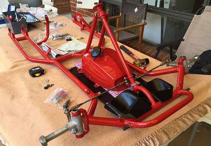

I wonder who was the first to do what I consider the now standard design.images
The only change since early 2000s was removal of 4th rail and additional width of the chassis overall.
I think it was in 1969, Richard Burton imported a Zip chassis. In those days they used brazing rod, and they didn’t hold up very well, so Richard talked Gary Nelson into building a copy. Thus the Invader kart was born. 2 or 3 years after that, being very unhappy with my Margay, I built a kart, I called it the Mayko Shark.
Tecno Piuma 1963 I woulda thought - How much pleasure can a Tecno Piuma bring? | Kart News

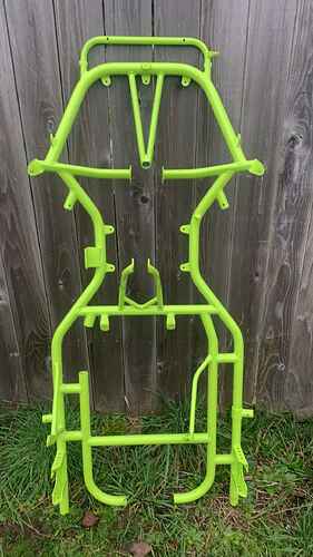

Any ideas? Someone I know from autocross just bought this and payed way too much for it in my opinion considering the seller sold every component on it first. And cut the 3rd bearing hanger off based on other pictures he sent me from before it was powdercoated.
