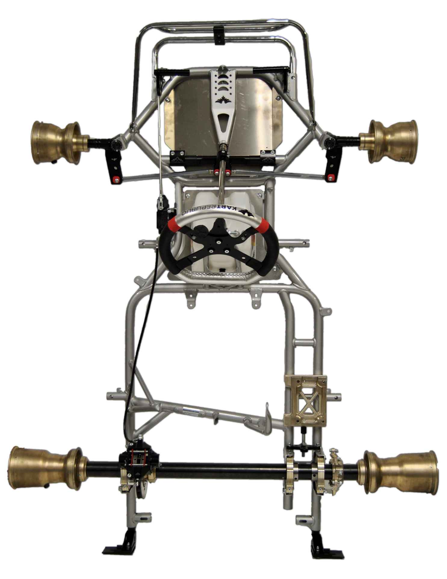

I think an interesting thing they have is that the Kart Republic website says the karts have an adjustable wheelbase. I’ve seen that on one other frame, a Birel 4 stroke chassis. The other thing that sticks out is the KR3. It’s got 3 different sections to the frame, a front loop, center connection, and a rear horseshoe type shape. I would think it allows for different stiffness of tubing along the frame, but they haven’t run it in competition yet.

Kart Republic is manufactured by a race car component manufacturer (Breda Racing SRL). I’ve noticed some components look bespoke (the caster/camber kits) while other look like they are off the shelf, maybe Parolin (stub axles, pedals).
Only based on my viewing of photos, I’ve haven’t seen the KR3 run yet which is a little disappointing. The other two are probably just zanardi karts with more expensive tubing.
Supposedly Travisanutto was on the KR3 this past weekend. They said it was more suited to low-horsepower applications, but they were testing it out there in X30.

The ART had the adjustable wheelbase when I drove for them, which is a nice little feature to completely change the balance of the kart. Not a totally uncommon adjustment.

Does anyone here have experience with both KR and OTK? Just since it never hurts to know what’s out there- I’m curious how they compare in terms of how easy they are to tune, how well they work for tall vs short drivers, frame stiffness, driveability, etc.
We had Ramsey on the KR and OTK at different times during the season a couple years ago. He said both were good, though they tune very differently.
If you look at the KR or WPK karts now, they are running those things like noodles. No seat struts, no bars, soft seats… Different philosophy than the OTK for sure.
