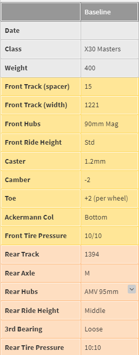

Having run a KR on 3 race weekends now, here is the baseline setup that I found to be good. I would be interested to see how this compares to what others are using as a baseline.
Series: USPKS
Tires: MG Yellows
Class: X30 Masters
A couple of points:
  • I settled on this baseline mostly from the input from the KR experts and the fact that it felt great at NJMP (testing) and GoPro (race weekend) with this set-up on the kart.
  • I run AMV 58mm PCD wheels/hubs instead of the stock AMV KR 69mm. Why? I found no difference in lap times/feel/performance and, as the AMV importer, I have a lot more 58mm PCD wheels than 69mm wheels. My baseline wheel is the AMV 3F.
  • I initially ran the kart with a lot more caster and positive camber – me no likey
  • I need to test ride height more. I stayed with the standard ride height this past weekend. I played with it previously but need to try it more.
  • Lead ballast - I moved some weight off the seat back and moved it to the left side of the seat. Not sure of the impact as I did this at the same time as the front-end adjustments.
