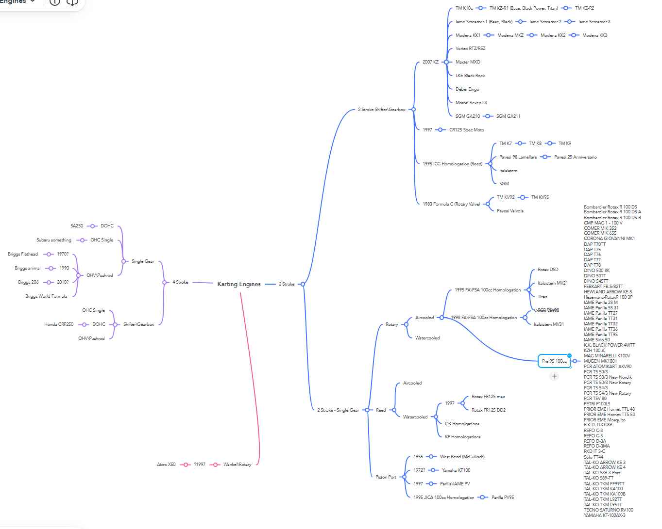

Briefly inspired by this topic:
I’ll be honest I don’t have much intention of taking this super far at this point, but figured I’s share what I whipped up real quick.. It’s a bit of a sprawling mess before I’ve even dumped what’s in my own memory.
https://mm.tt/map/2522876457?t=Me5TjXKkui

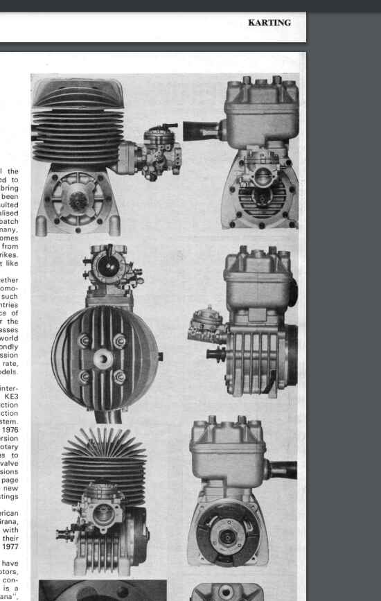

Pic

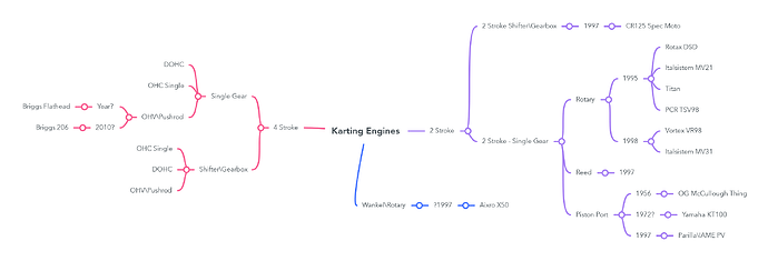

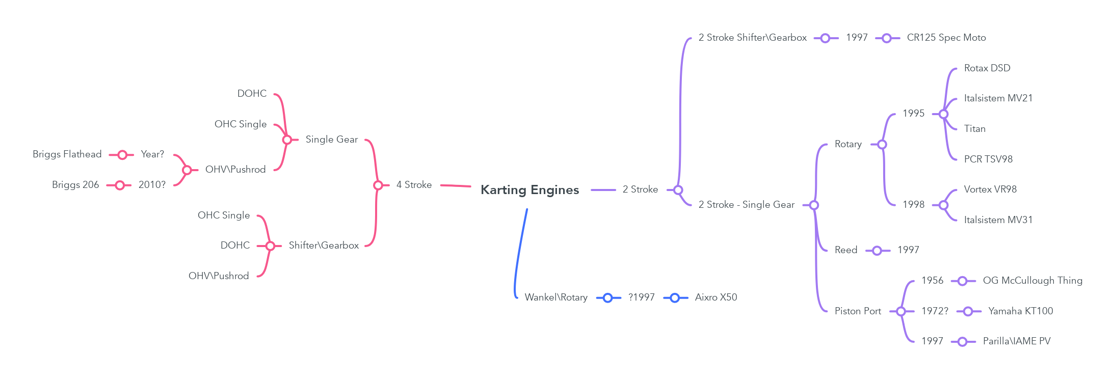

I dropped some gearbox updates

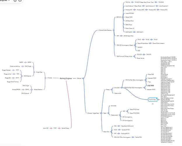

Ryger EVO, one of the most “mysterious” gearbox engines. I believe 2015 homologation. Does anybody know anything about it?
Why yes, yes you did. I didn’t realize the mindmap was editable LOL

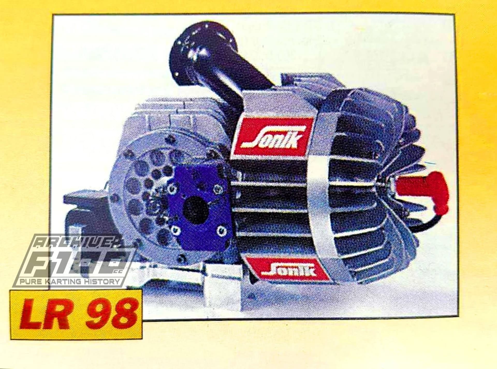

I don’t know anything massively innovative, but here’s a couple of relatively unorthodox designed for DD kart classes
Sonik

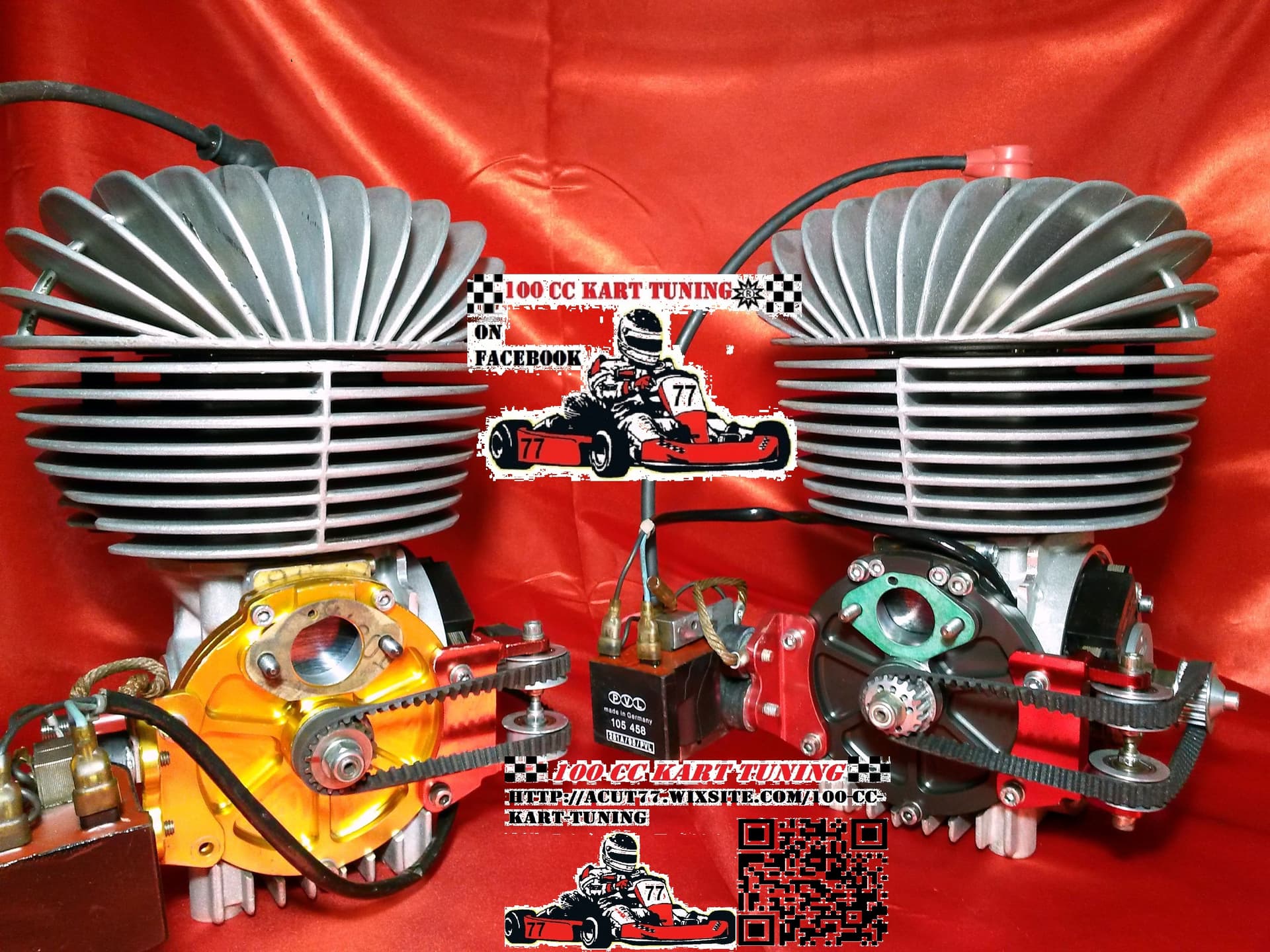

Ital SV21
The belt driven front placed rotary valve is a very sought after motor nowadays
A what now?!?! That hurts my brain. Imagine losing a race, because you threw a belt.
