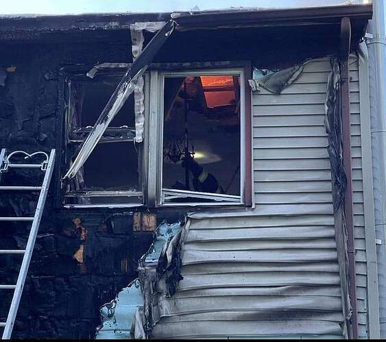

That was about 45 seconds before the entire ceiling collapsed on me
Ahh. That’s terrifying and I’m sorry you got hurt.
