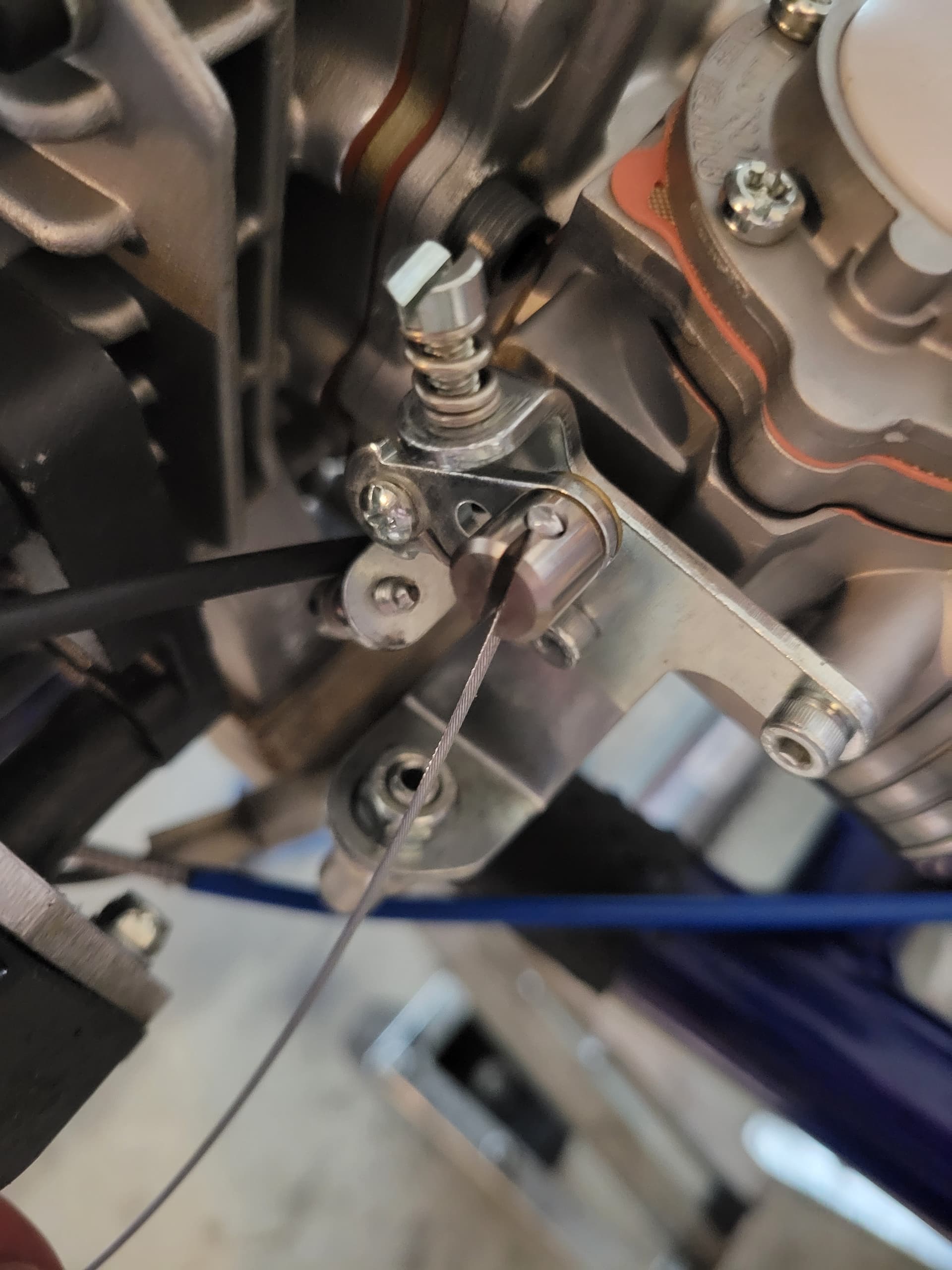

I have been restoring a mid-2000s OTK for the last couple of years. Most of the big ticket items are done. Got the throttle cable strung up and set today.
Will be changing pads soon and running fuel line. It’s amazing how many little tasks there are on cars and karts. You can get into a microcosm of every piece of equipment.

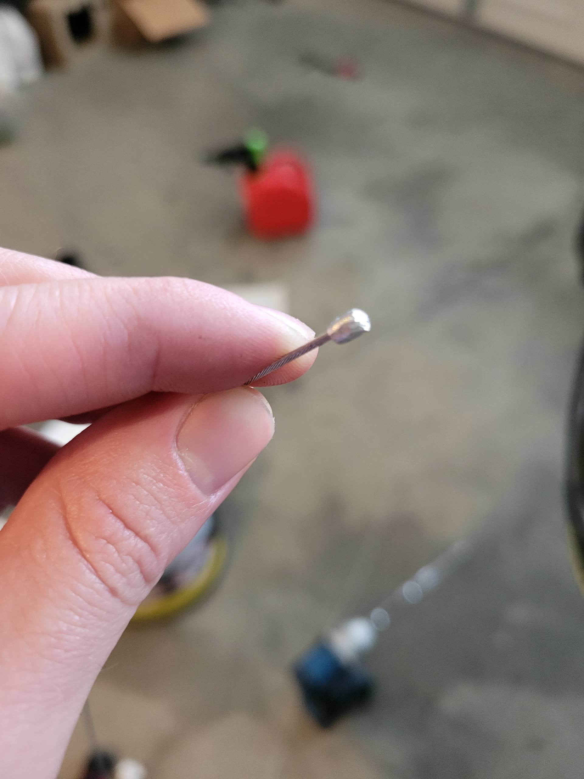

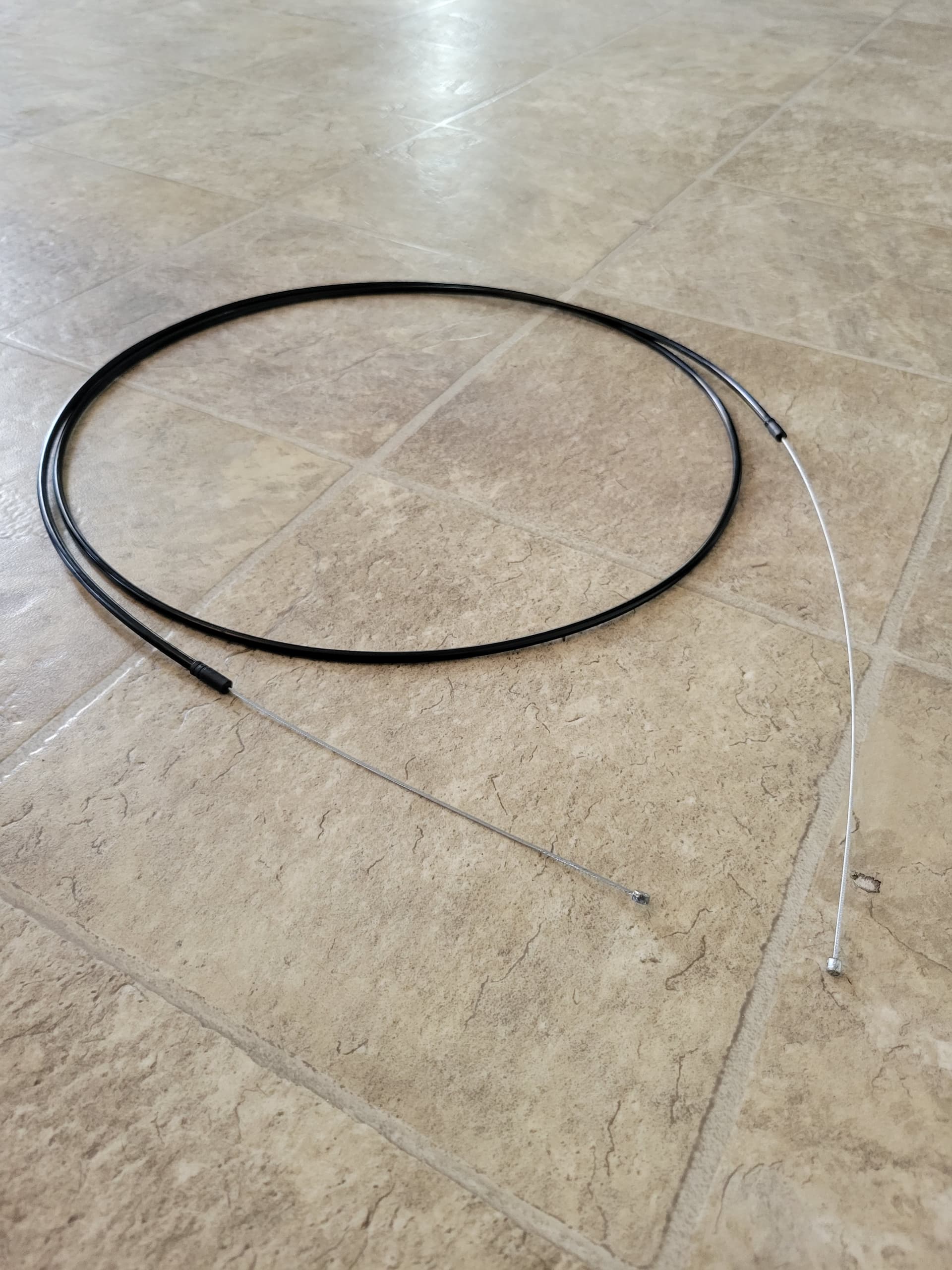

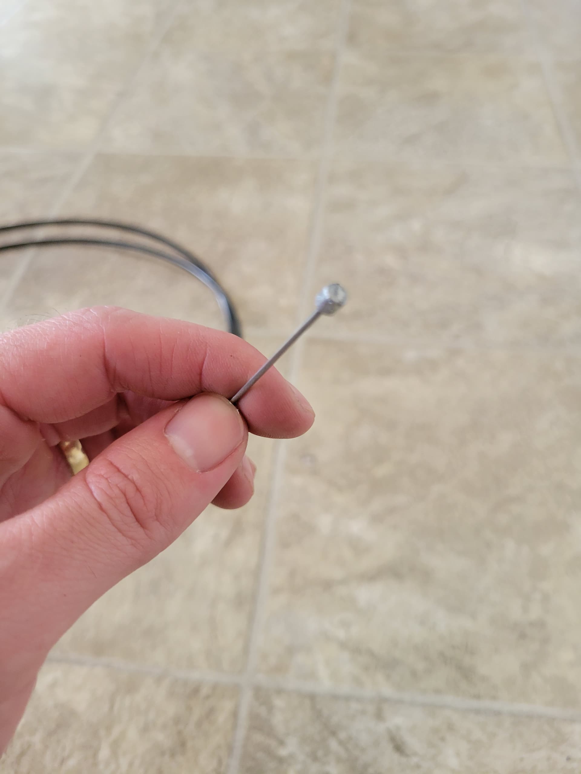

Today I modified a bicycle brake cable for use as a throttle cable for my kart! Shipment of new throttle cables got delayed (second expensive expedited shipment in a row delayed cause UPS is ass), so I bought a variety pack of bicycle cables at Walmart. The bauble on the end was too big to fit on the throttle of my engine, so I ground it down using a harbor freight dremel tool with a ceramic wheel on it. Took me a couple tries to find the right wheel for the job and it definitely isn’t round anymore, but this is a huge win for me. I suck at wrenching and this is only my second time using a Dremel. I’m stoked. I’m gonna make one more in case this one snaps off. I just need it to hold for one practice day while UPS unfucks my shipment.
Brake cable is larger in diameter and would require a housing change but shifter cable is almost identical to throttle cable and as far as I can tell they are made the same way.
Ahhh ok. There were thicker cables in the pack I bought. I wasnt sure which was which. I have never worked on a bicycle.

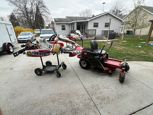

Since the race was cancelled due to water on the track (and everywhere else!) I got my karting tools out and my wife helped me change the tires on our ZTR mower. That’s the first time I’ve worn out the tires on a mower!
I typically modify my throttle cable barrels using vice grips to gently hold the cable just below the barrel, then sparingly hold and rotate (simultaeneously) against a fine grit bench grinder stone. Sometimes I use bare hands so that I can feel how much heat is getting into it. In dire emergencies, I’ve added a weld bead to the end of a bare cable and ground that down, but I always view those as suspect… solder would likely be better.
Here’s a tutorial to make your own:

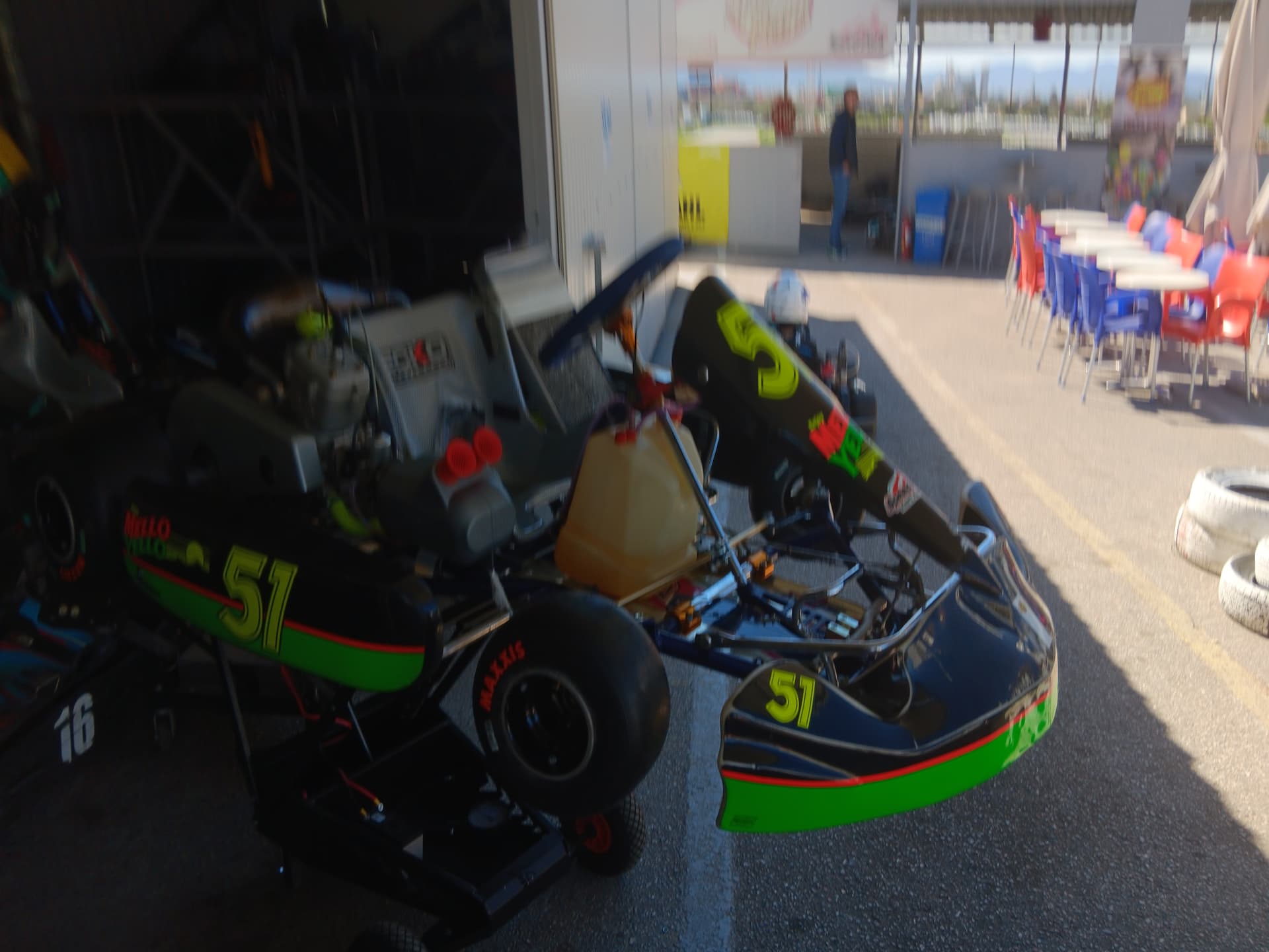

Well .. if this ain’t a real love letter to the past with a spirited by nascar go kart assembly ..
Then hands down i can’t do better than that .
And its a very small world.. oceans between us cannot make me blind .
Even with out internet in my early days . I know you guys exist and race with smile over there .
Have a happy Friday America .

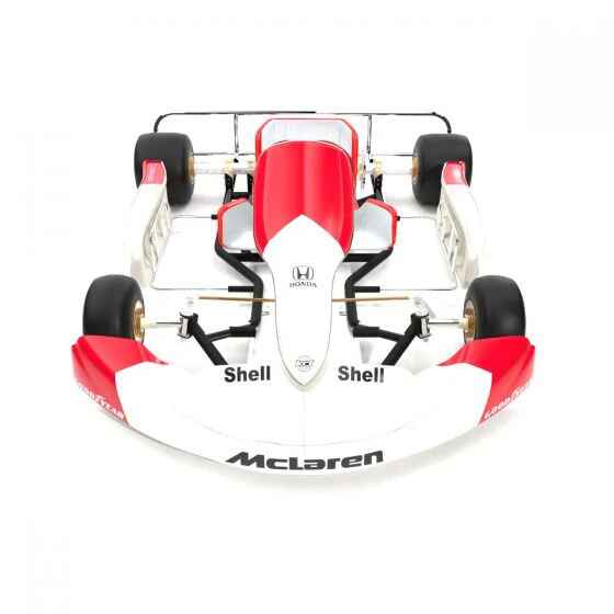

I may add a McLaren MP4 theme to my kart…
But I want to modify the text a bit. I’ll use the Marlboro font, of course, but which of the following is best?
  • Marlbarrow
  • Marlburrow
  • Marbled’oro
Or something else?
There’s a slim chance I’ll just run the cig company text for authenticity…the irony is I live in the town that’s the HQ for RJ Reynolds…lol Maybe I should do a CAMEL livery instead…

Thats awesome Stamatis! Do they call you Cole Trickle or Tom Cruise? Lol.

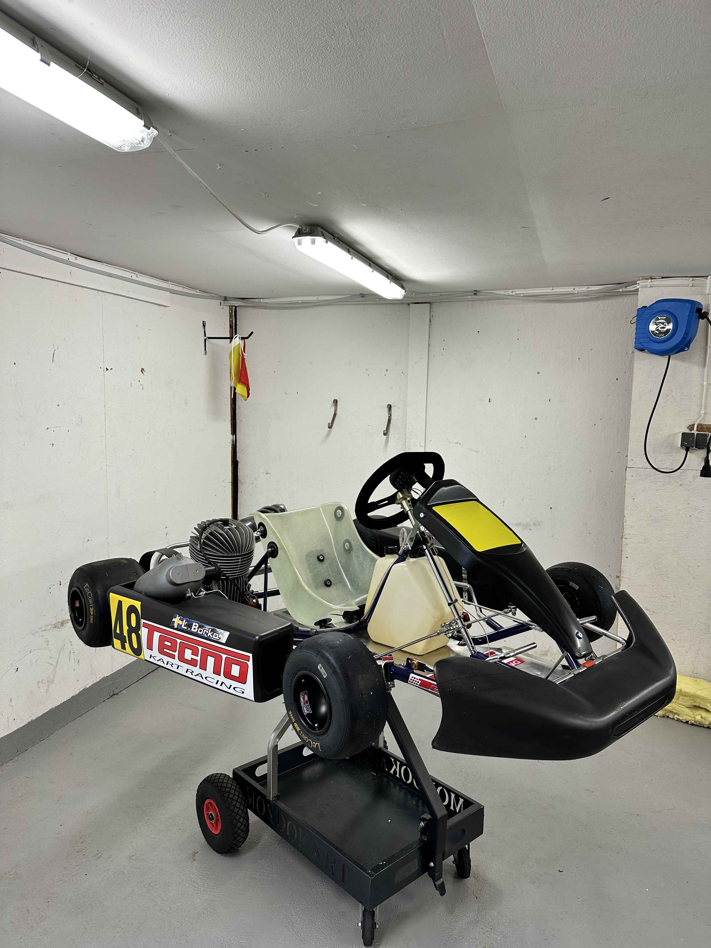

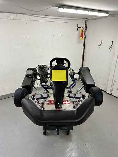

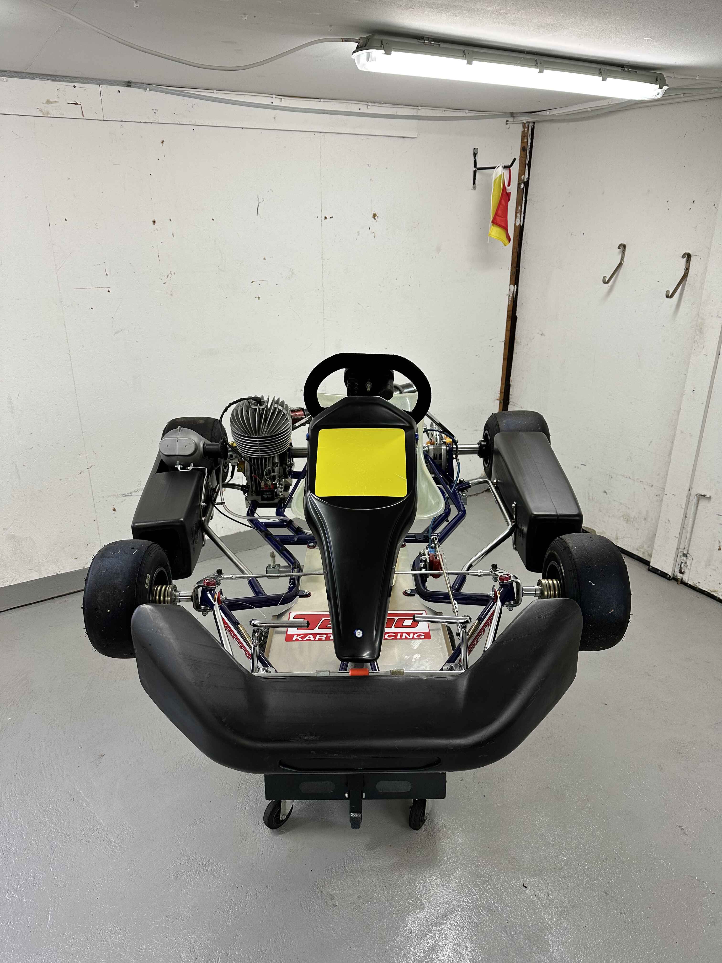

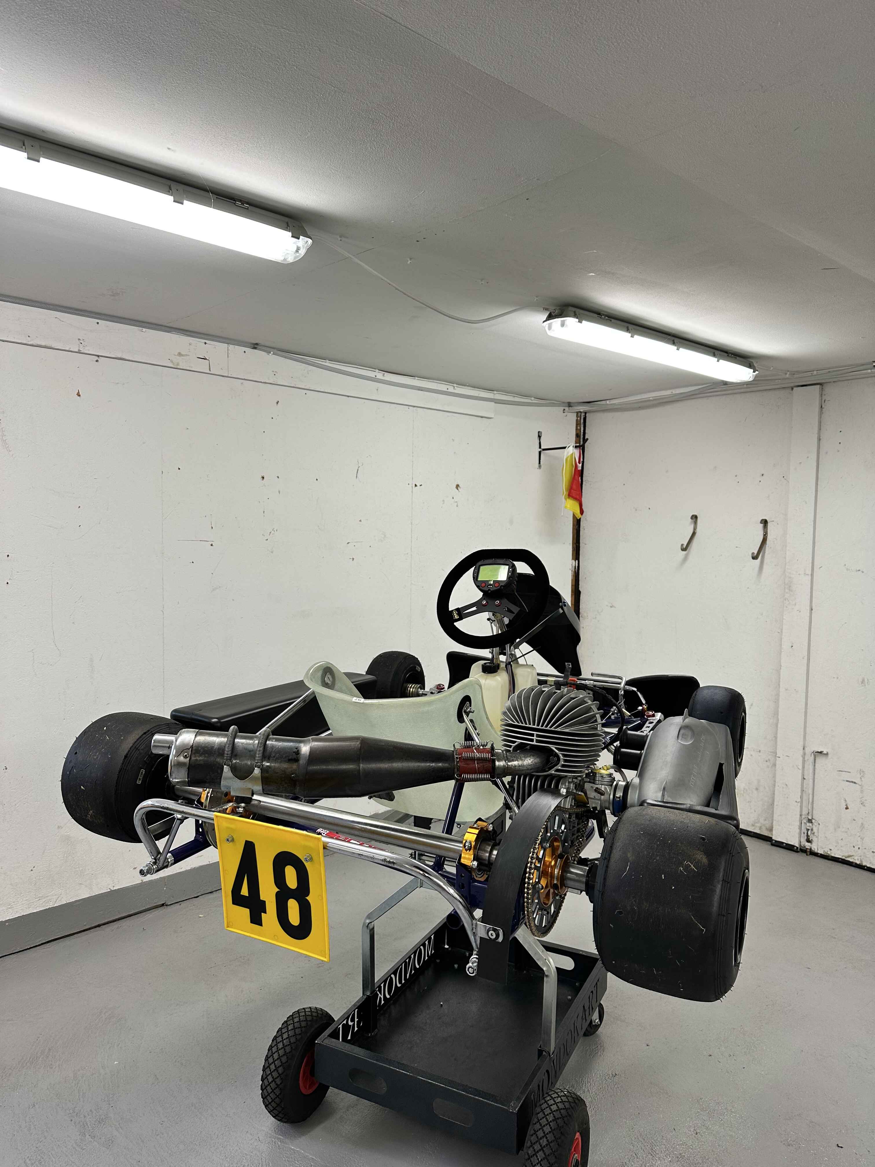

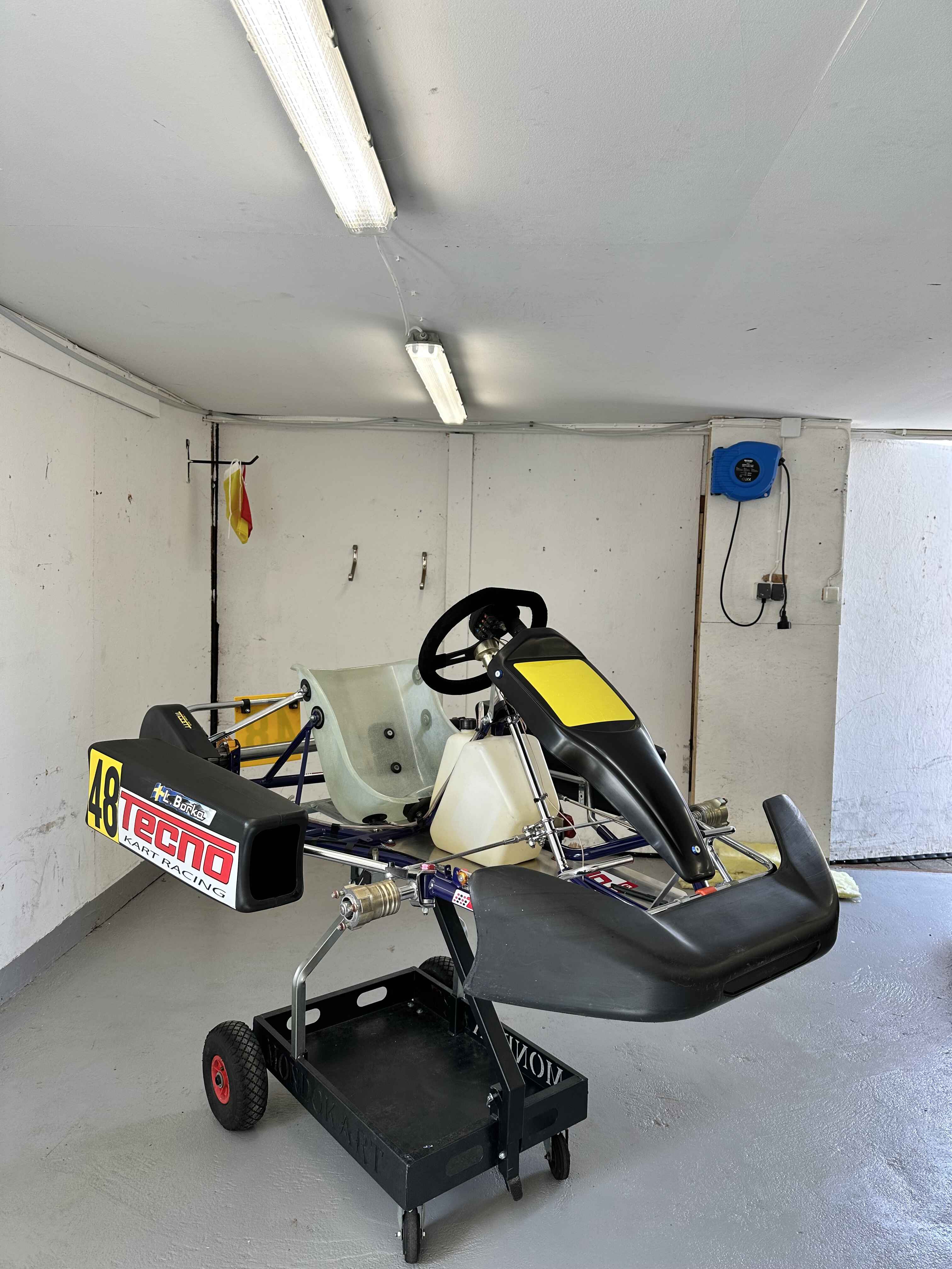

Woppaa, Tecno G10/Vortex VR95 now ready to hit the track and to be run in!
Turned out great!
Hopefully it will be as fast as it looks :raising_hands:t2:
@Ted_Hamilton thanks for the tutorial. I haven’t learned to solder yet. My nextdoor neighbor did try to solder my throttle cable when it first frayed (before I decided to try bike cables). The solder base wouldn’t adhere to the cable. He tried two different heat sources. Maybe both of em were the wrong temperature or the base was the wrong material.
