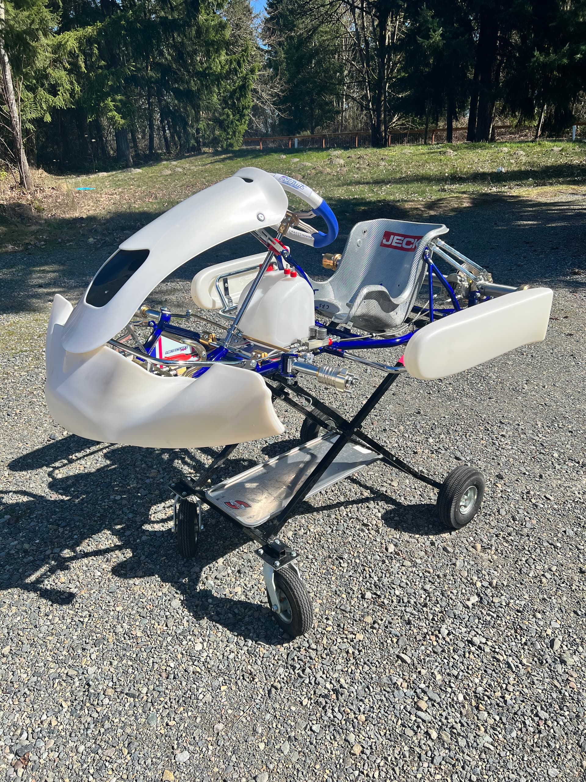

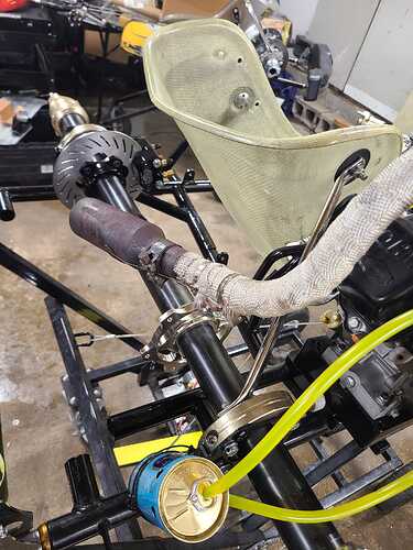

Got her mostly built today. Got a few small issues to work through. Then on to motor mounting.
Looks good. Curious on the Jecko and KG bodywork on the Kosmic. Personal preference?
Jecko is definitely preference. I just enjoy the comfort and support. KG fairing. I have weight concerns. And the otk hot dog is heavy as hell. But I’m an aero nerd so I can just do a dynamica or something

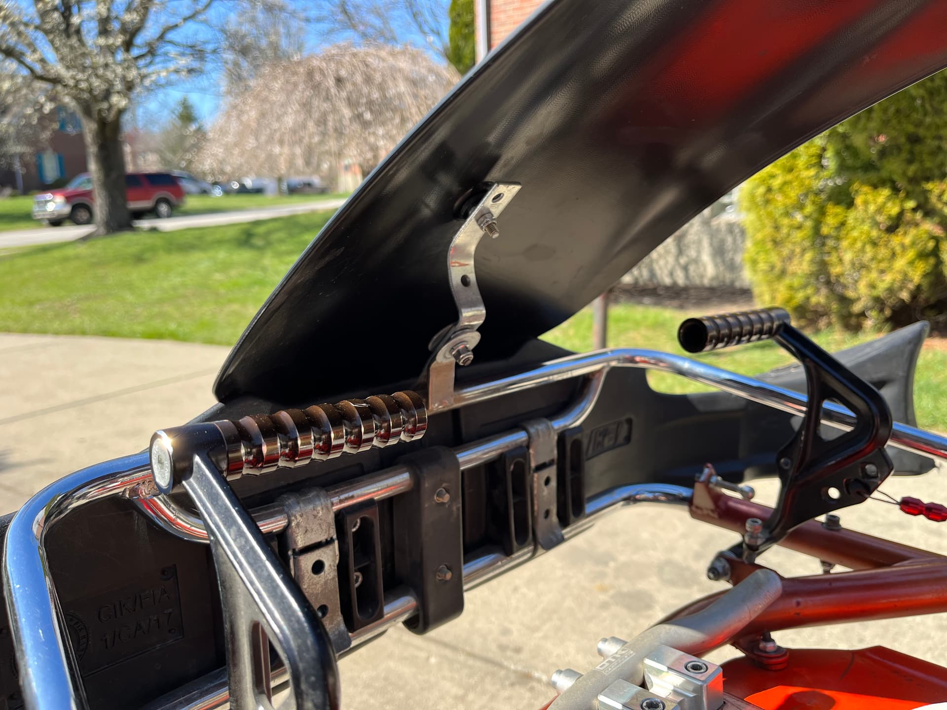

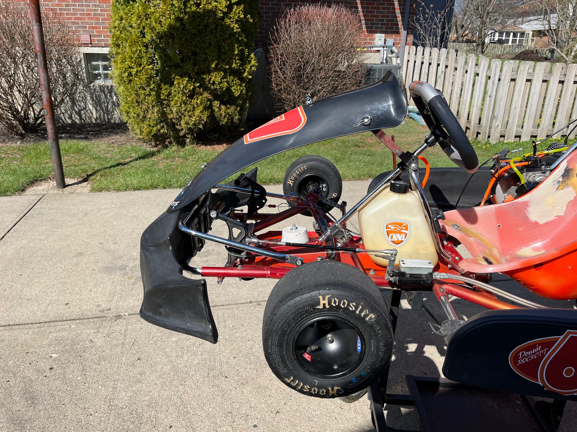

What sort of modifications did you have to do in order to put the KG Nassau?
You will need KG507/508 specific brackets for the upper and lower part of the Nassau :+1:t2:

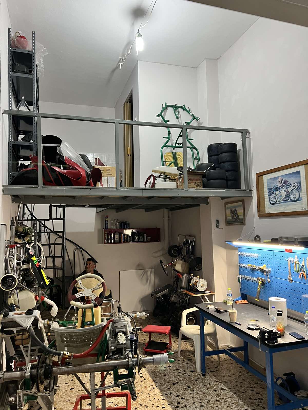

Today finish all the transfer jobs from the house to the new garage. From now on we will start working on a tony chassis with a iame 175cc engine on. And 2 more chassis are on hold for future jobs.
Its that feeling that life is sweeter and more colorful that I get after been with that small cars that can’t compare with anything.
Cheers from greece

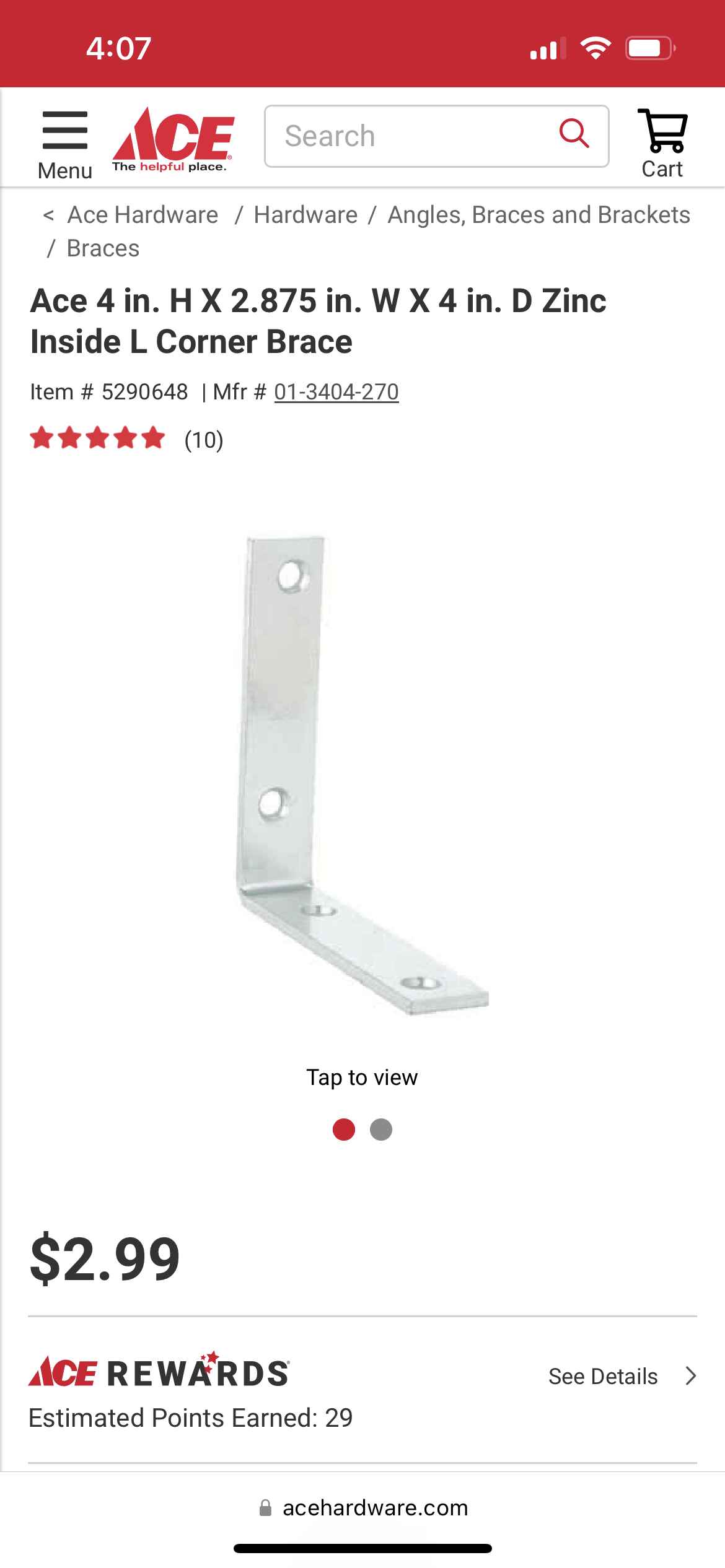

This worked for me, and saved me a few bucks for the front bracket. Just had to spend a little time bending and trial fitting. On the brackets by the steering, I had to twist them a little on the end to get them to fit, but it wasn’t too tough.

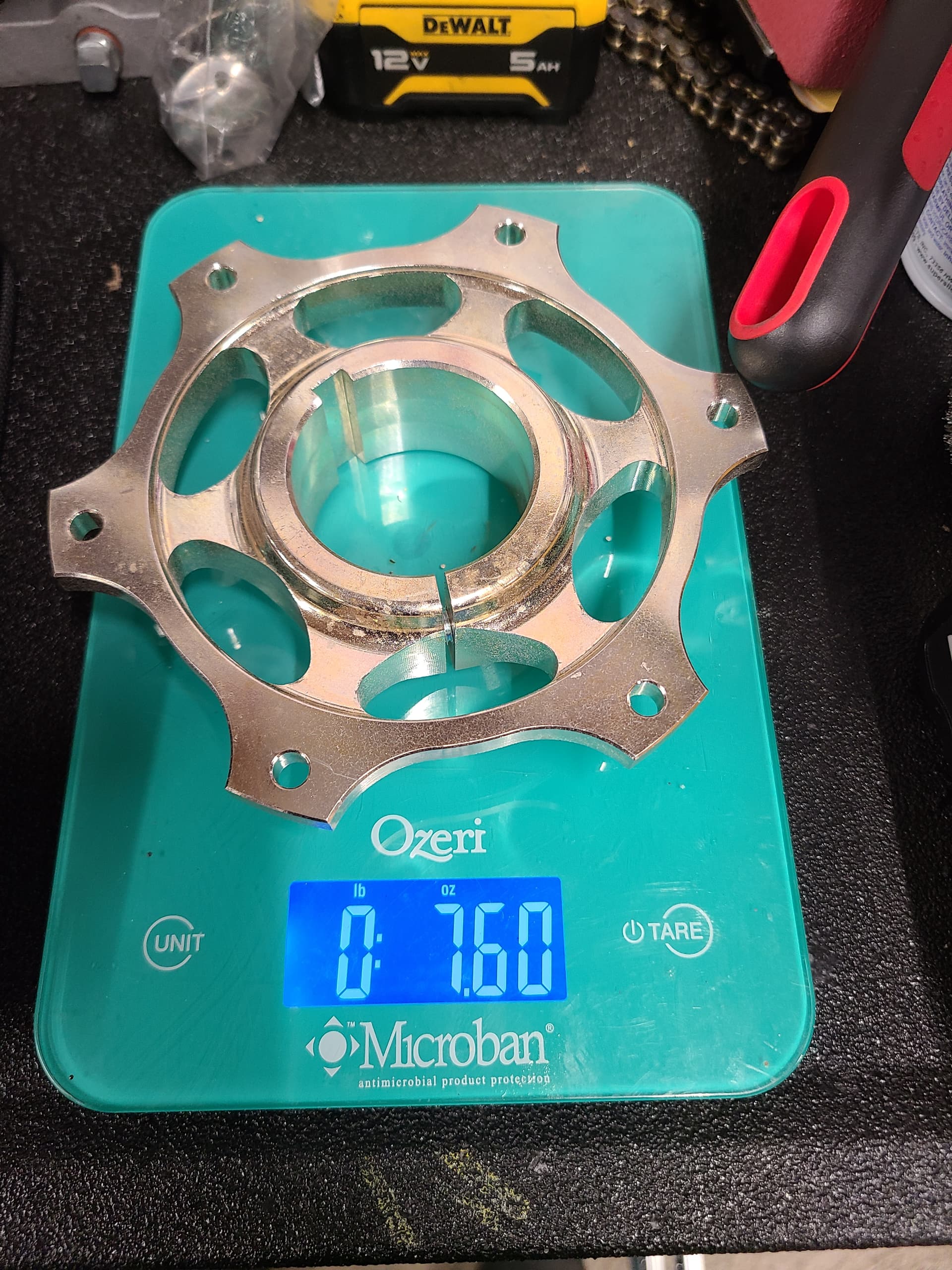

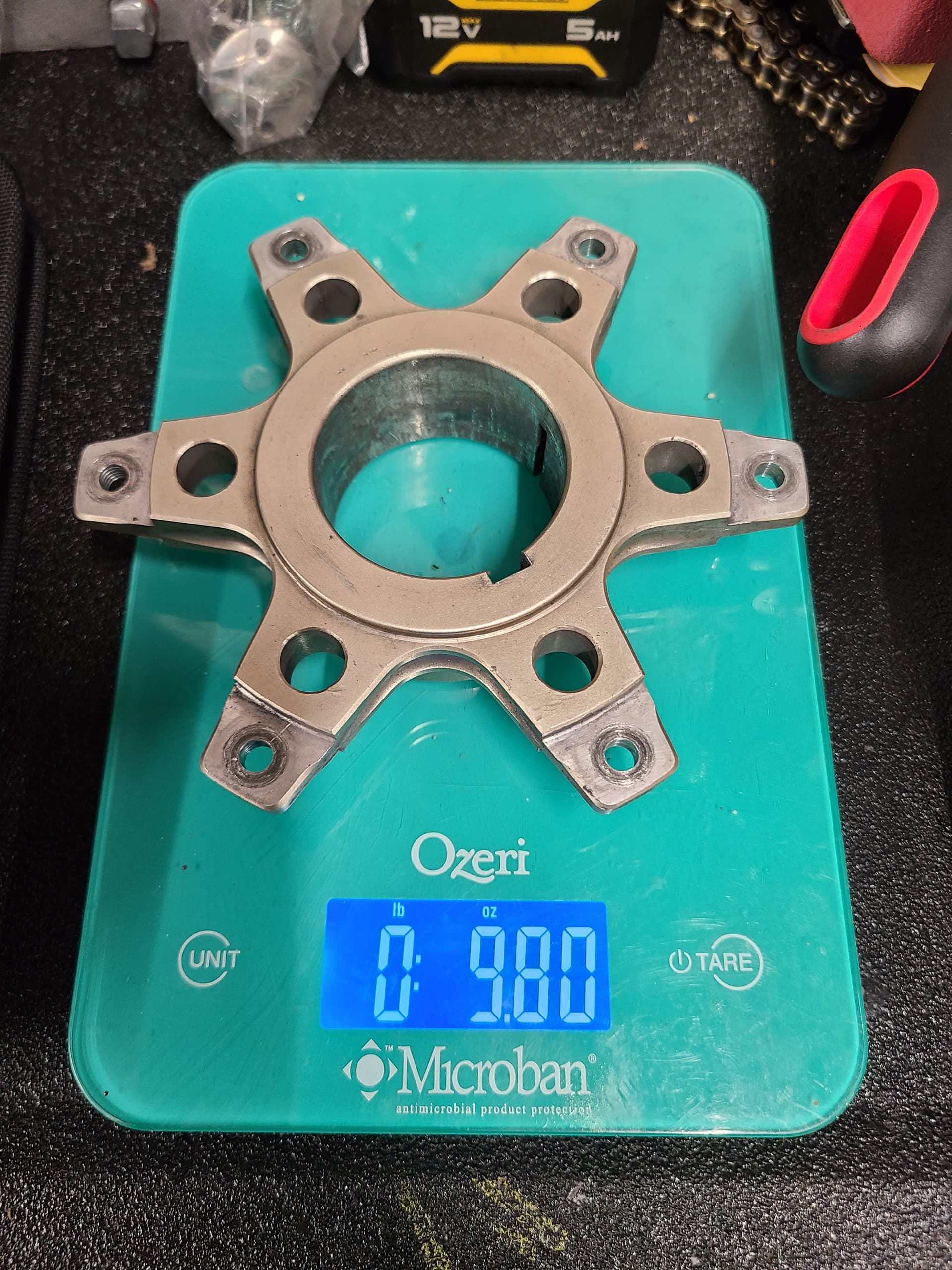

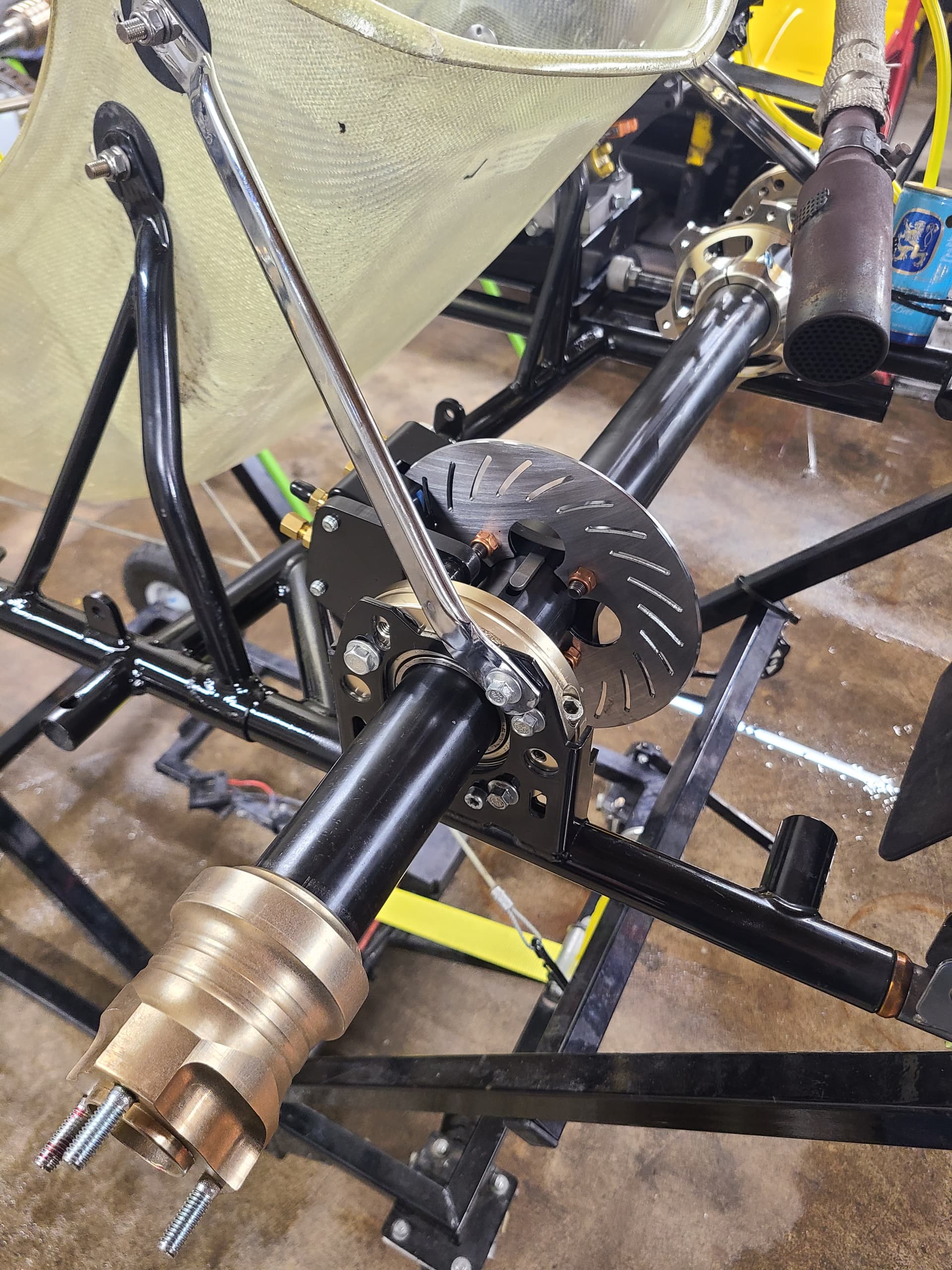

Aluminum Chain Carrier
Magnisium Chain Carrier

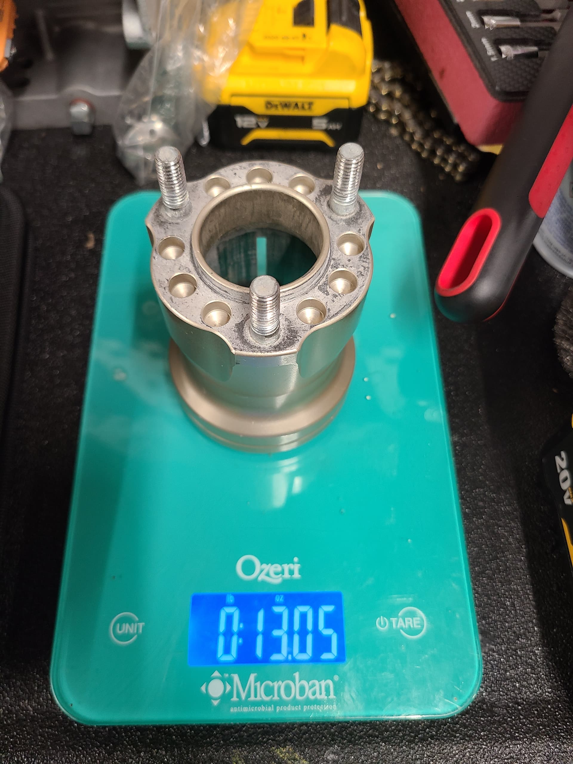

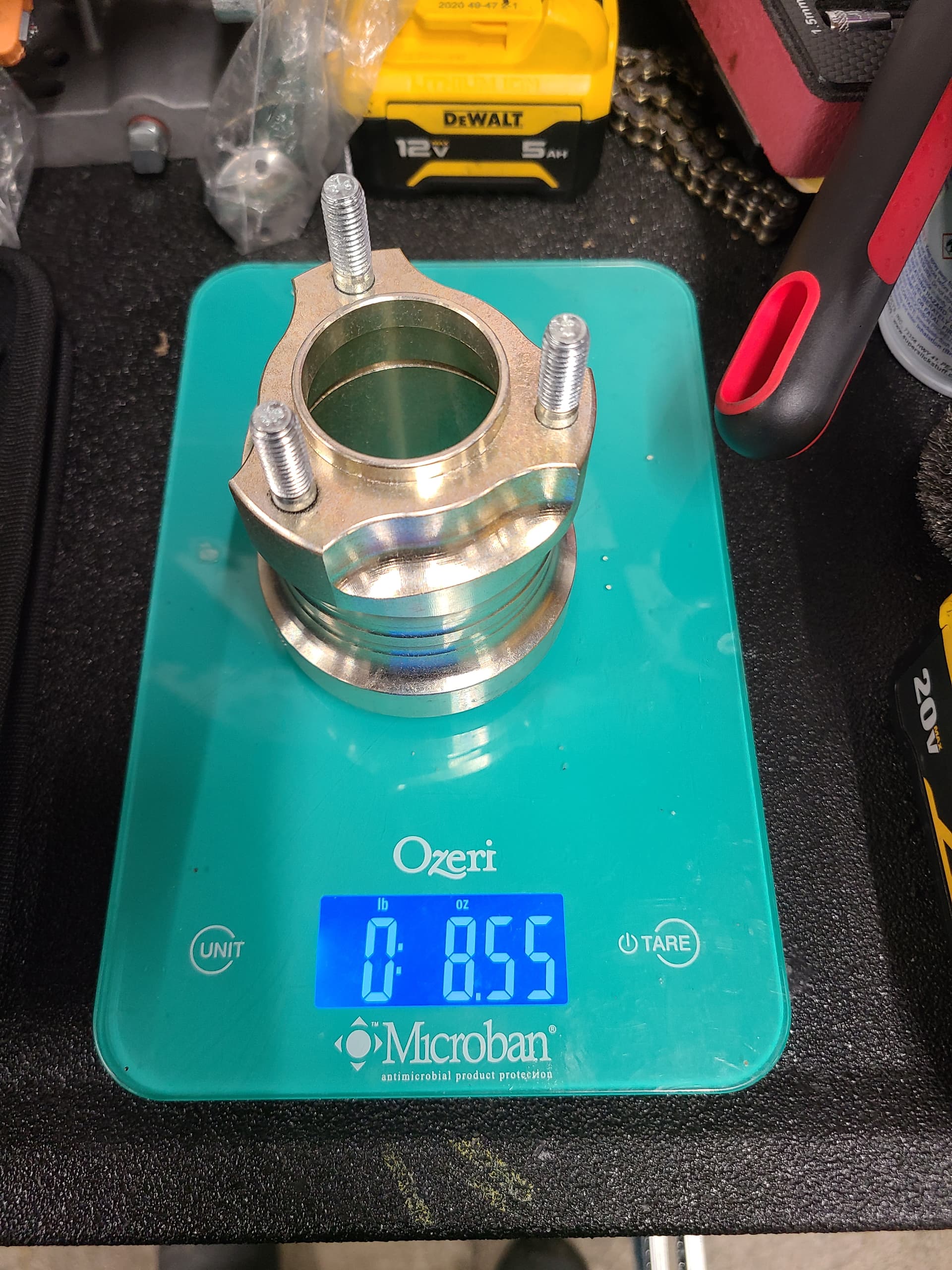

Aluminum Hub
Magnesium Hub

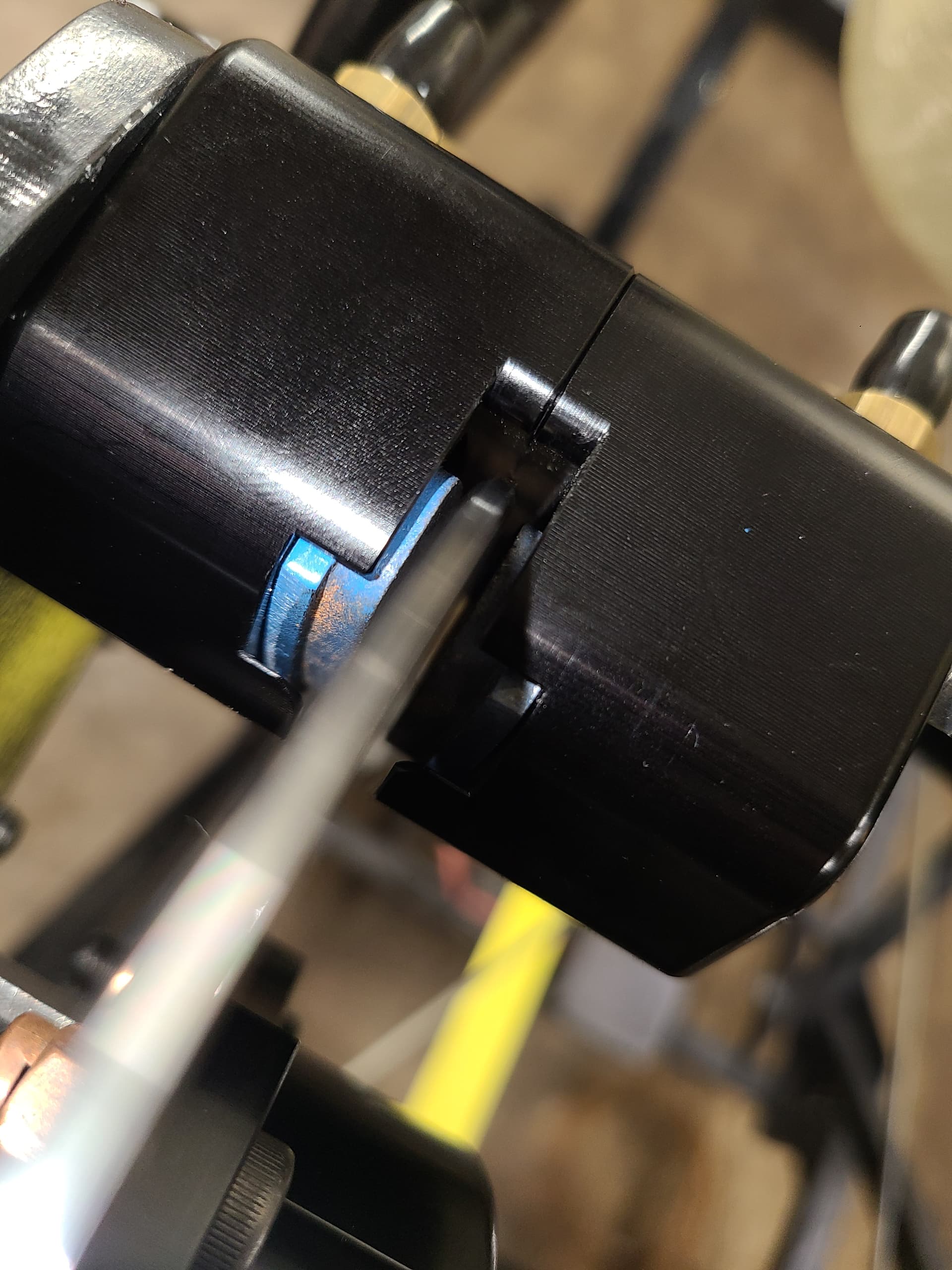

Brake Caliper location, about 1/16 inch inside rotor diameter.
Rear end assembled, I also rebuilt bearings.
Last step is making the brake line from MC to Caliper.
Is this a PCR chassis?

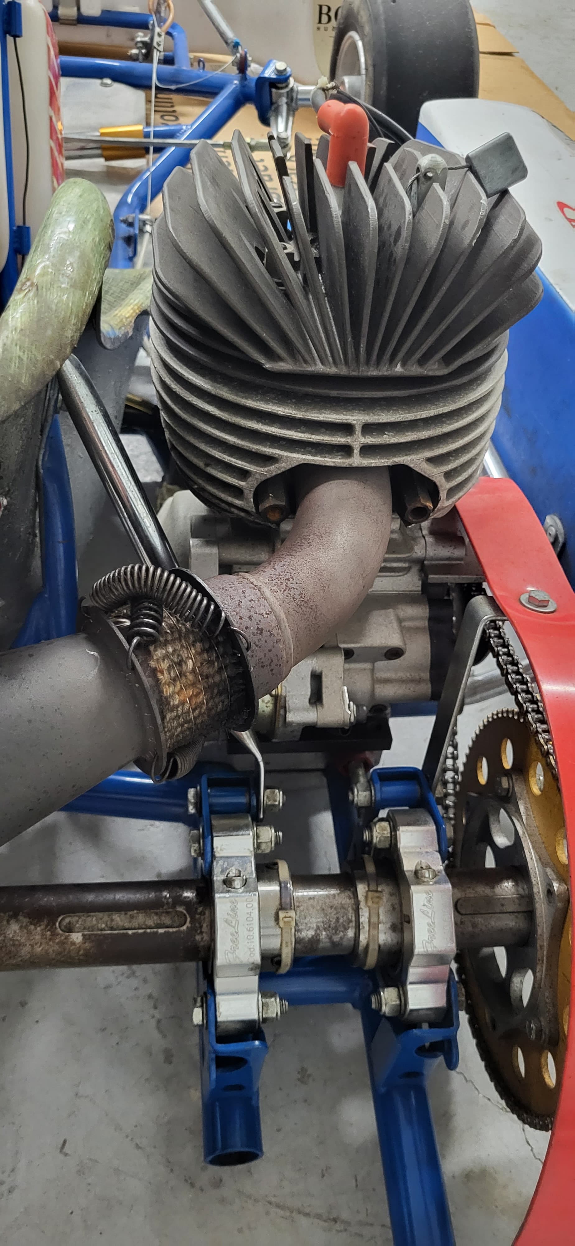

A little before…

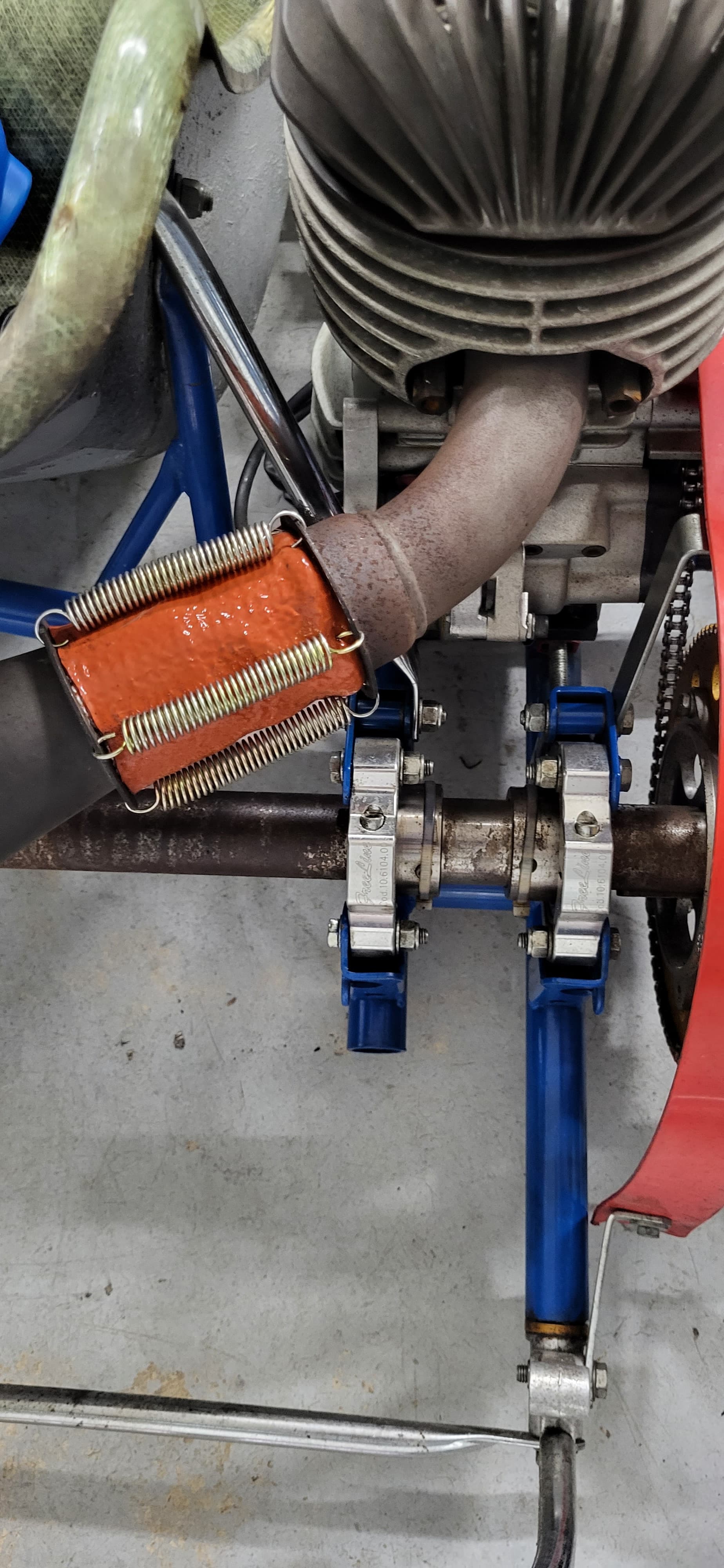

and after…
The chassis is Intrepid Freedom F4K No 0150
A team chassis used in 2020 (tubing from 2015) that broke at the rear cross bar prior to me buying after CKNA grands. There is some other posts about rebuilding the chassis back at the end of 2020/early 2021
