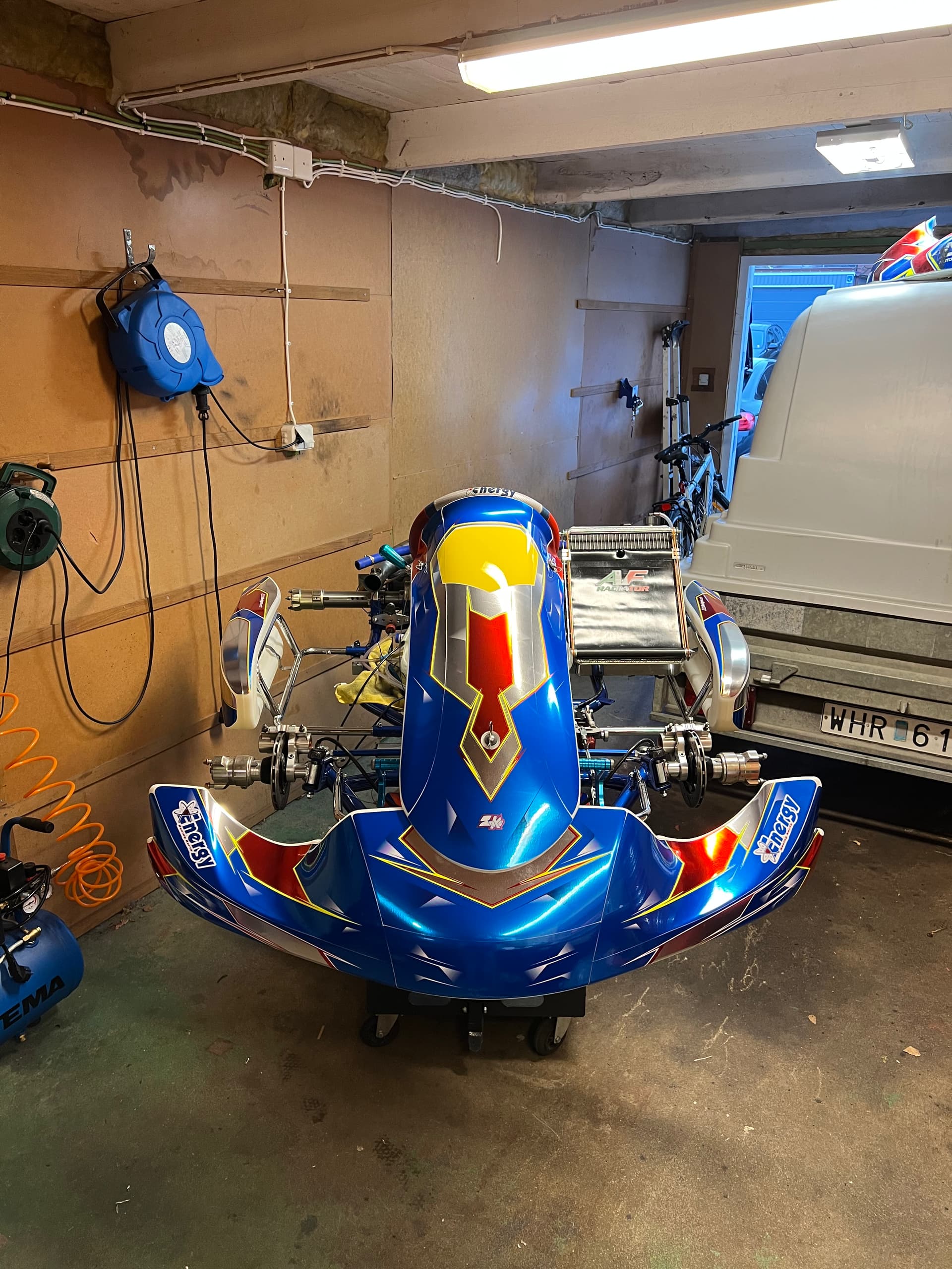

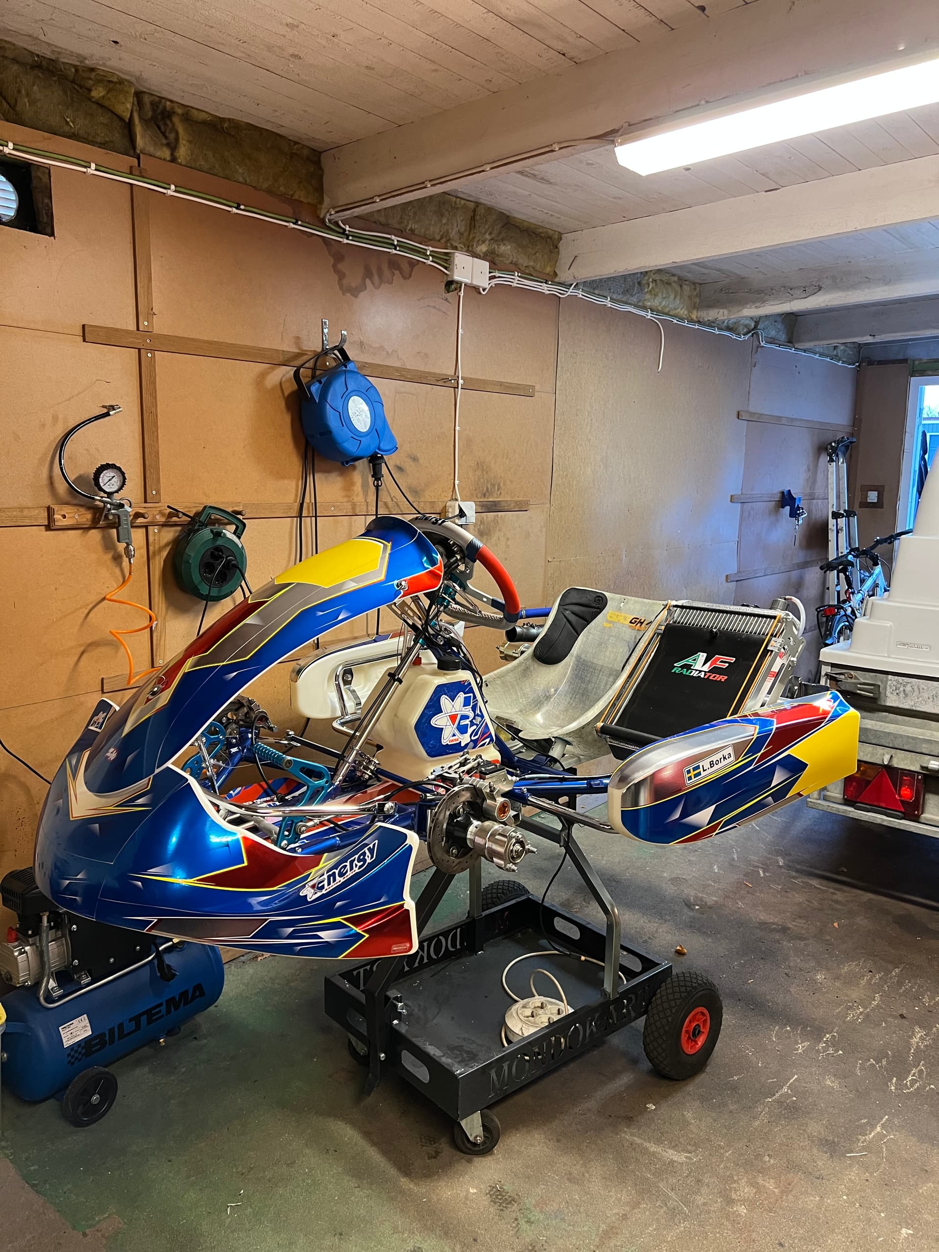

Finally installed the graphics kit today! Turned out great! Eager to take it out to track now for sure :heart_eyes:

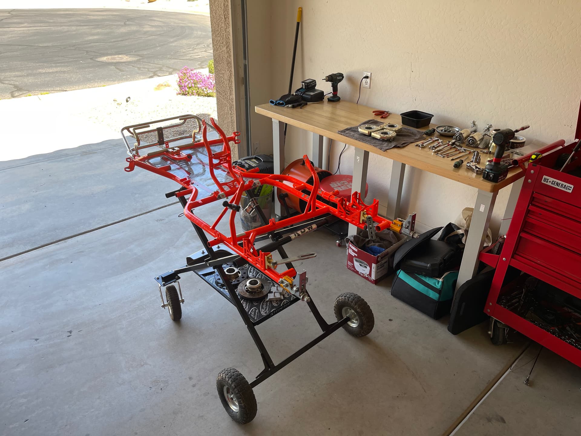

Gutted and cleaned. :zany_face:
Might go up for sale. Thinking about ordering another new rolling chassis.
I am super happy with the end results! Better than expected, both her and I screams to get out to the track :joy: To cold in Sweden at the moment, there is a race next weekend but I will not participate unfortunately.

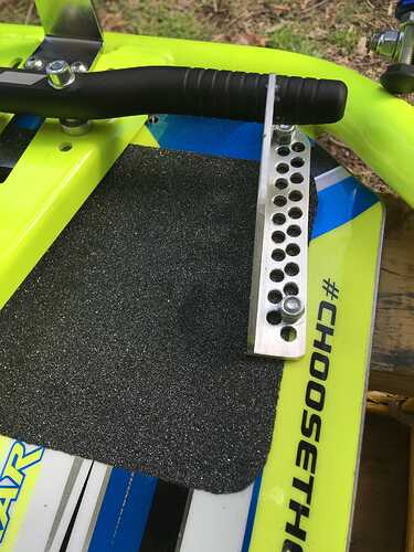

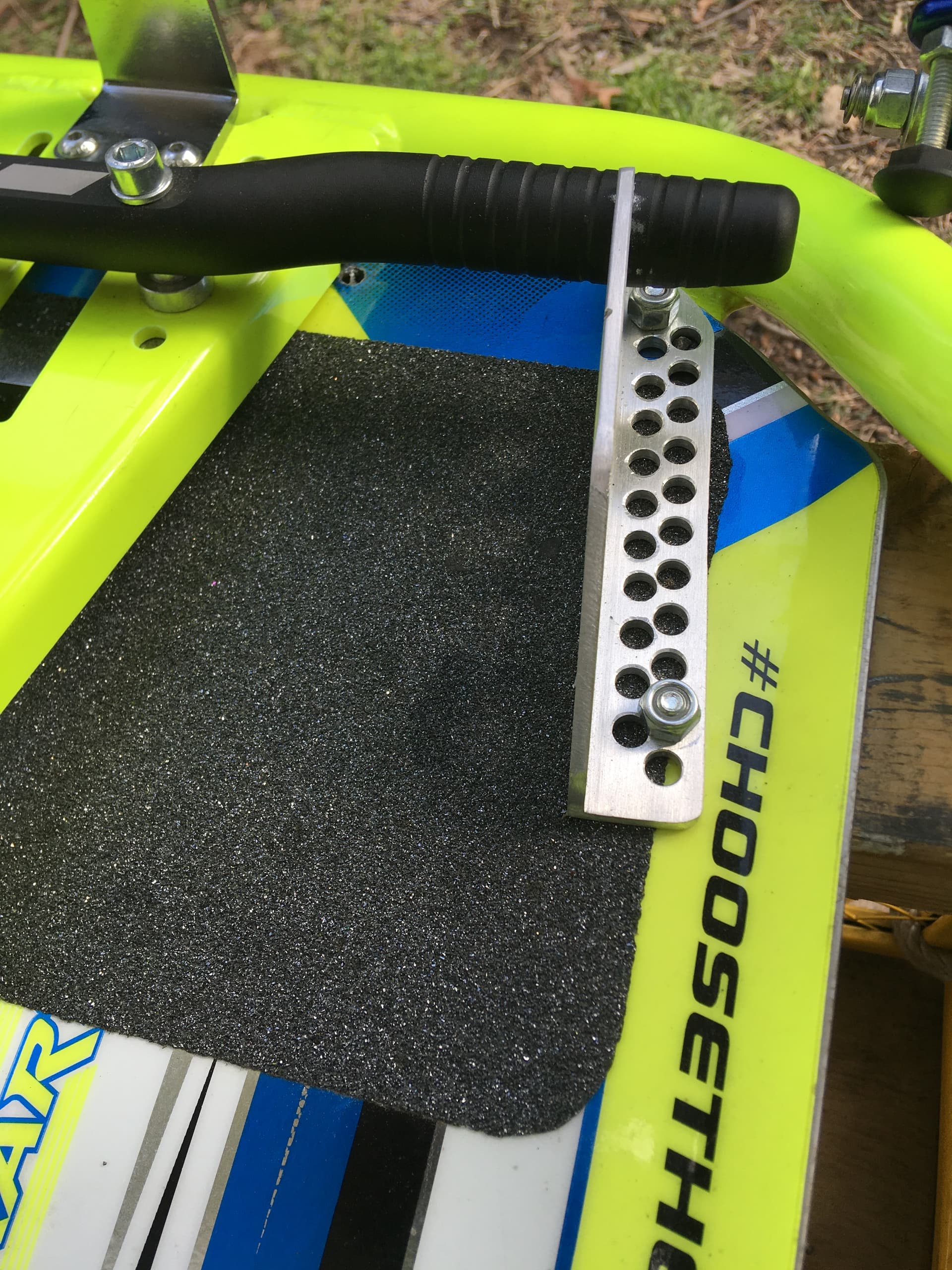

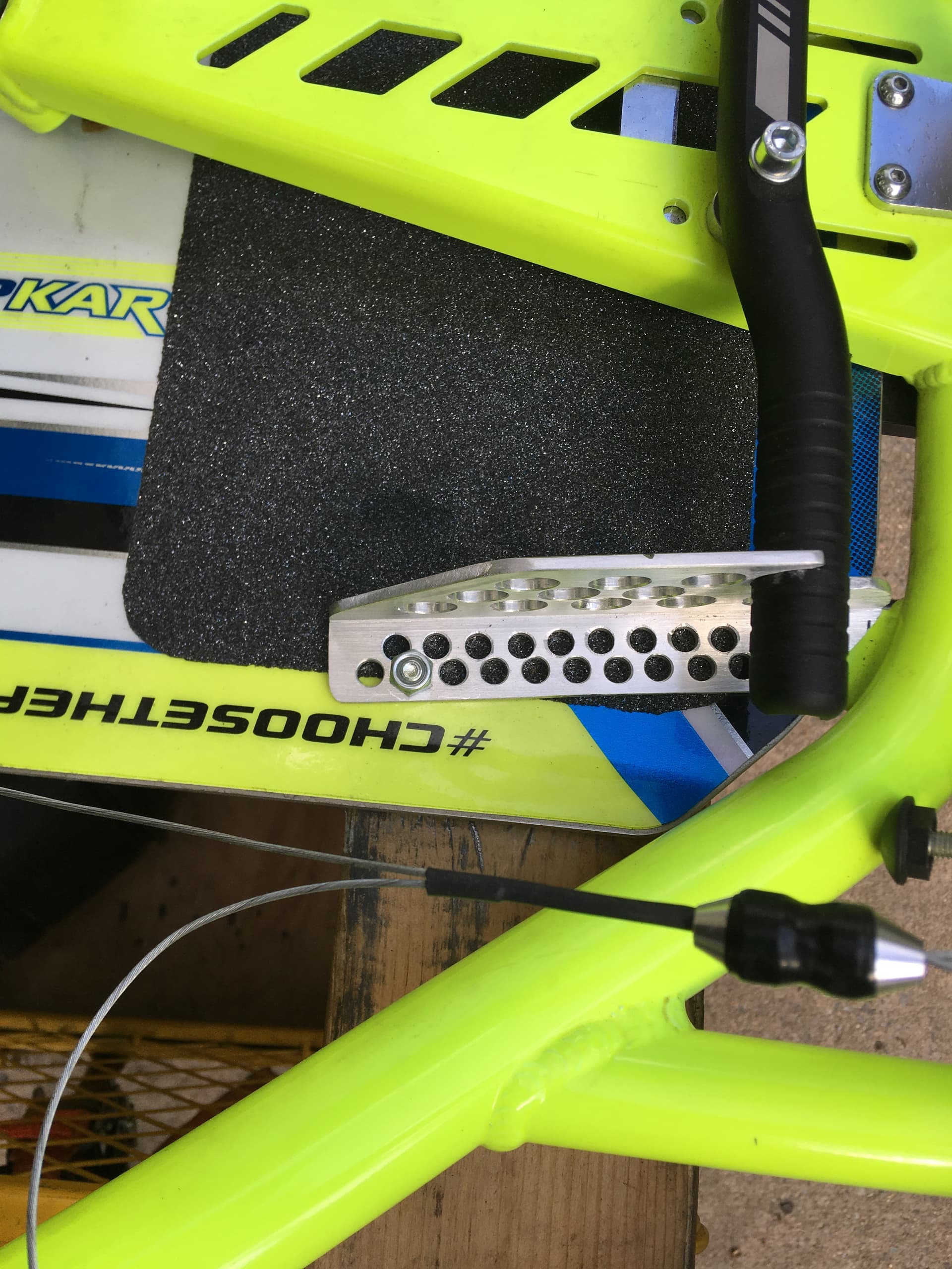

Installed my foot brace. It should keep my right foot from fowling the throttle cable.
I find my heels move is the bottom bar. Not sure what to do.

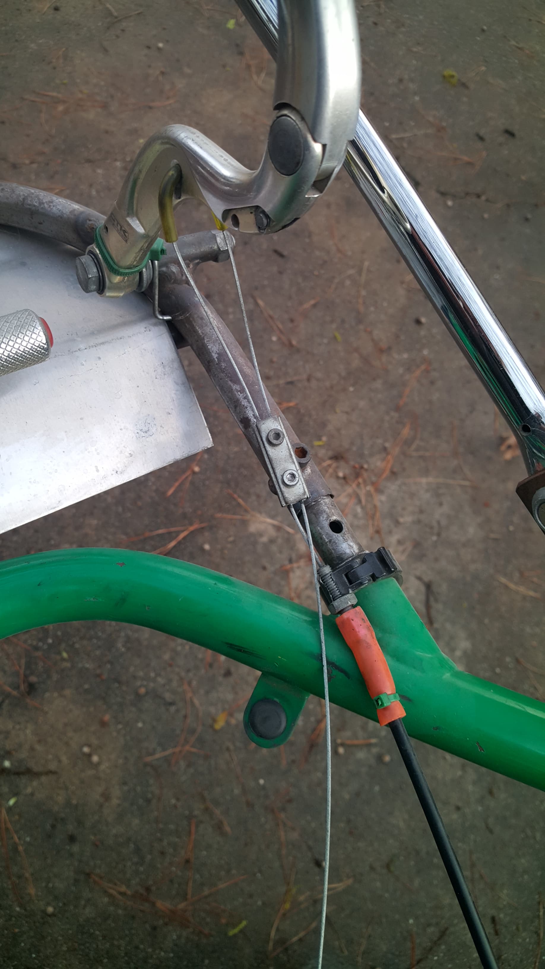

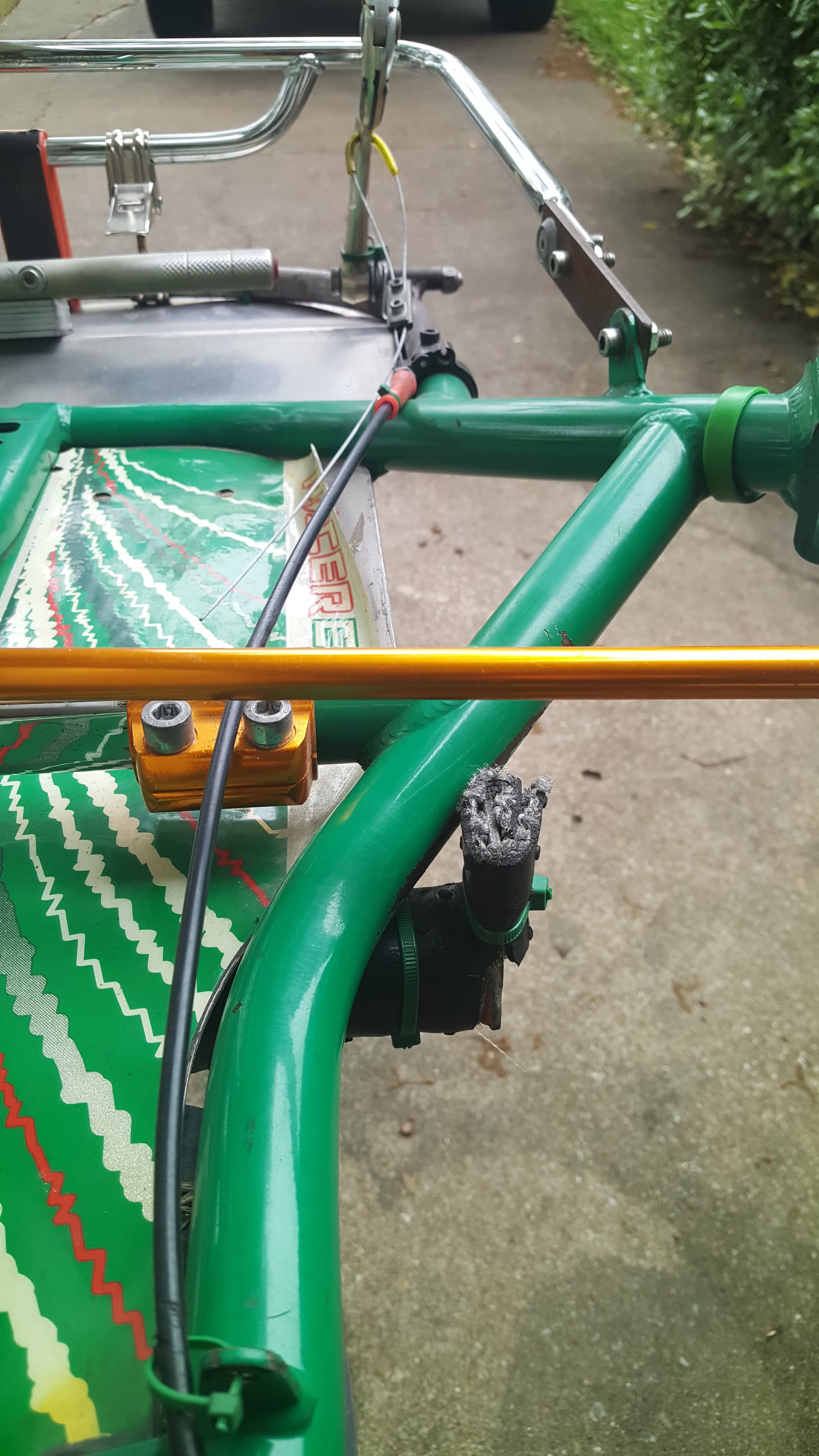

I had a similar issue when I first started racing. I found my foot blipping the exposed throttle cable in tight or bumpy corners. It made it hard to be smooth on corner exit.
I went to a Bicycle Shop and purchased a cable stop for a chain de-railer, tapped the hole to screw in the sleeve adjuster and mounted it closer to the throttle pedal. Not only did it shorten the amount of cable exposed out of the sleeve, it lowered the cable so my foot was less likely to contact it. Added bonus was the added weight was negligible as compare to mounting a guard. I think I paid less than $10 for it.

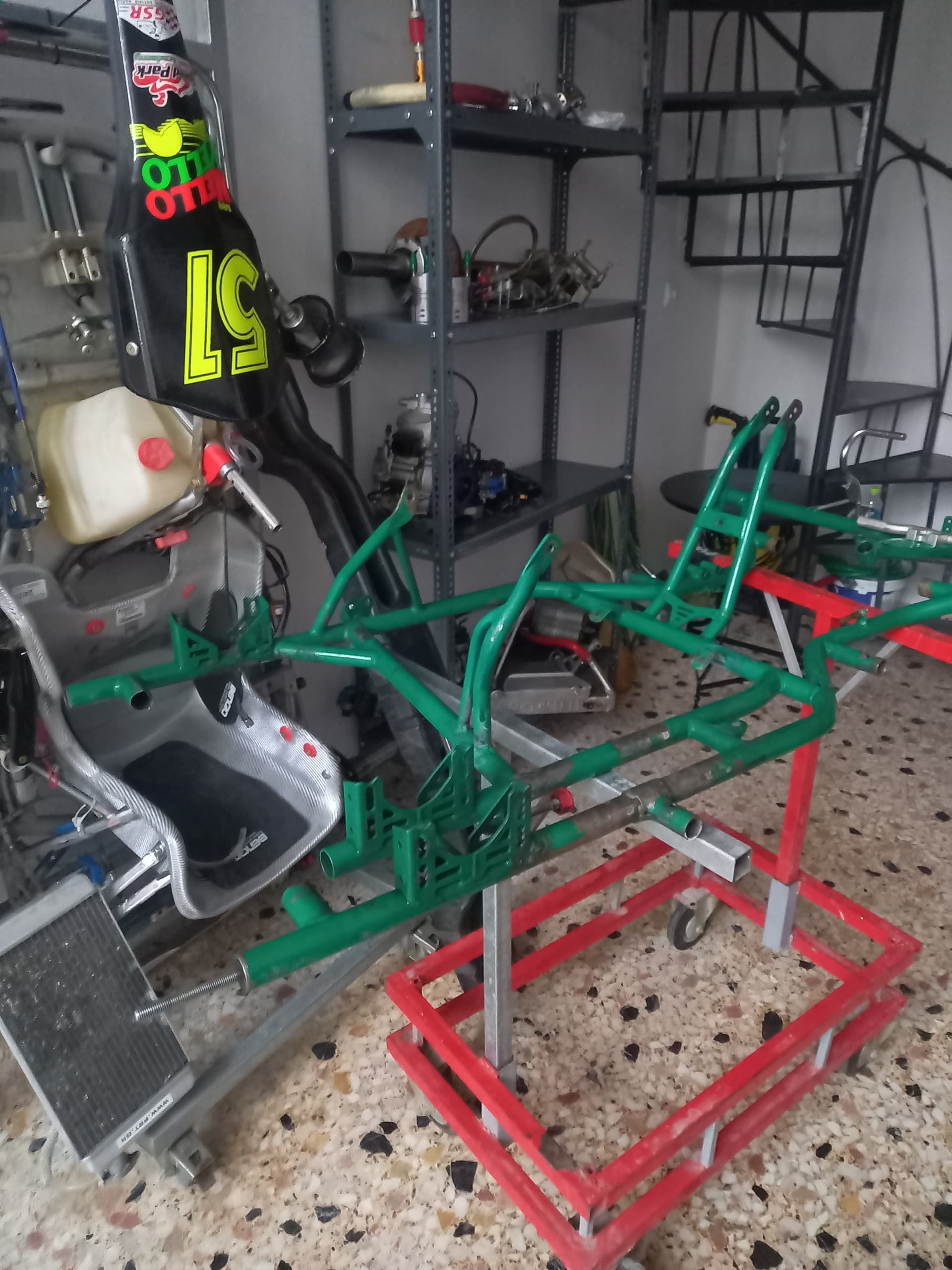

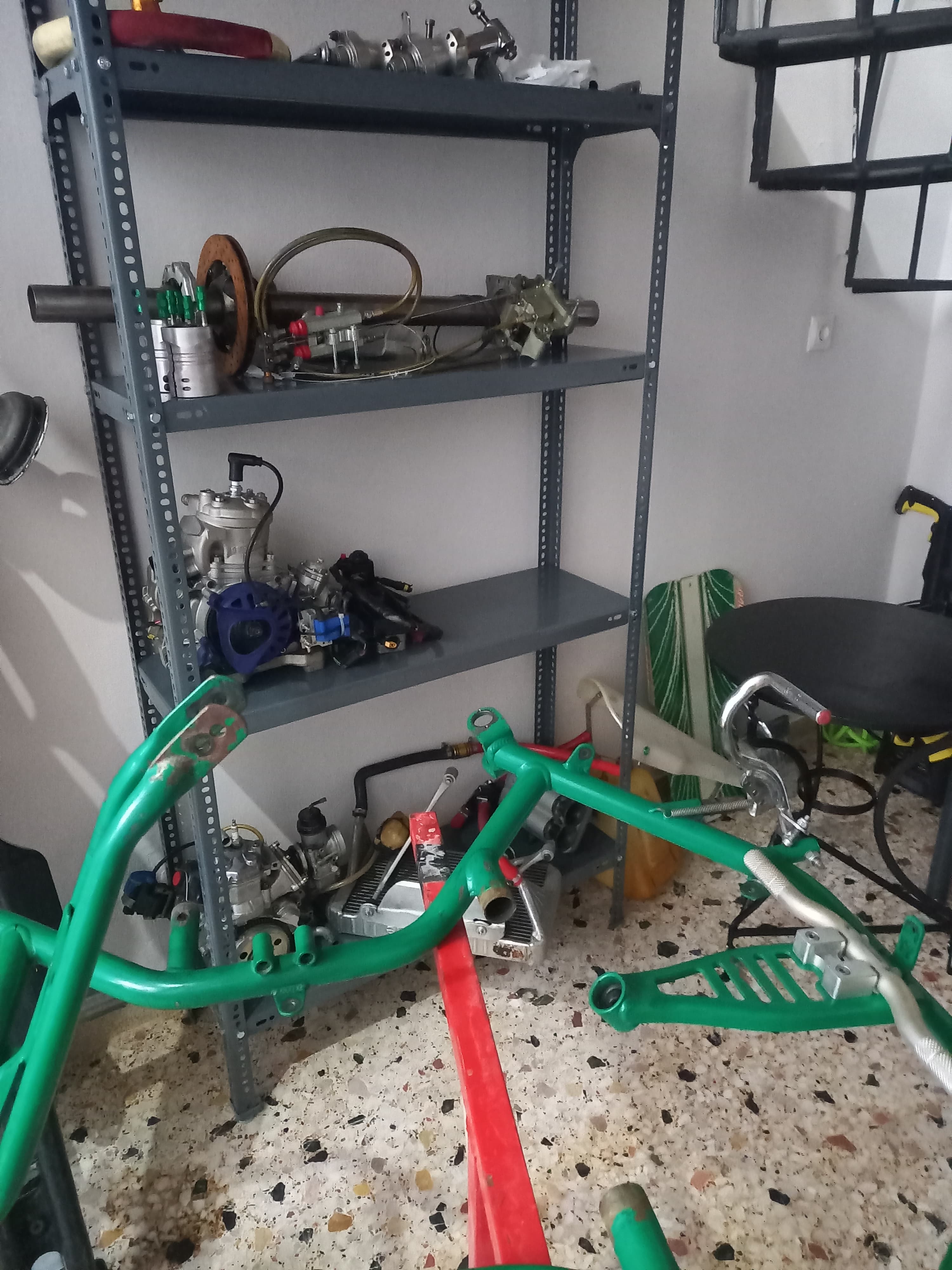

Remove everything from the chassis and measure for any bending , start again from ground zero ,
I thing we gonna refresh the paint on that , im very excited that at the end i will hear the 175cc iame sound . But thats a long story . First things , first .

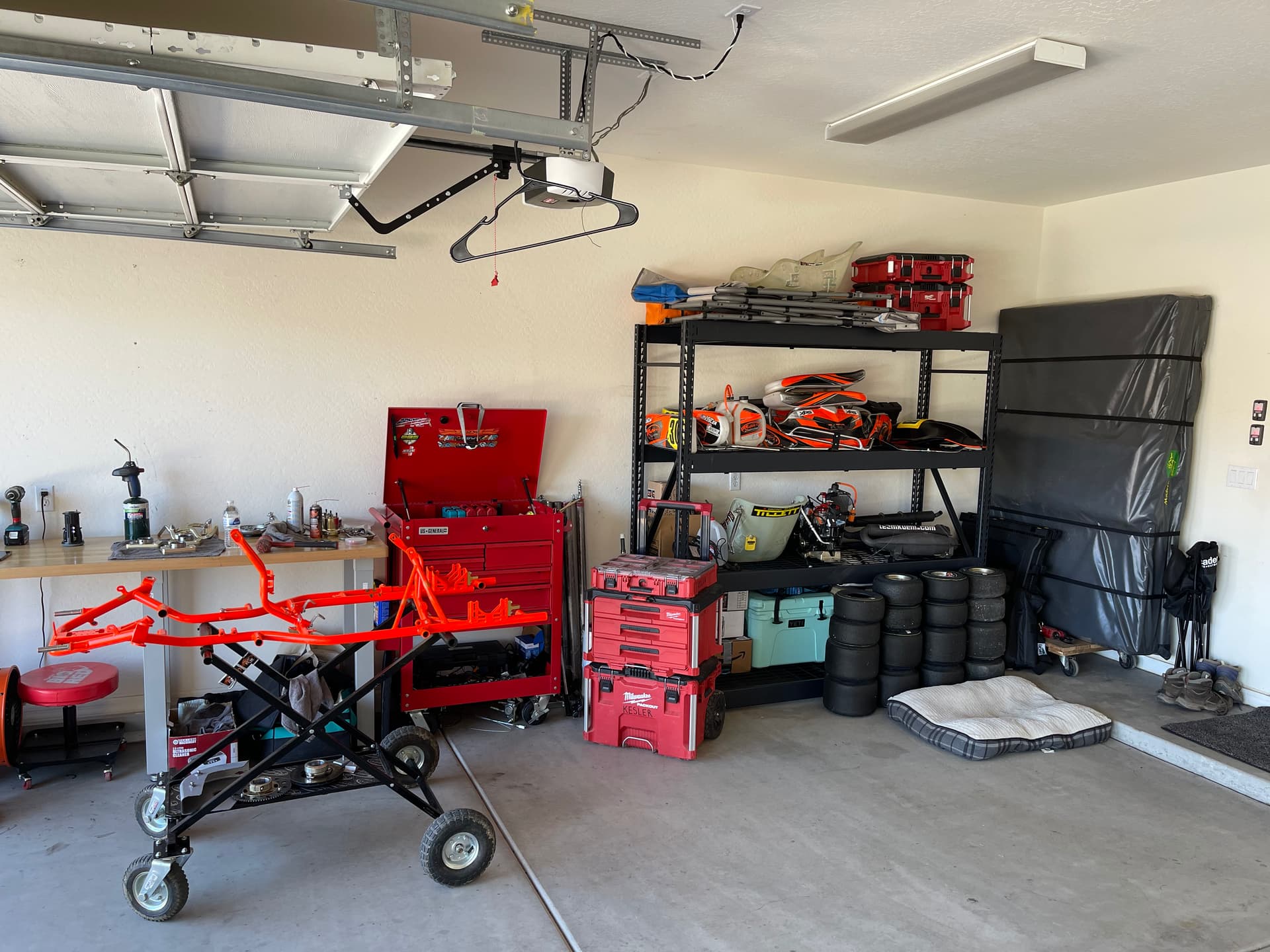

Just working on organizing this garage until I pull the trigger on a full blown setup. Put in a new workbench and shelving system. What a huge difference.

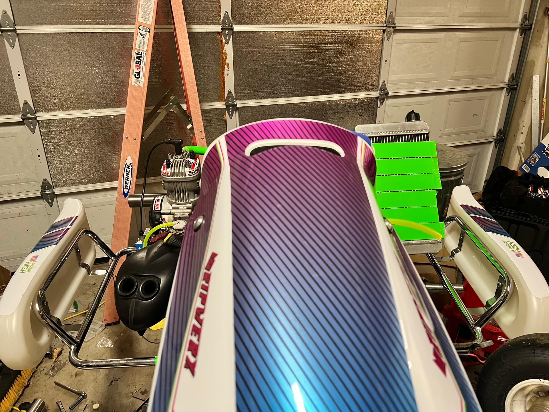

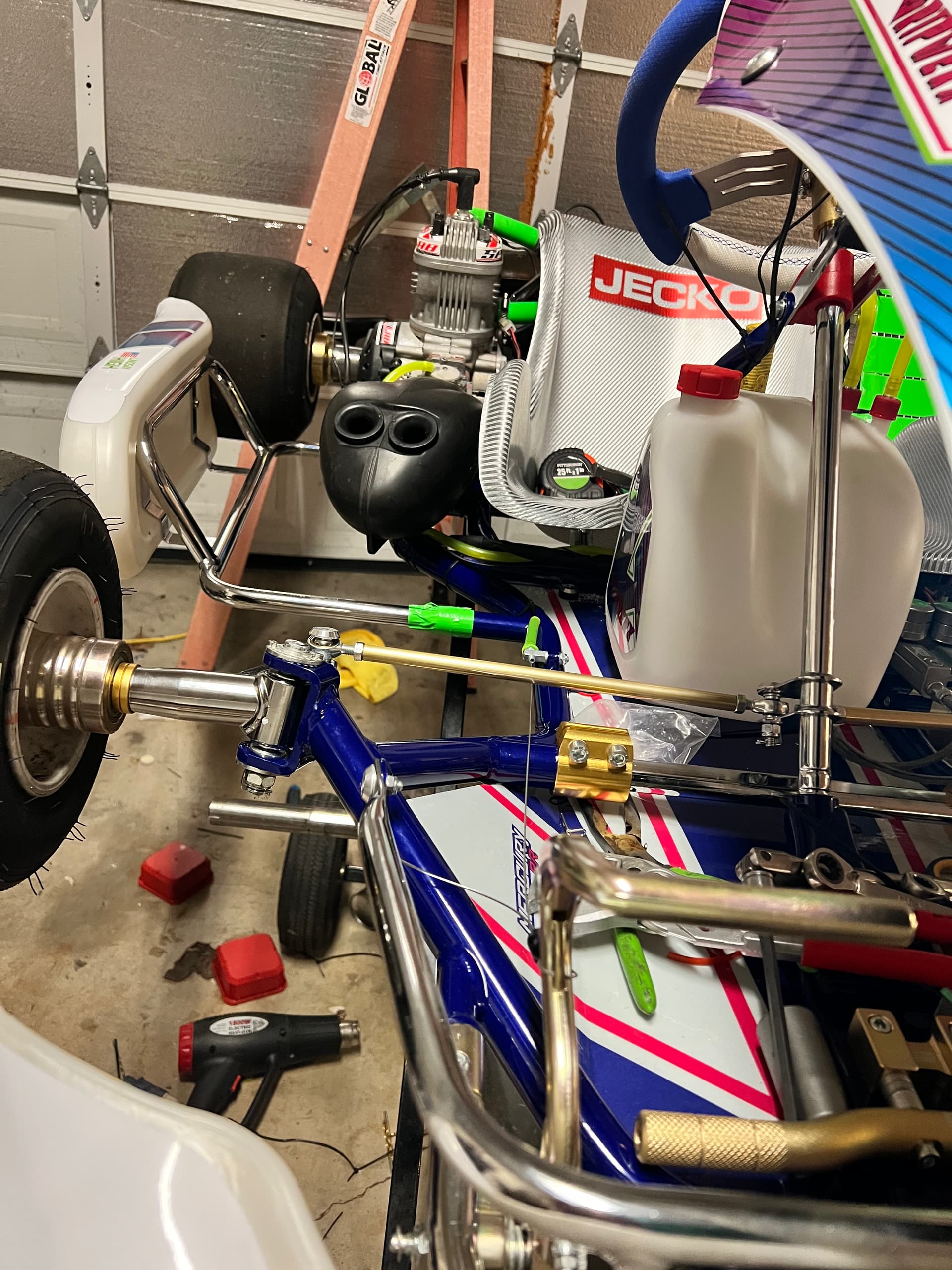

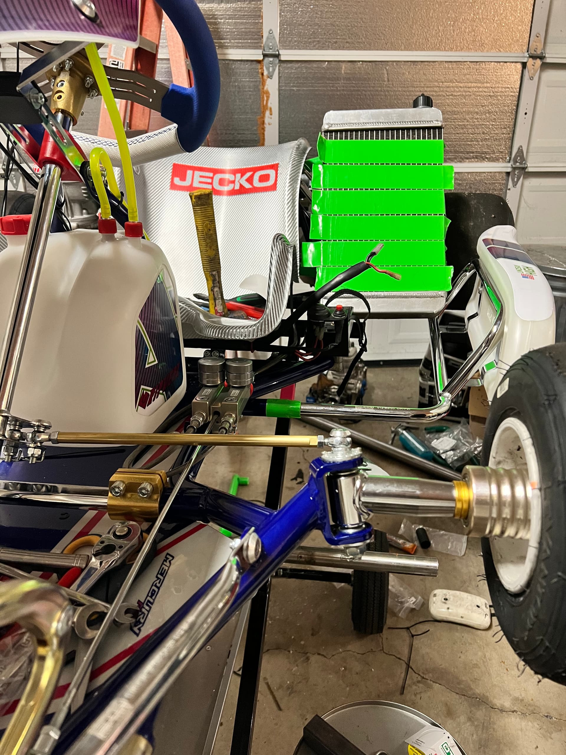

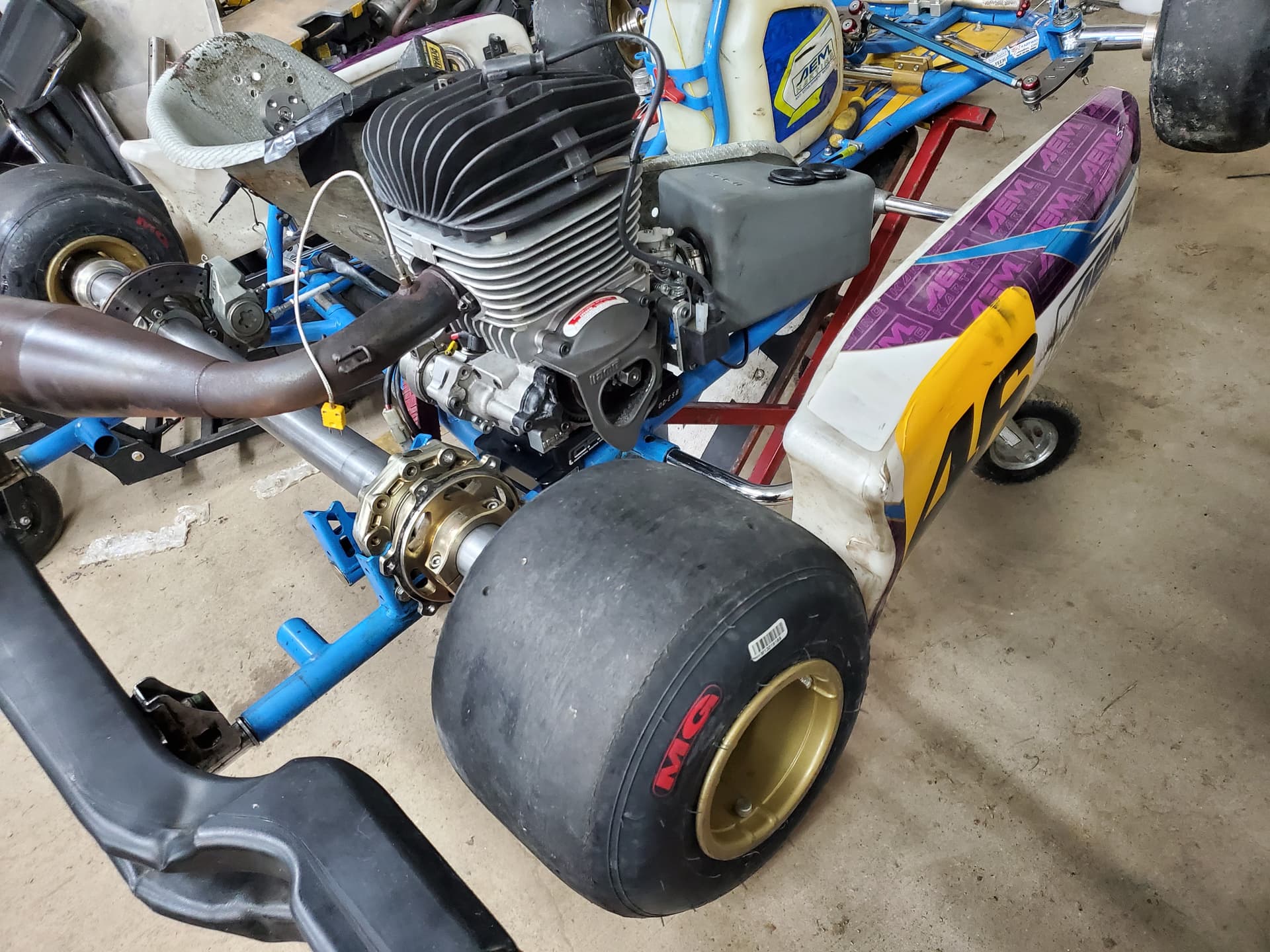

Kart is buttoned up. Need to pick a sprocket and get that and a chain on. But tomorrow we scale. Trying a new seat so want to make sure it’s got proper balance

Woh. Those graphics look cool as from the glimpse I have
What are you using as a reference for mounting the Jecko? Completely different shape to the OTK or Tillet.
