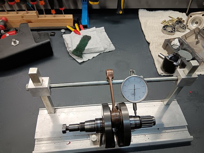

Trueing the crankshaft on our rotax max rebuild engine . The specs says 0.03mm limit for error .
We start at plus 0.05 and we reach 0.02 mm after correction .
It was that moment i knew i had to use my favorite expression i have learned in kartpulse …
" Its 0.02mm now ...  Ok SEND IT !!   "
and as Josh Hanrahan " Aim Sports Tech " said in the documentary become one.
" Its impressive because there is no suspension or anything else but there is So much TOO IT , that you dont see when you just watch them as they are going around on the racetrack . "
