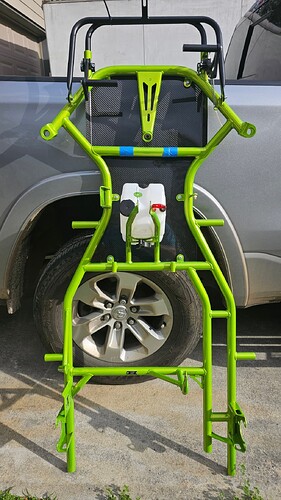

Got the new chassis delivered from the Spring Nats and O.M.G do I love how the color turned out!!
