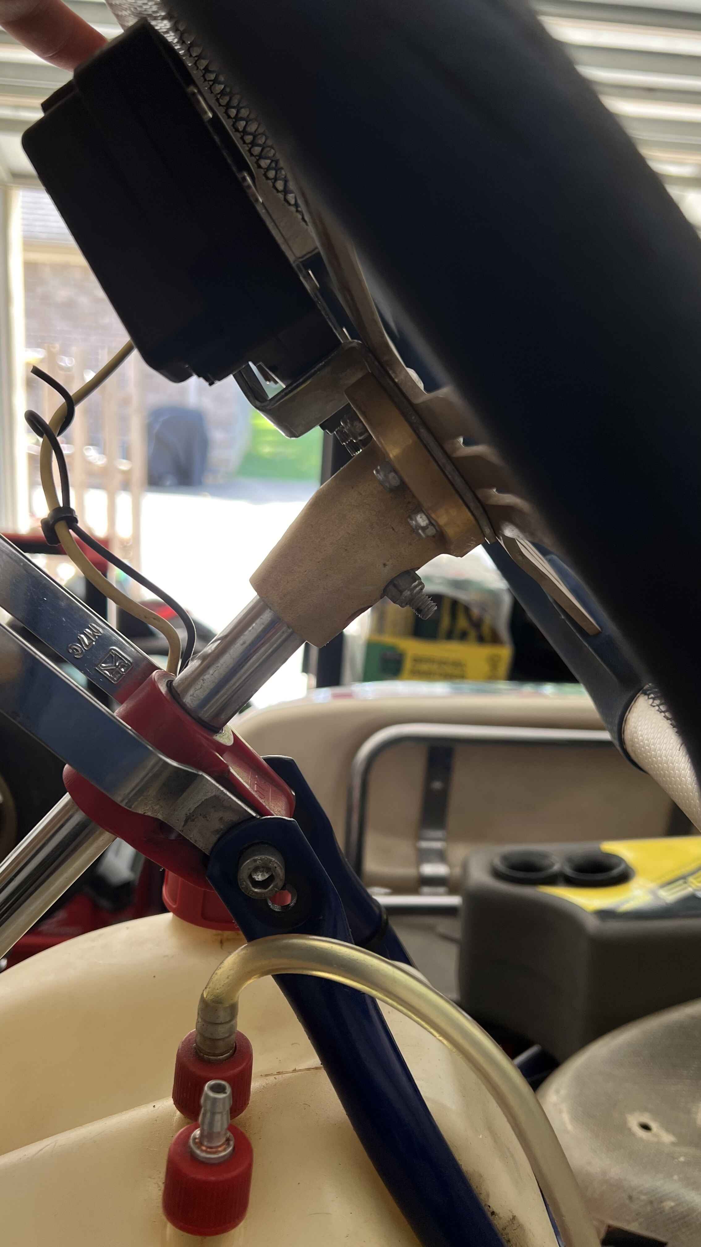

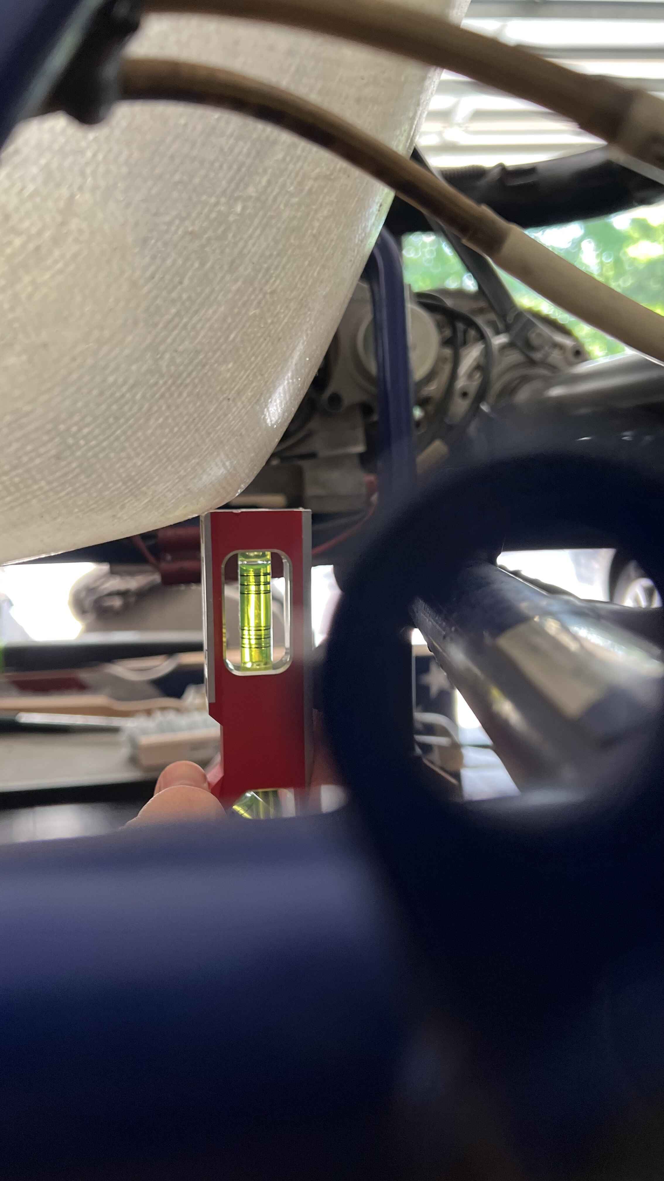

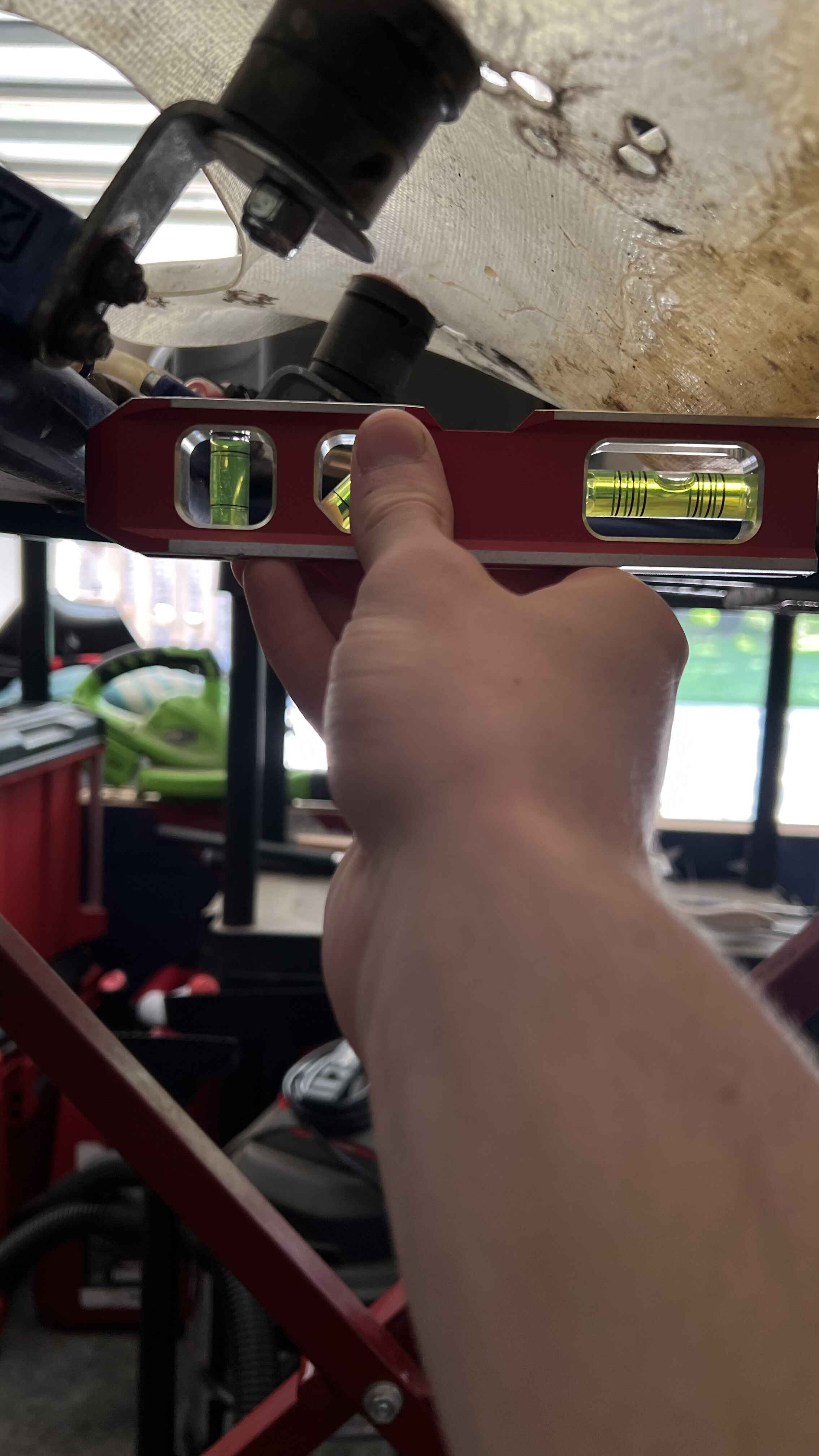

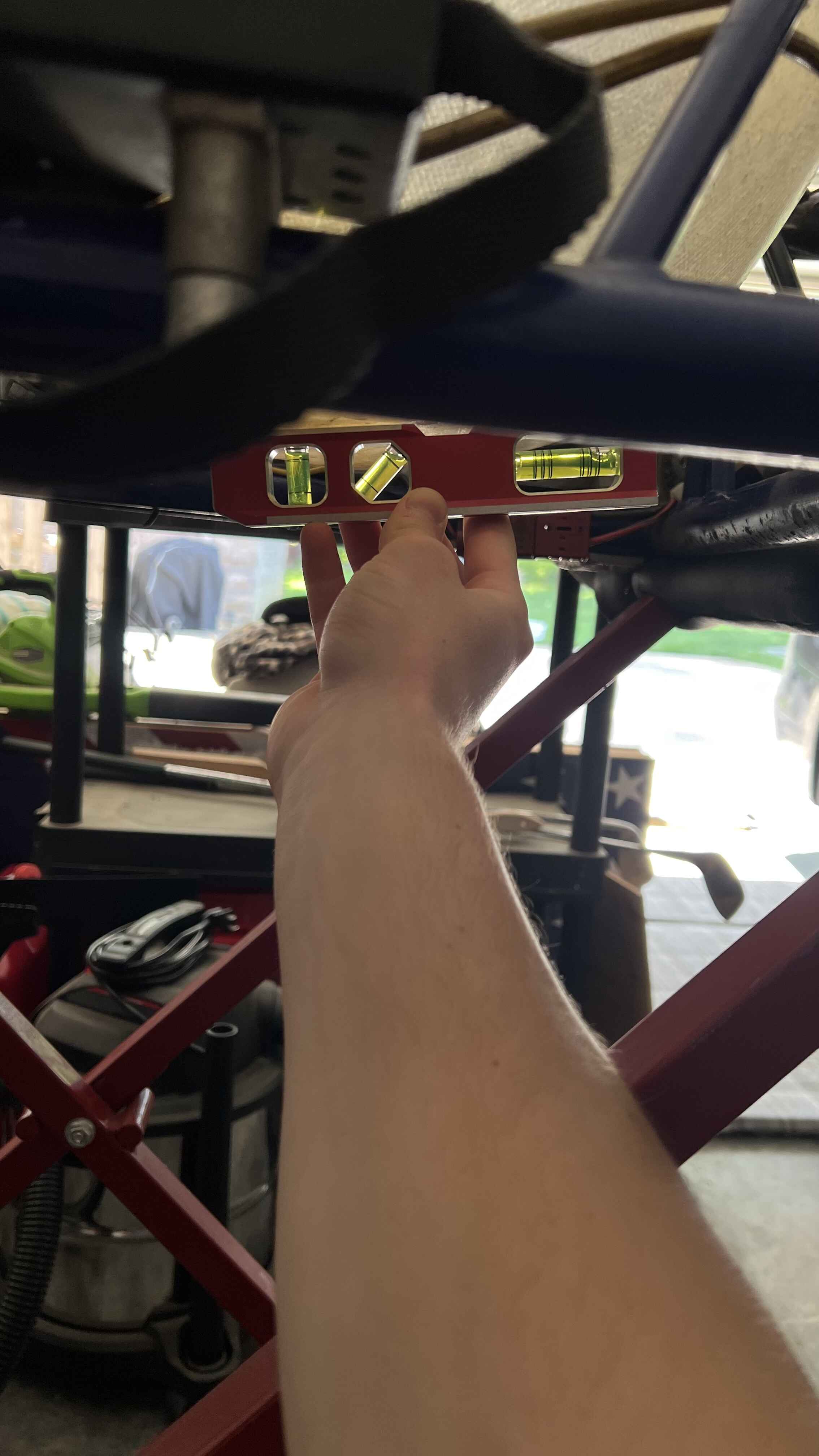

Okay I’ve got the measurements and pictures. It’s even more exaggerated than I thought so bare with me. I’ve got 660mm from left front seat to chassis. 670mm from right front seat to chassis. and 278mm from top of seat to axle.
The front of the bottom of the seat sits level with the top of the frame. and the rear is about an inch above the frame.
And yes my steering wheel has built in angle.
Holy cow on that seat height. If I understand correctly, the front of your seat is about 30mm too high and the rear is about 60mm too high.
For context, the HIGHEST I ever run my seat as a 5’7" driver is like halfway up the frame rails, so still about 15mm lower than your seat at its lowest point.
Bottom should be level and even with the bottom of the frame rails to start. You can go a bit lower if you’re tall, but then you’ll be scraping the seat on curbs.
Keep in mind we adjust in 5-10mm increments when tuning seat placement… Seat position is the fundamental base all of the kart tuning is based off of. I would really sort that out before jumping to any conclusions on your posture or chassis setup.
Yeah let me re adjust it later tonight. I actually did have it below the frame rails for the first year. Just slightly. But I blew the bottom of the seat out and that kind of scarred me. You can actually see in the picture the repair job I did on the seat. But I will put it back even with the rails and sit in it and give some feedback.
Yeah try to have the bottom of the seat flush with the frame rails. I believe that’s where mine is and I don’t rub even on low ride height

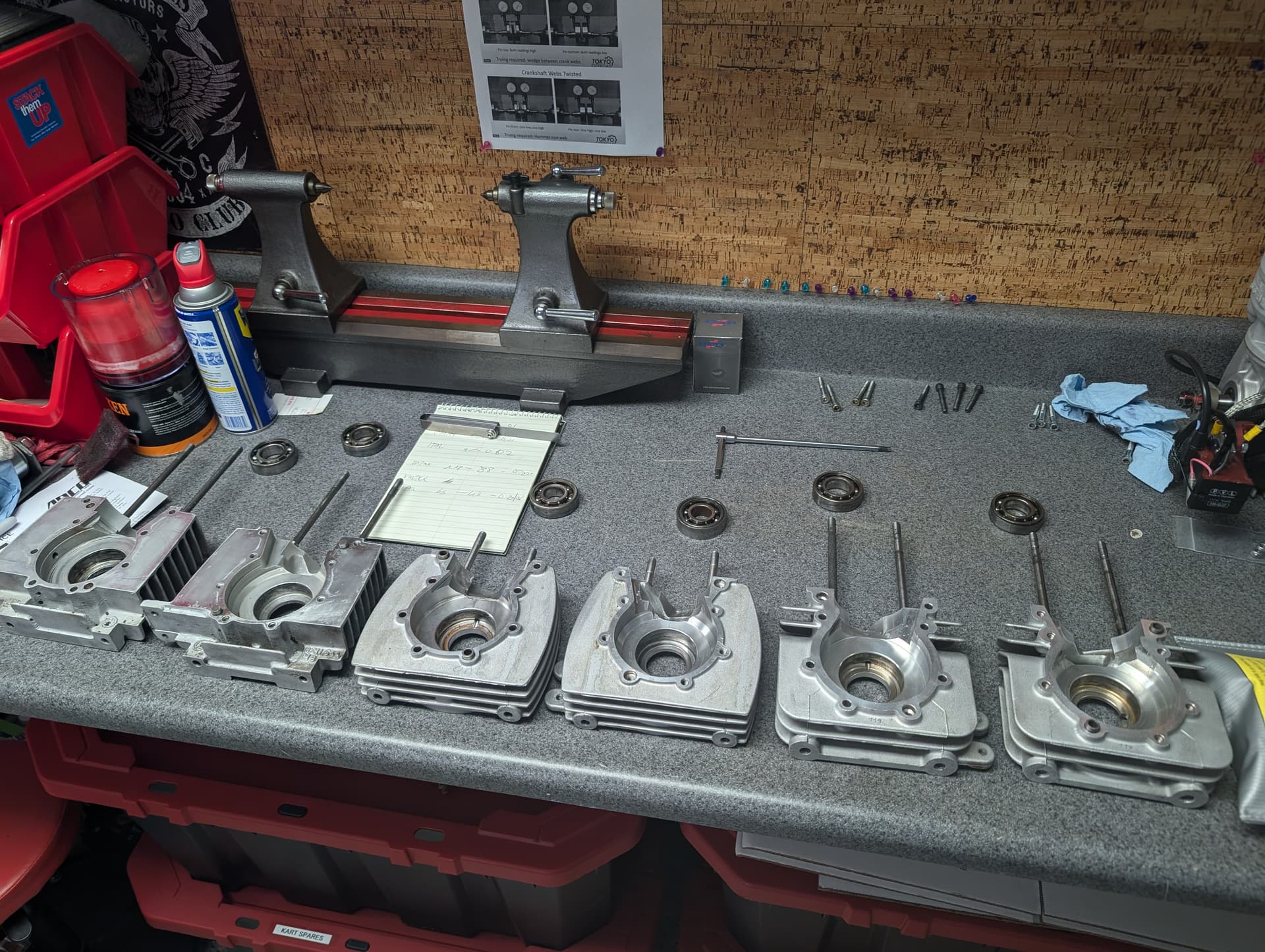

Engine work: assembly line
Andy teach the class how to rebuild a KA🙏🏻
I spy… a rotary case half
