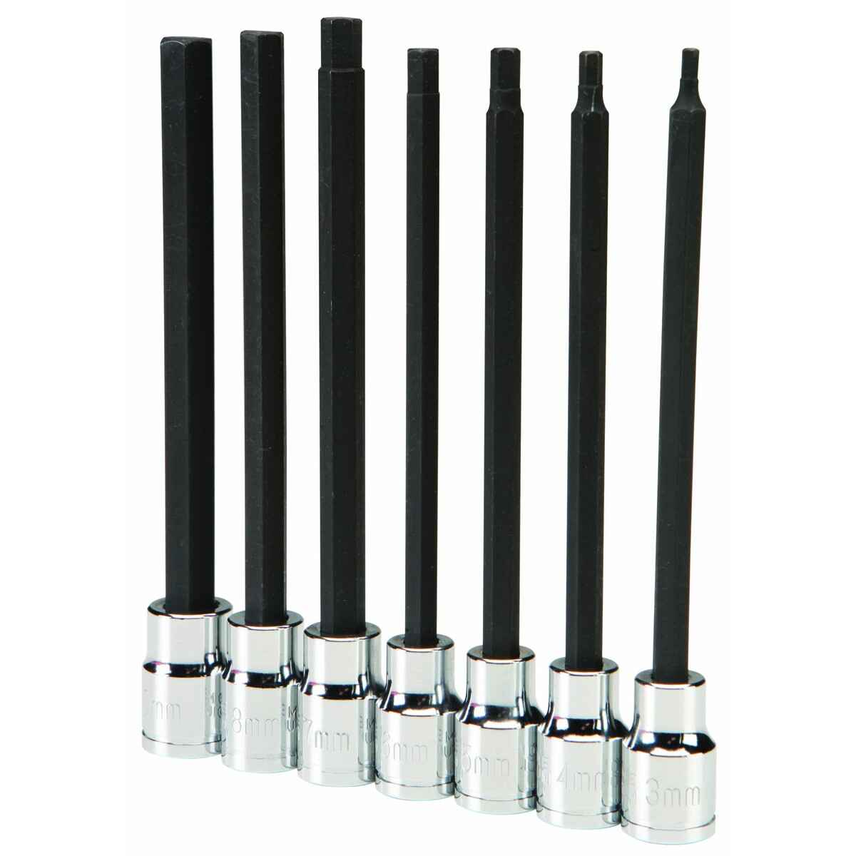

Great list from Tony. Regarding hex socket attachments, harbor freight stocks a long-reach set that I find works very well in situations where the standard hex attachment and extension combo might. Not sure if you have access to these where you’re located, but I would recommend purchasing if you do:

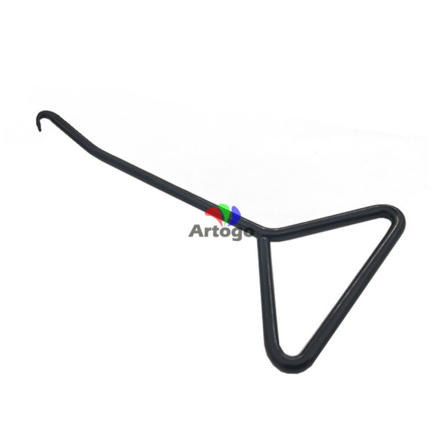

also… one of these spring puller hook thingos is handy… Spring puller hook thingo

But T handle allens. And Socket long reach ball end allens is one of my most used. They can get in almost anywhere.

Picks and hooks are good for exhaust springs and taking apart a carb
