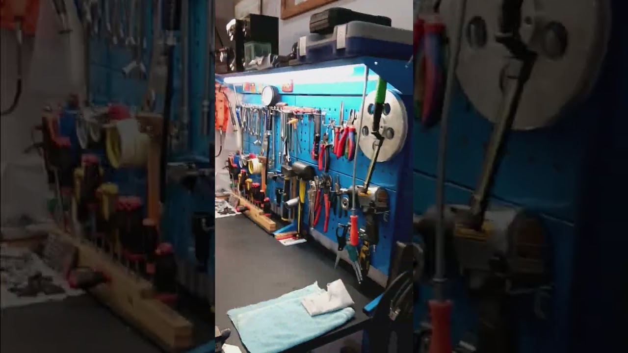

Garage coffe time .
Everything seems ready to go for September’s racetrack seat time
